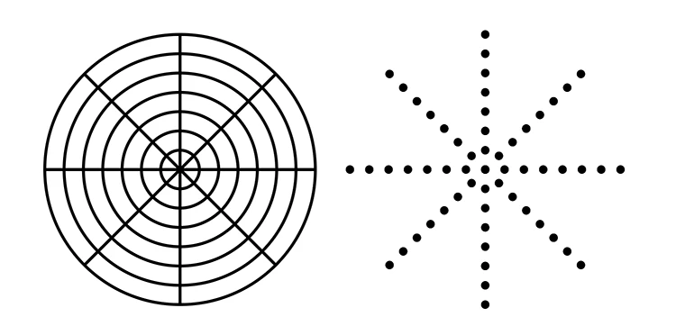

I have a polar grid that is 660 x 660 with 382 radial lines and 43 concentric circles, i would like to create dots or dashes on each intersection but can't figure out how to do that. I would also like some different smaller dots evenly spaced along the radial lines and the concentric circles.
I've tried doing dotted strokes, but cannot get them to space appropriately (2.83465pts apparently measuring 1mm but with rounded dots the measurements won't line up)
I've also tried creating a line of correctly spaced dots, then using the rotate tool, but with so many radial lines and a small amount of rotational degrees (0.942408377), i can't quite get the rotation to be exact. And i have a lot of other precise stuff to put on the polar grid so it definitely needs to be exact.
Each concentric circle is 7.5mm spaced apart.
Hoping someone might be able to help! Thank you 🙂

March 1, 2021
You may try this:
Create your grid (don't fill it). (you may want to keep a copy on another layer and hide it)
Select: Object > Live Paint > Make
Select: Object > Live Paint > Expand
Select: Object > Ungroup (3 times).
Select: Select > Object > Direction Handles
Delete the selection (you will have only single anchor points).
In the Appearance panel choose Effects > Convert to Shape > Ellipse (turn off the preview)
Choose an absolute size and click OK
You may want to turn off the stroke and give it a fill in the Appearance panel.
With your settings, I found some additional dots in the horizontal center and removed them manually.
March 2, 2021
When i get to Object > Direction Handles - i can't see that as an option in the menu, am i misunderstanding?
Really really appreciate your help - thank you!
March 2, 2021
Sorry - found it, under Select menu.
This has worked brilliantly, thank you very much for this solution

March 1, 2021
Is this what you are looking for (with more dividers and rings)?
March 1, 2021
Yes, that's it!
March 1, 2021
How to make that magic happen? Especially on a really heavy polar grid?
