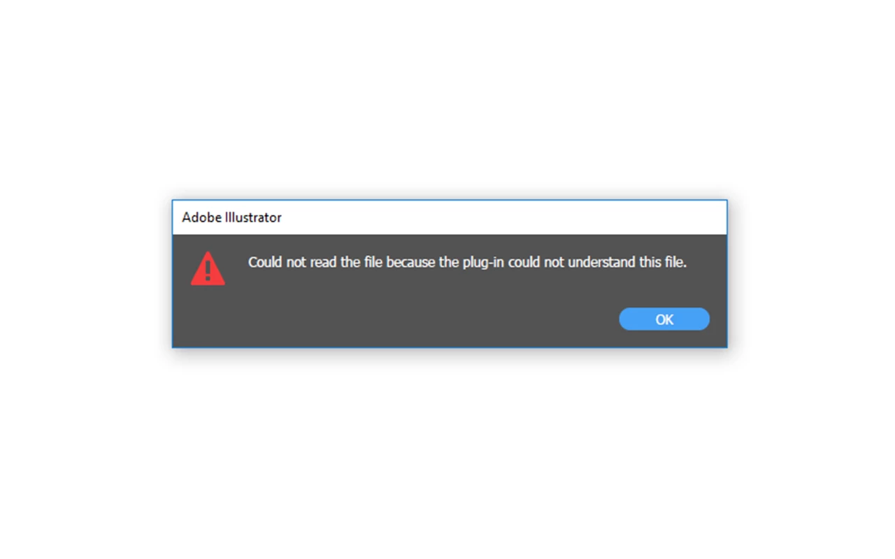

I am getting this error message on dozens of my files. I can't get any of them to open!
"Could not read the file because the plug-in could not understand this file."
I have Illustrator CC 2018 - The files are saved as CS6 with no PDF or attached files embedded. Only 2 linked files.
What can I do to fix my files?
Correct answer Ton Frederiks
You could try to move the file to a different folder to break the link to the linked files.
Or open the linked files in Photoshop and save them as .psd.
Accor ding to this thread it seems to be related to corrupted linked files.
CS4 error message: Could not read the file because the plug-in could not understand the file

Ton Frederiks
Ton FrederiksCommunity ExpertCorrect answer
October 6, 2018
Adobe Employee
April 21, 2020
illustrator versions post 24.1 already have corrupt links handelling.. so upgrading illustraotr can takeaway the pain of to and fro.
