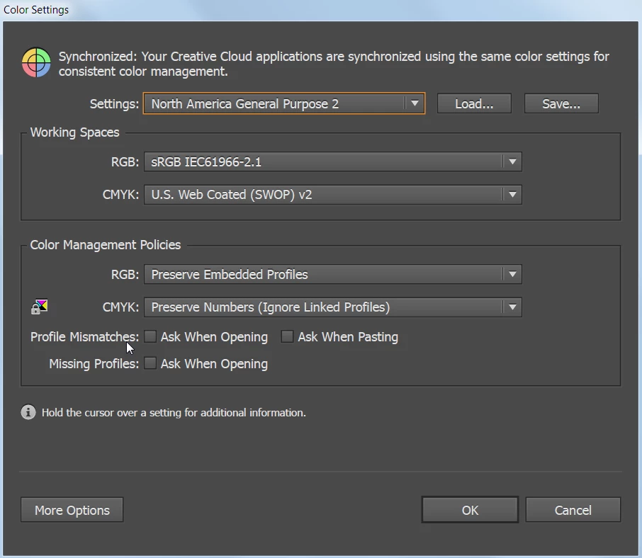

    It is possible that the color settings in Photoshop and Illustrator are using a different working space. Go to Edit > Color Settings in both programs and make sure that the settings are identical. It's a good idea to turn on "Profile Mismatches: Ask when opening" so that you'll be warned if the profiles don't match. At the top of the dialog box, it should say that your applications are synchronized.
    Let us know if this helps.
