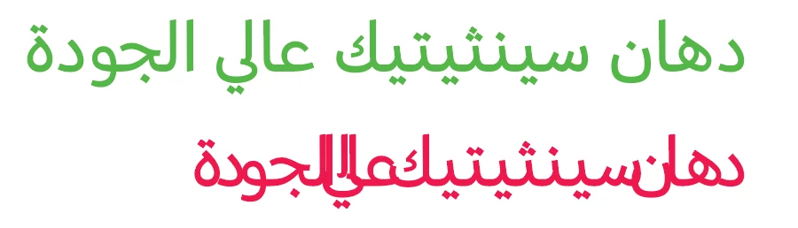

I can see the issue with the Arabic text, the tracking of the text is like in minus (~ –70) hence the words are crumbeling upon each other.
Here in green is what the text should look like, while in red is Tracking: –75 on my Mac using Skolar font from Adobe fonts.
The screenshot in the original post shows results different to mine, so it may not be related to tracking or kerning at all, however I wanted to explain to you how the text should look like in ideal settings (above green text)

What happenes if you substitute the installed font with the version available from Adobe Fonts
I just tried Skolar from Adobe fonts on my Illustrator (Middle Eastern) v.29.5.1 and it look fine.
Note. For best testing method, remove the installed copy from your Mac to be sure you're testing the synced version of the font.
