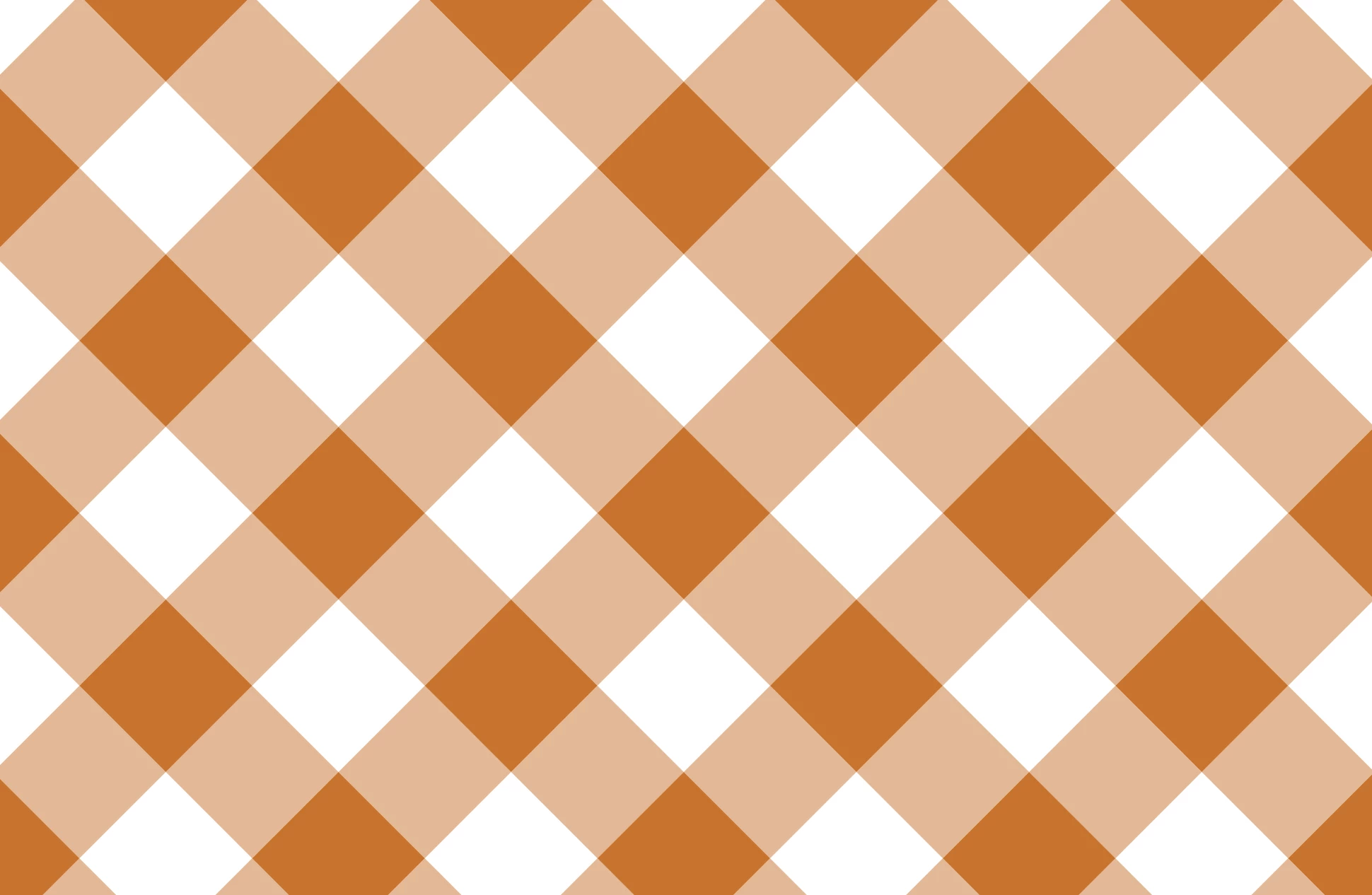

Since you seen very knowledgeable on file formats...can you explain to me why this is happening when I save a file in PDF and try to open it over in Photoshop?
I just did something very basic here to try and mess around with file saving stuff.....the file saves just fine on my desktop as a PDF and looks like thisHowever when I go to open it in PS....part of the transparency is coming through on the lighter colors and I need that not to be there.  Can you tell me why this might be happening?  I'm sure it's somethign I'm doing wrong when I'm saving AS PDF.  Again many thanks!!
That is because you are using transparency.
You will see the transparency grid in Photoshop because you gave those elements a 50% opacity.
If you would create a white layer below it would look like the first picture.
You can avoid this by making the color a Global Swatch and use a 50% tint instead of 50% opacity.
