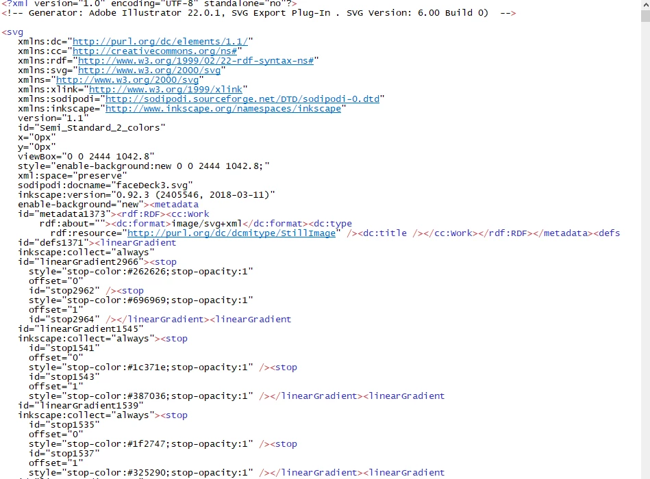

I have a file in SVG format as a part of the software. The beginning of the code says the following:
<?xml version="1.0" encoding="UTF-8" standalone="no"?>
<!-- Generator: Adobe Illustrator 22.0.1, SVG Export Plug-In . SVG Version: 6.00 Build 0) -->
If I try to edit the file using Illustrator 25.0 and save it. I find no option in saving it as SVG Version: 6.00. And if  I save it using one of the suggested by Illustrator SVG plugin formats, the program I prepare this file for just does not read it correctly. And of course the style of the code of the original file and the file I save using the suggested formats differ.

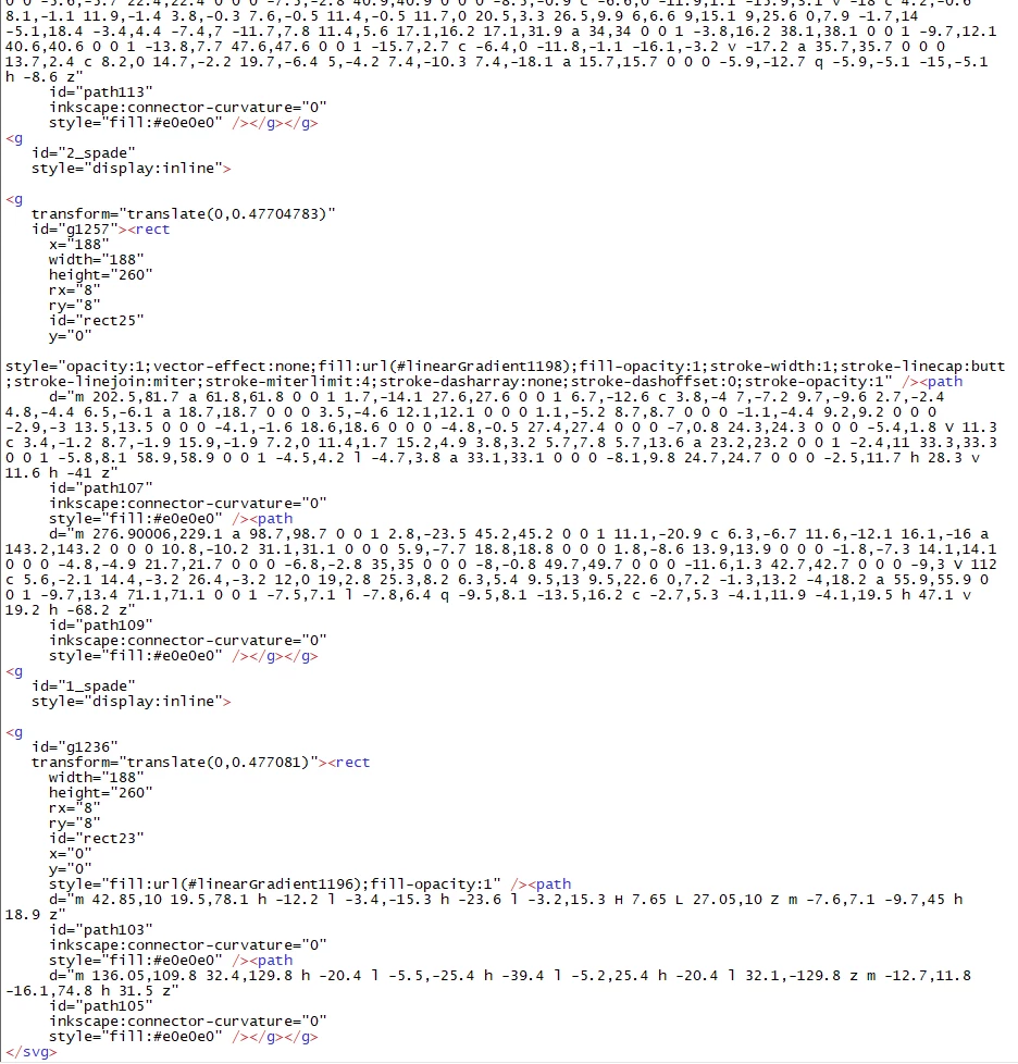

The software I took this file from is a Poker client. The file contains the images of playing cards. I want to change the cards design for my personal convenience. I tried to attach herewith the beginning and the end of the code of the file I try to edit, but each time I do it, my forum message disappeares like I never posted it.
Beginning of the code
End  of the code
