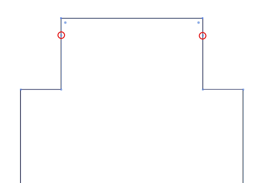

How to add anchor points to paths with js script
Add a new anchor point to the left or right of the selected anchor point, the new anchor point is 30px away from the original anchor point, can it be achieved with jsx? Because I often need to do this.

@Bryce29110882cdze, this most certainly will not work and smells a bit like it was ChaptGPT generated (same as your other posts here and here). The Illustrator API doesn't allow you to access anchor points like `sel.anchor[0]`, and using `sel.pathPoints.add()` appends a point to the end of the path, it doesn't insert it along the path as I mentioned above. You must recreate the original path with the new point as @femkeblanco does in his code.
femkeblanco
April 22, 2023
This is a quick attempt intended for non-curved lines. To Use: (1) select one point (with the white arrow tool); (2) to add a point after, use a positive number; to add a point before, use a negative number. (The script will fail if you try to add before the first point or after the last point.)

Dodo BirdAuthor
May 4, 2023
After running the code, the last node is broken
femkeblanco
May 4, 2023
This was written with an open path in mind. I'll amend it later to accommodate closed paths.
jduncan
April 22, 2023
Yes, it's possible. The only catch is that if you want to add a point between already existing points on the path you essentially have to recreate the path via your script up until the new point. If you just append a point to your path like described in the API docs (see here), it will be added to the end of the path.
Below is some EXPERIMENTAL code I was playing with a while back for splicing paths. PLEASE NOTE, if your path has any curves you would need to calculate updated handle points (left/right direction) which is doable using an algorithm like De Casteljau's algorithm.
Hopefully, you can get what you need from this. Cheers!
