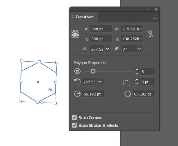

Ares Hovhannesyan
August 31, 2023
Did you try to change poligon property in property panels?
Roger Breton
Brainiac
August 31, 2023
Yes, that's trivial but the Properties panel does not offer any way to convert a "circle" into a "polygon"? See? Thanks for offering your help 🙂
