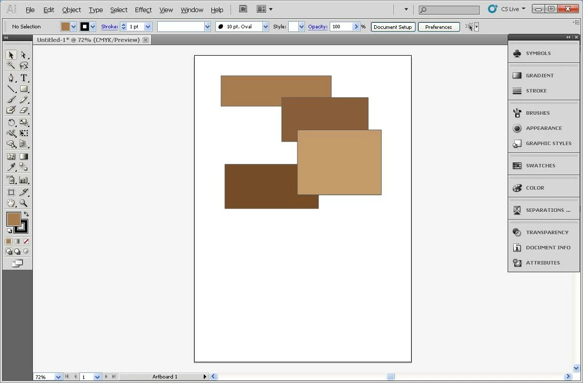

Actually What I want to do is that there is my original document containing some arts or objects like as follows:

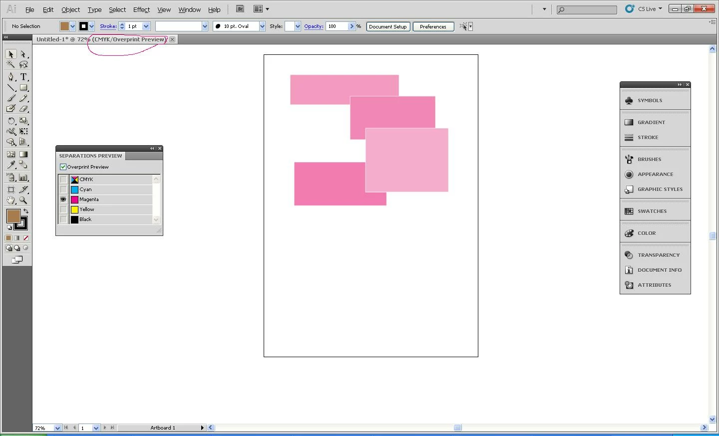

Currently doc is set to CMYK/Preview. Now I clicked the menu item Window>Separations Preview where i checked the Overprint preview, this will set my document CMYK/Overprint Preview and I unchecked Cyan, Yellow and Black from separation preview dialog which gave me result like this :
I am trying to export the above overprint preview but every time I got the original one.
I am using AIRasterize suite to get the current state of the document and export it but didnt find any luck. I am also trying to do it on illustrator but I am not able to do i.
So I am just curious can it be doable or not?
