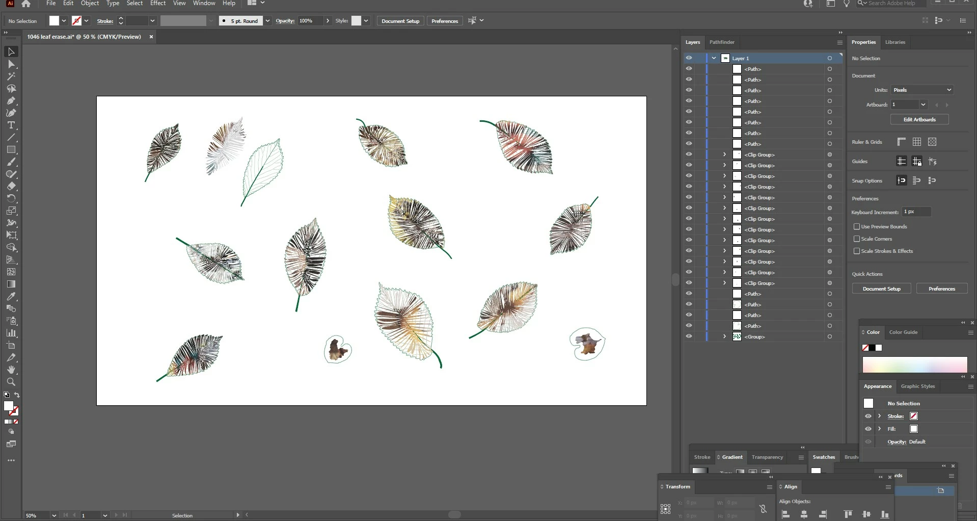

Hi I've got these huge files and I can't seem to flatten them or merge.
They contain photgraphic images in the middle of leaves.  File size 1,000,00kb plus much more when I play with grain.
My goal is to use each image (only one artboard per saved file)as frames in After Effects but are so big After Effects breaksdown.
Also It seems like I have many layers hidden when I release to layers sequence.
I began working by having a layer for the 'filler' for each leaf. Now its just big.
please help

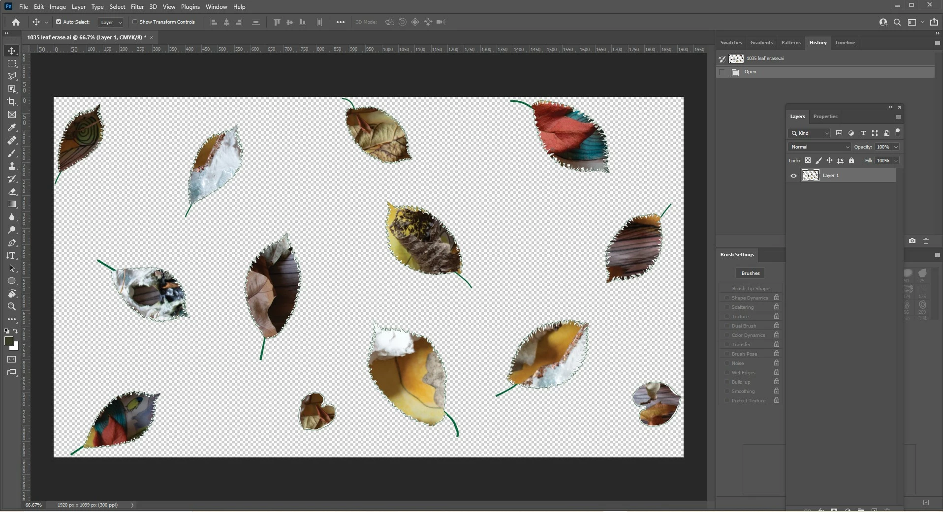

I also tried opening in PShop and decrease size of the work which worked very well but the pixel dimensions were different in a constrained resizing 1920 :1099?. When I did this resize size the layout also changed  - the shapes were further in from the edges rather than the whole work coming down in size evenly.  A quick fix but brings up this new hurdle.

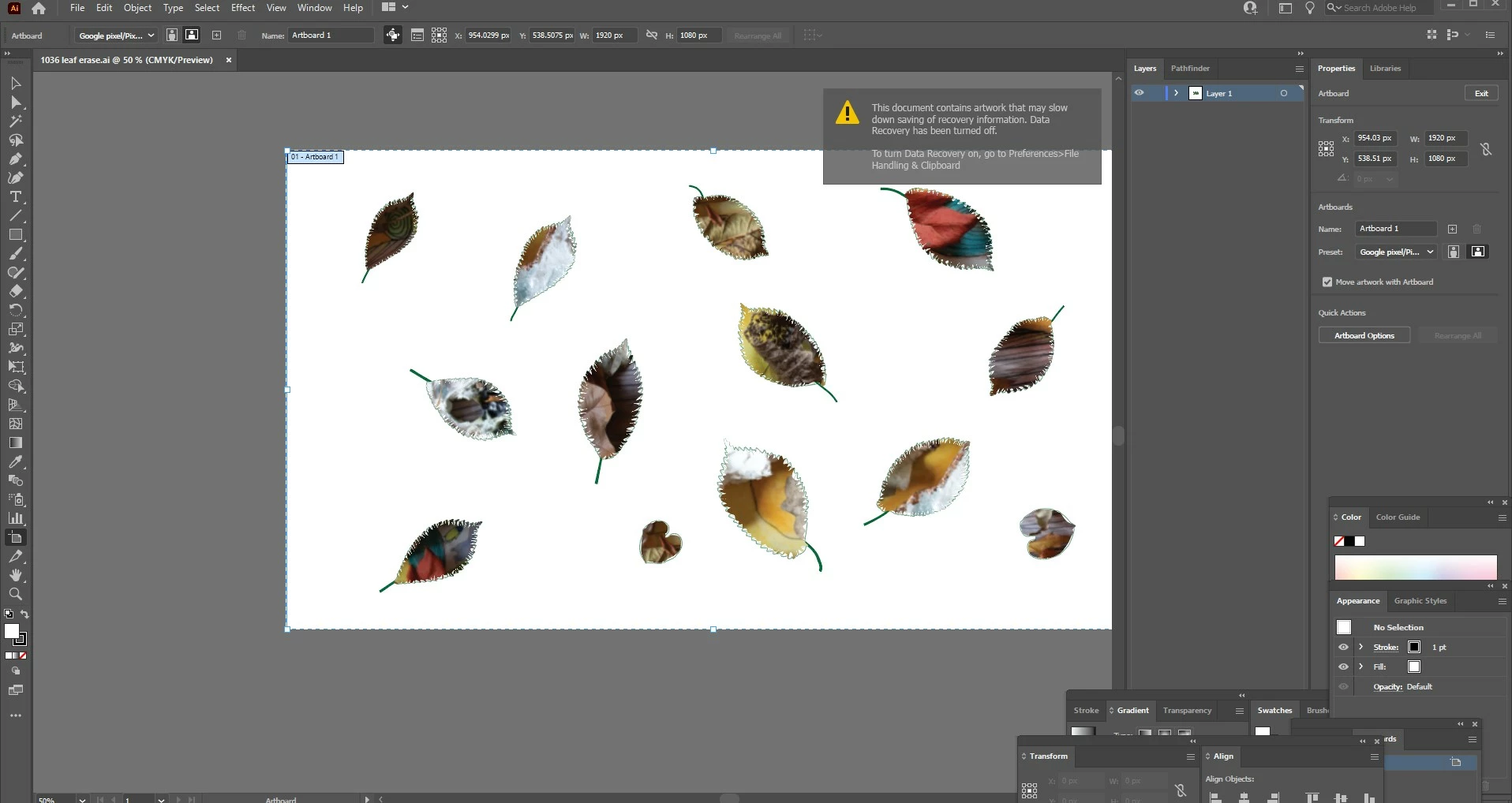

Also error message for files (1st image)??
Illustrator Pixels 1920 x 1080 (2nd image)
Photoshop image 1920 x 1099 (3rd image)

In addition to the advice given already, not only big screens but also high resolution screens will undoubtedly require a higher size than 1920 x 1080.
Apart from that I can see you have non integer X and Y values for the artwork, and undoubtedly also for your Artboard, and I can see that the PS image states 300PPI.
