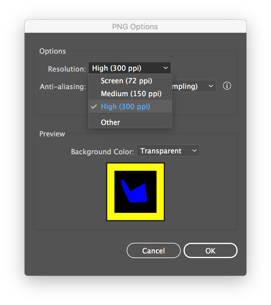

Hello and first off thanks to anyone who can help with my current issue. The problem that I'm having is when I go to export my document to PNG at 300ppi, instead it exports at 72ppi. I've tested the same process with export to JPG and it works as expected. How can I fix this issue? Thank you in advance for your time.

Please update to version 22.0.1 to get the fix for this issue.

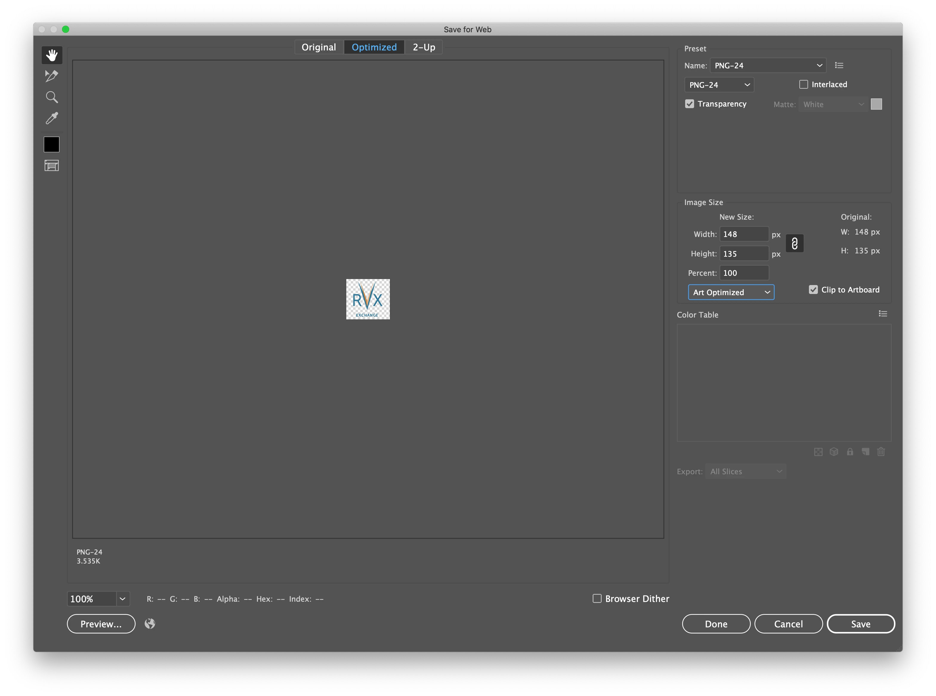

I have the same issue and frustrated. I have a logo I created in AI. After reading this trail I upgraded again to AI 24.01. My clean logo in AI is nice. But when I "Export for screens" or Export "Save for web" it looks blurry.
Small logo (upper left) on our website looks crappy. https://www.reversevision.com/
Ton Frederiks
December 12, 2019
Did you check Art Optimized for anti-aliasing?
December 12, 2019
Here are my settings.

October 25, 2017
Apparently this is a known bug in CC 2018. Export for screens is the best workaround.

What version of Illustrator and what operating system are you currently using?
What is the size of the artboard you are exporting? It could be that the results are just resampled - 72ppi but a huge w&h dimension.
ReubenGAuthor
October 25, 2017
Specs are below
Illustrator CC 2018 Ver 22.0.0
OS X El Capitan Ver 10.11.6
Artboard size: 11'W x 6.63"H
ReubenGAuthor
October 25, 2017
Thank you for your help . I was able to export the file at the correct size via Export for Screens, but it's a little lengthier than just a straight forward export. Not sure if this is a bug or not.
