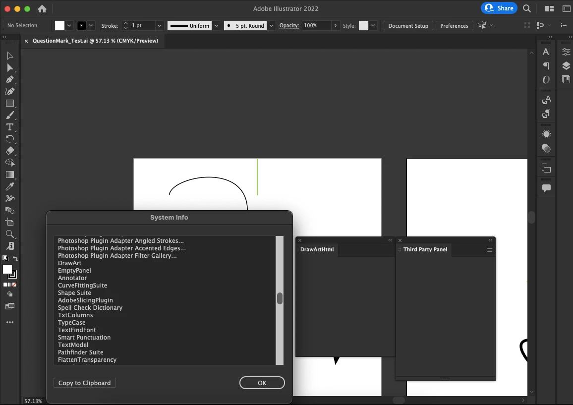

I am running the examples shipped with Adobe Illustrator SDK (build 730) and can get them to compile and run. However, when I open the panels, they are empty:
Any ideas what might be the problem?
I am using two exaples - the EmptyPanel example (with a programmatic GUI) and the DrawArt example (with a CEP GUI that I am copying to the location `~/Library/Application Support/Adobe/CEP/extensions/`. The problem is in both of them.
Thanks
Correct answer Matúš — LTTR
Problem solved.
I had to enable CEP debug mode to run unsigned extensions:
defaults write com.adobe.CSXS.11 PlayerDebugMode 1
