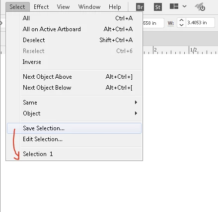

    ryan_edwards
    September 10, 2018
    You can save the selection(s)... and easily access them later at the bottom of the 'Select' menu... you can 'edit selection'... if you wish to change later
    ....another would be to add a 'note' to the layers you want and possibly run a script that looks for a particular naote
    gmaleticAuthor
    September 10, 2018
    Saving a selection is a useful technique, but not a superb solution in my case. I don't know ahead of time all of the different kinds of selections I want to perform. And even if I did, it's still cumbersome to, say, select all elements of a certain color, deselect the items that aren't on the current artboard, then save it. Not to mention, if I add new objects, my saved selections become useless.
    ryan_edwards
    September 10, 2018
    Setting files up like this can be a pain, but it saves in the long run.
    I know sometimes there just isn't time for it though... a faster way, quick & dirty... is just loosely group content in your document... when you 'double click' isolation mode will drill down to encompass the whole group... so if you have 3 objects or 333 objects its a nice way to dynamically zip around... and you can still get granular an isolate a single shape/object if you still need.
    gmaletic  wrote
    ....still cumbersome to, say, select all elements of a certain color, deselect the items that aren't on the current artboard, then save it. Not to mention, if I add new objects, my saved selections become useless.
    If you save selections and then add some more stuff to your file... I would just run that old selection that is saved... that's going to get all the old stuff... now shift+click the new stuff... save a new section named something similar...v2.  No need to make selections from scratch every time you add something... hope that helps out.
