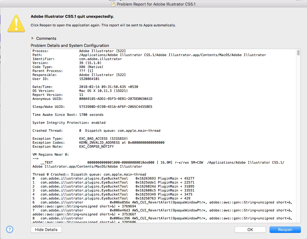

    Actully i am not geting to post my problem I am a new user of adobe community so i want help..
    Firstly A lots of thanks to all and  I have a problem that when I copy gradeint property with eye dropper tool illustrator enexpectedly closed and please any one can resolve the problem... and can guide to me how to post my problems proper way.

    Please create a new thread on the user forum for your problem. This thread is about a different version AND a different issue. Please refer to this: Getting Started on the Adobe Forums
