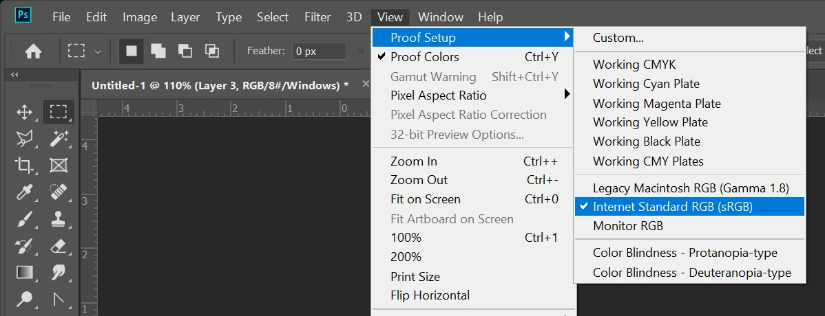

FIXED: VIEW - PROOF SETUP - INTERNET STANDART RGB (sRGB)

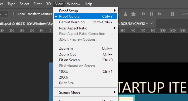

In Photoshop 2018 this toggles the Proof Colors option. To untoggle the options, go to the View Menu in the top toolbar and click Proof Colors to uncheck it if it's already checked.
But this is the Illustrator forum.
