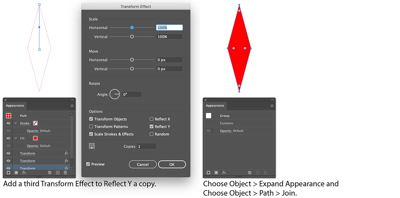

Ton Frederiks
January 17, 2021
And another one.
Using the Appearance panel you can setup a Graphic style that can be applied later, you can then change the angle and the length of the line. I used a line with a fill and no stroke to avoid ending up with a diamond shape with 8 anchor points.
