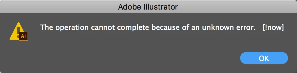

    November 2, 2017
    Running 10.12.3
    Adobe CC 2018 had another update this morning. Ran the update and now Illustrator won't launch. Uninstalled and re-installed, with new preferences, and still no go.
