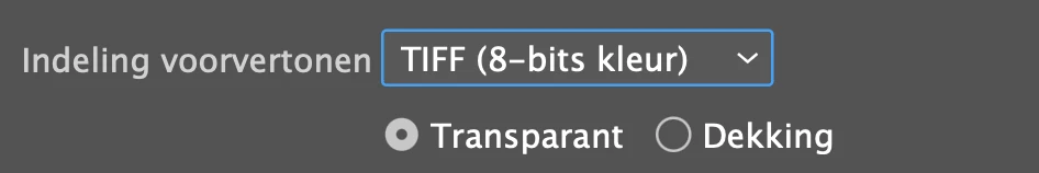

Every time I safe an Illustrator file with several pages, I get a warning saying "Maximale aantal knippaden bereikt voor TIFF-voorvertoning", in English that would be someting like "Maximum number of cutting paths reached for TIFF-preview". Dies anyone know what it means and how to prevent it or what I should do? There is no "Don't show again option".

Knippaden = clipping paths.
Do you use a lot of clipping paths in your document?
As it says it is used in building the preview. How do you save your files?

As far as I know, I use zero clipping paths.
But I do safe EPS with TIFF-preview and when I switch that off, it seems to solve the problem!!!
