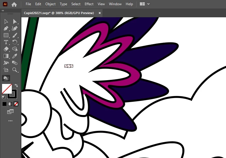

Unable to fill design with color entirely due to anchor point issues.
  • November 14, 2022
  • 5 replies
  • 2370 views
I am new to illustrator and not proficient yet with creating the many layers for the different pieces of artwork used for filling in with color. I have a few but a professional or expert would have probably made more layers. The issue at hand is that when I attempt to fill a piece of the artwork in with color, it only colors along the section of a path and anchor point instead of the whole piece. How I traced my artwork is by making many anchor points and many are not continuous and I am almost certain that's the issue.. Any tips would be appreciated. If you can help, I can send the actual file.

I somewhat figured out the live paint feature but I hit a road block. I know that the paths are supposed to be closed but what happens if that's not how I want my design to look? If you look at the pictures of the wing, the part that's pink- how did the color just stop midway? How can I fix this issue without changing my picture?
please note-
the 3 boxes still have dashes even when I select the black outline box.

Doug A Roberts
November 14, 2022
A fundamental aspect of filling objects in Illustrator is that open paths will fill up to a line between the two endpoints. So you might fill a path and it end up like this, for instance:
A coloured image may be created by layering closed objects on top of each other (or abutting), or more intuitively (for some users) by drawing linework and then creating fills from it using the live paint bucket (K).
If I'm barking up the wrong tree, please share screenshots with selected objects demonstrating the issue.
CheeseHead05
November 14, 2022
That is a perfect example and my situation. Instead of the whole square being colored, it's colored like that.
Larry G. Schneider
November 14, 2022
In order to fill any path it must be a closed path. You are correct in thinking it must be completely connected. You can use the Direct Select tool and Shift key to collect all the paths which are used to define your fill area and use Cmd(Ctrl)-J to join them.
