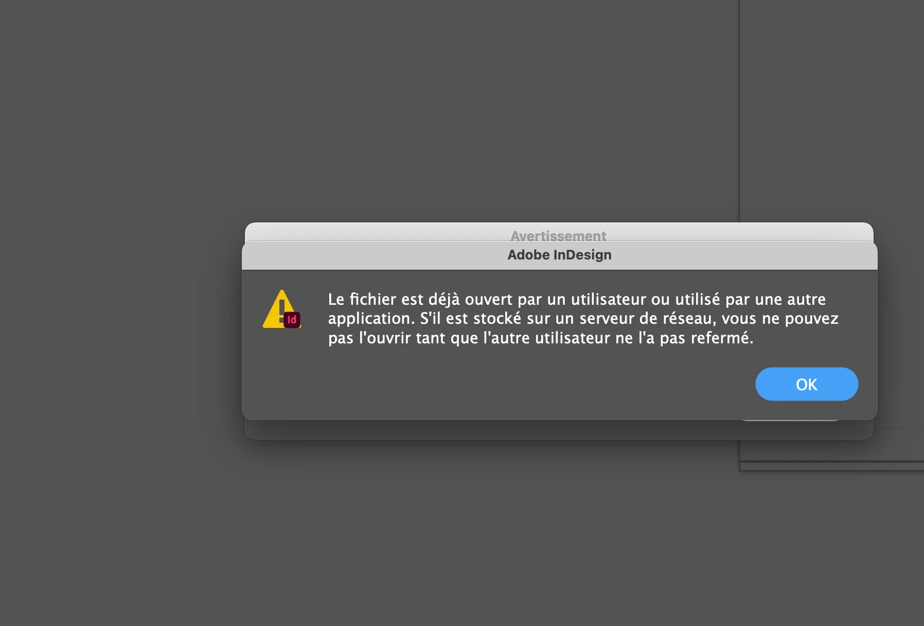

Alert is shown on opening documents in InDesign 19.4. - This file is already open by another
Bonjour j'arrive plus à ouvrir certain fichiers Indesign depuis que j'ai installé Sonoma sur mon MacBook. Quand j'ouvre des indesign avec lien bibliothèque j'ai un message du type : ": le fichier est deja ouvert par un utilisateur ou utilis& par un autre..." alors que c'est un Indesign fait par moi et non partagé (j'ai juste des liaison bibliothèque)

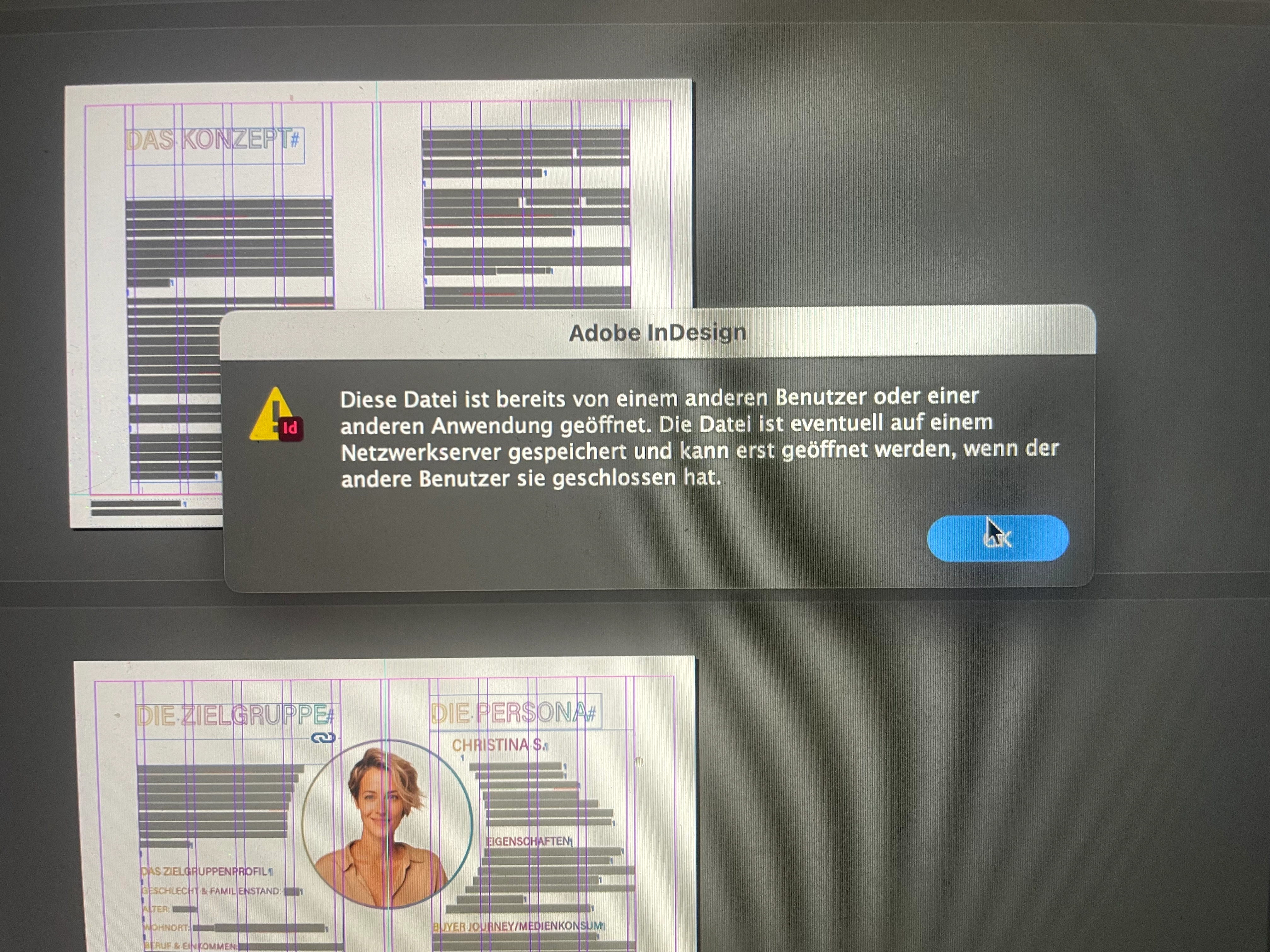

how  could this version come to releae. i takes me hours to find the reason!
networkstorage checke, rights check, adobe indesing setting reset and reconfiguration....
July 1, 2024
but the strange think is, not all files are affected!

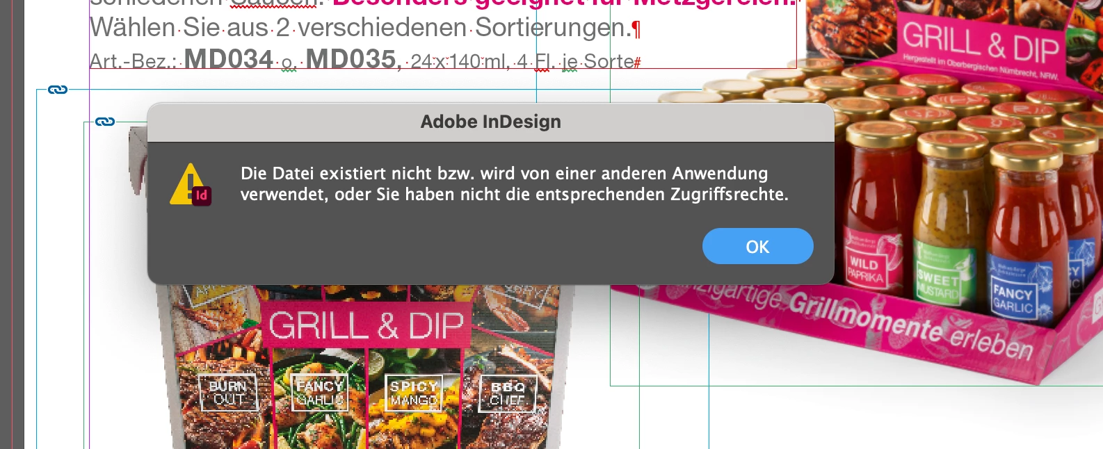

Unfortunately, while your post can be translated by the system here (which does a very good job) the image of the error message cannot. There are some German speaking users here who can likely help, though.
An image translation shows this to be a fairly common problem, but you will need to specify what platform you are using, which OS and what version of InDesign. It is usually related to network permission issues (most commonly on Mac), but may be as simple as a leftover lock file (*.idlk) that was not deleted when the file was last closed.
May 27, 2024
thank you very much for your quick message.. the error message says" that the file can't be used bescause another user or application has opend it" ...and i am working with adobe illustrator latest version (mac os 14.5) ..

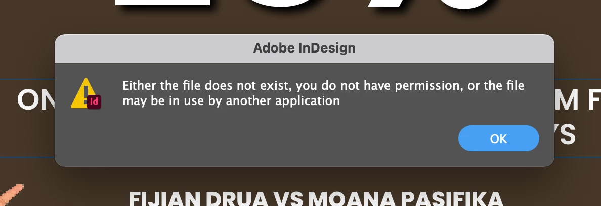

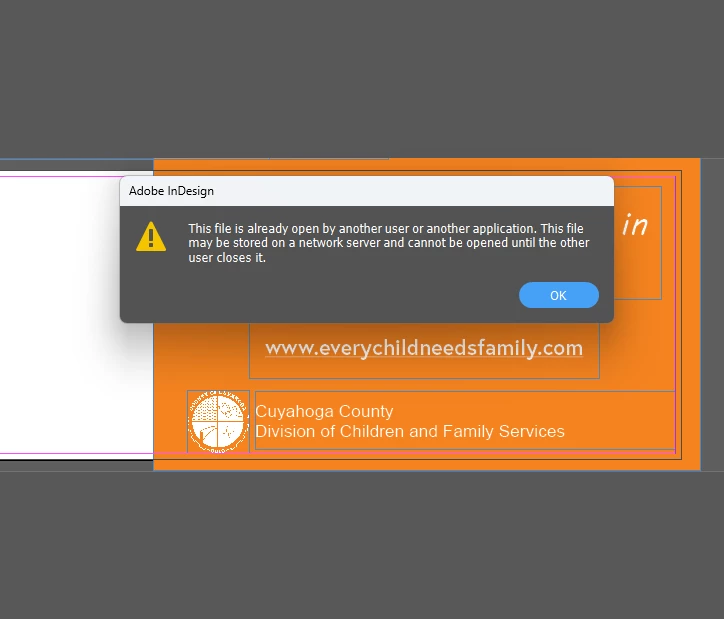

Our organization recently renewed our Adobe CC account and for what ever reason (they got it from a different vendor or they didn't renew before the old one expired) they had to create new profiles for us.  Ever since then when I try open an InDesign file I get the popup below.  I've tried signing out of Adobe CC and back in, uninstalling InDesign and reinstalling it, restarting my pc, etc.  From some research it might be related to the fact that we use SharePoint and OneDrive (I work for the State of Ohio) and the software thinks other people on the network can access my files (they can't).  We've been on Sharepoint for at least 4 years and I never had this problem, so I don't think that is it.   It doesn't appear to happen with any other apps, just InDesign.  Thanks in advance for your help.
Robert at ID-Tasker
May 24, 2024
May 31, 2024
Ended up on the phone with Adobe support and it turns out that InDesign v. 19.4 has a bug that causes the issue.  We rolled my version back to 19.3 and it fixed the problem. Supposedly the bug will be fixed in version 19.5.

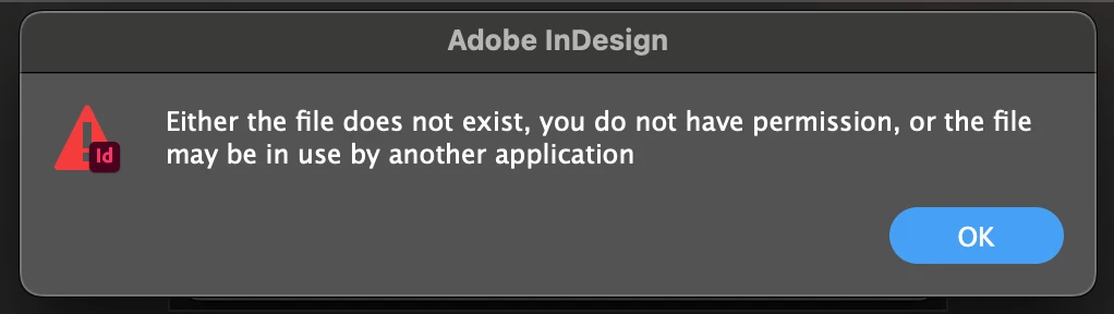

I am writing a book and when I went to reopen it, I get a error message saying that I may not have permission to open it (never locked it or whatever) or it is already open which it isn't. Any ideas on what is going on? Thank you.

May 19, 2024

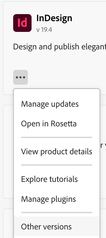

If you're using InDesign 19.4, then try to revert to 19.3:
Adobe acknowledged the issue in 19.4 that sounds like the one you describe:
https://community.adobe.com/t5/indesign-discussions/this-file-is-already-open-by-another-user-i-am-the-only-user/td-p/10941093
BobLevine
BobLevineCommunity ExpertCorrect answer
May 17, 2024
I believe this is a known issue with 19.4. Adobe is aware of it but you should roll back to 19.3 in the meantime.
Han Maximus
May 17, 2024
Thank you !! j'ai placé la version 19.3 et ça remarche. 🙂

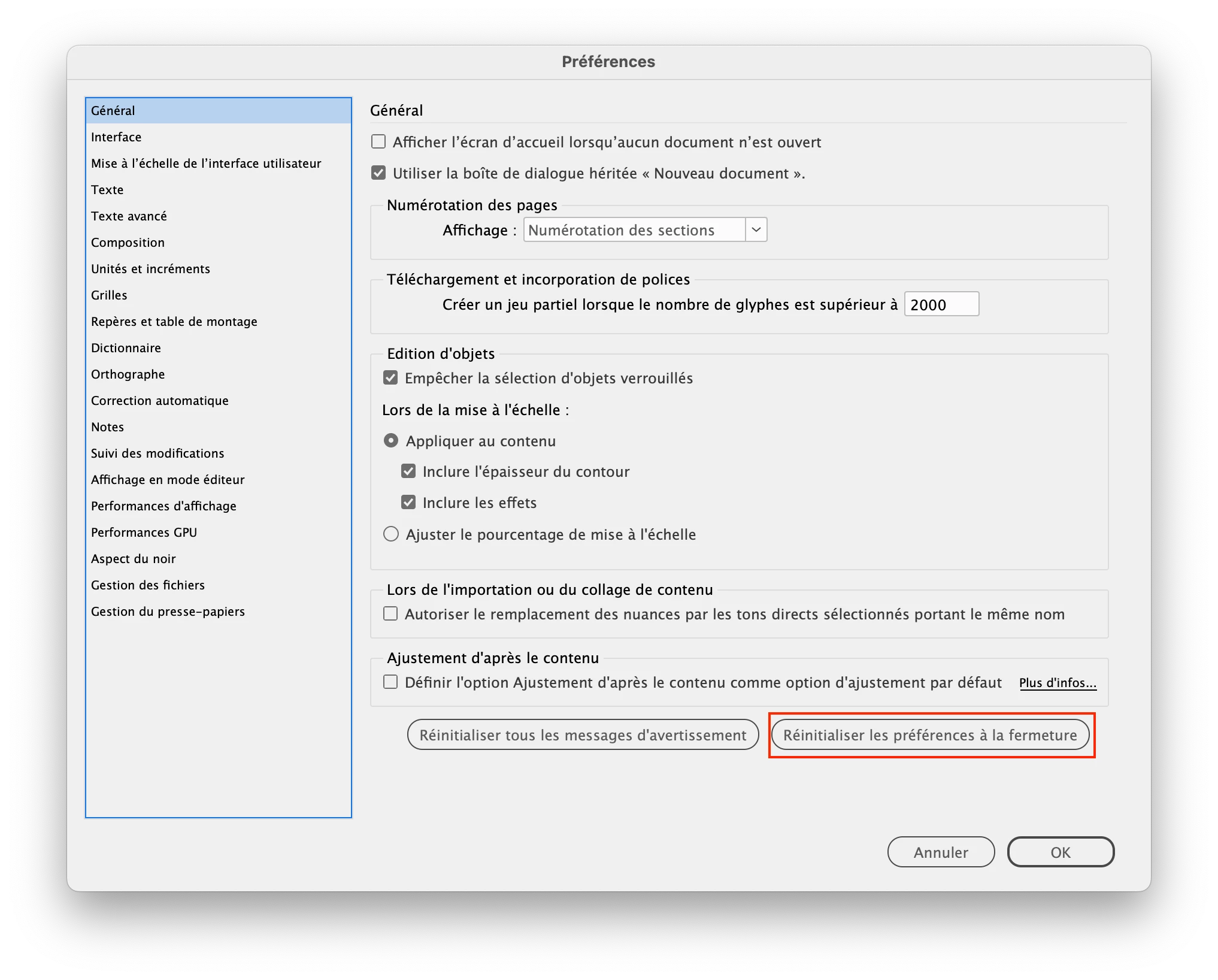

Essaie deux choses :
  1.  déconnecte-toi de ton compte puis reconnecte-toi
  2.  réinitialise les préférences d'InDesign. Avec la 19.4 c'est très facile
Pour être franc, je n'ai encore jamais essayé cette méthode de réinitialisation des préférences, j'ai tellement l'habitude de celle-ci : Il faut relancer l'application tout en appuyant simultanément sur Maj, Ctrl, Alt et Cmd jusqu'à l'apparition du message demandant confirmation.
