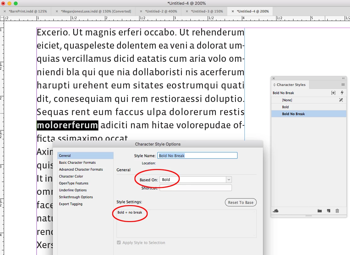

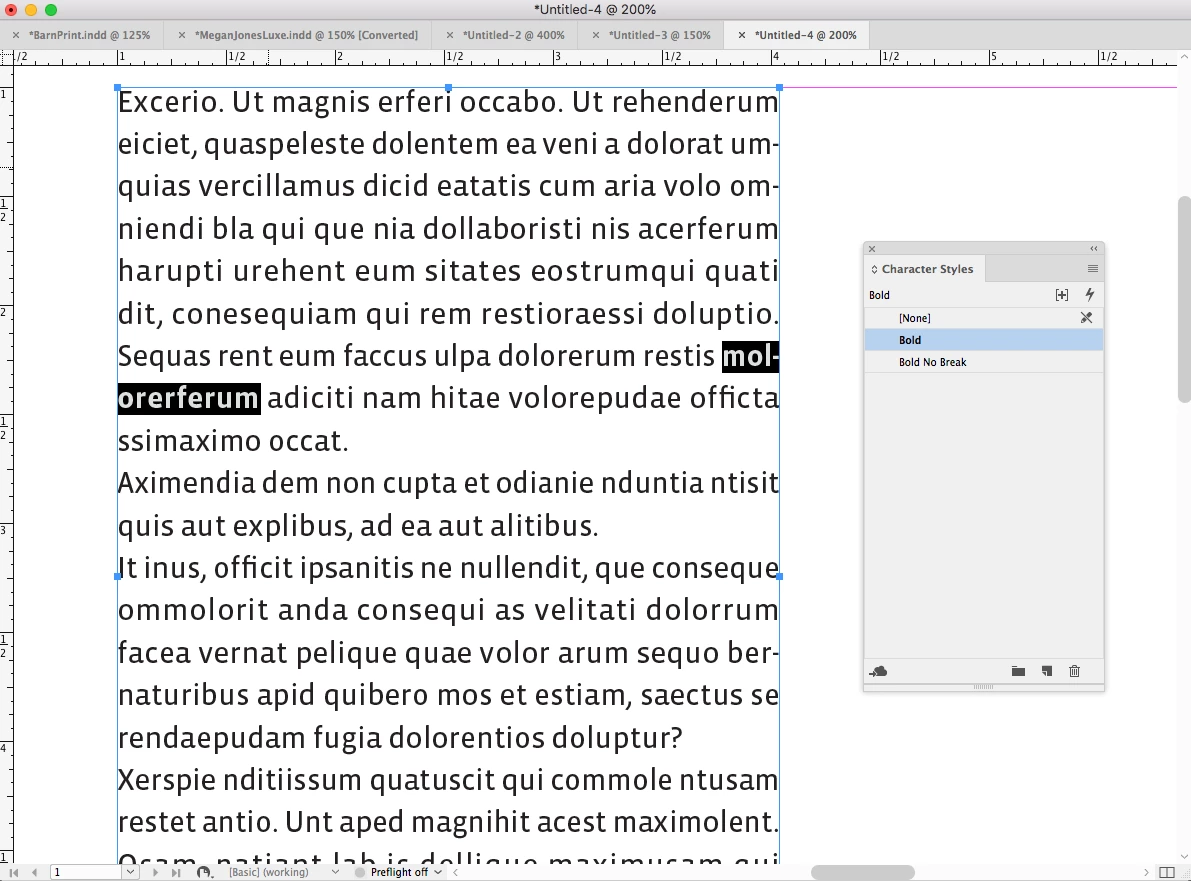

But the problem is, if the text I don't want to break already has the bold character style applied to it, applying a No Break character style removes the bold.
Sorry if I've misunderstood, but you can have a no break style that doesn't strip the bold if the no break style is based on the bold style.
You can base one character style on another, so make the bold character style and then make a new style based on bold that includes the no break

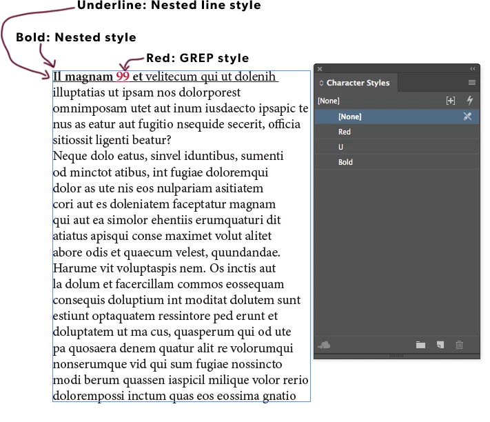

Scott Falkner
July 19, 2018
grudgemom  wrote
I was originally trying to set it up as a Grep style within my paragraph style but grep styles can only apply styles so I have to set up No Break as a character style in order to do this, and then it overwrites the bolding already used. Trust me, many pages of proofreading changes because I didn't catch that this would happen
That has not been my experience. When a GREP style or a Nested style applies a character style it stacks with character styles already applied, unless there is a conflict.
Below I have a paragraph style that applies three different character styles. Each character style effects a unique attribute, so they don’t conflict. Bold and Non-breaking will not conflict.
