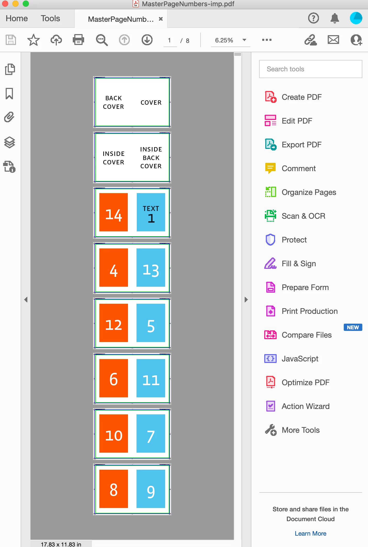

I am attempting to print a booklet with 8.5x11 pages on 11x17 page with an Epson WF7720.
1. The print preview is correct, but the printed copy has the pages on the back of each sheet upside down and thus, also, out of order.
2. The color of some large text on each page (from Masters) is wrong.  Wrong in preview also.

    Correct answer BobLevine
    Export a proper PDF and use Acrobat’s booklet feature.

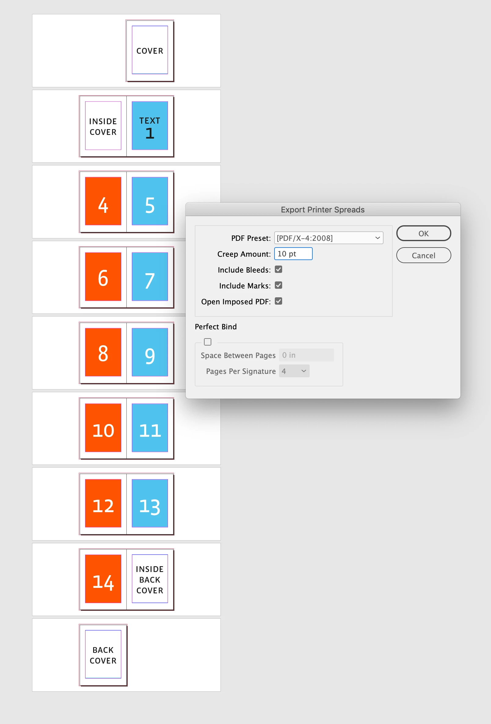

    rob day
    July 24, 2023
    Hi @bartenational@thinkkal , you are welcome to try this imposition script, which imitates the Print Booklet feature set (Acrobat’s Booklet print option does not have perfect binding, creep, etc.) but gets around the problem some print drivers have with postscript:
    https://shared-assets.adobe.com/link/3bfdb004-f188-4f3d-5904-d82dd8f8e2d1
    Dialog:
