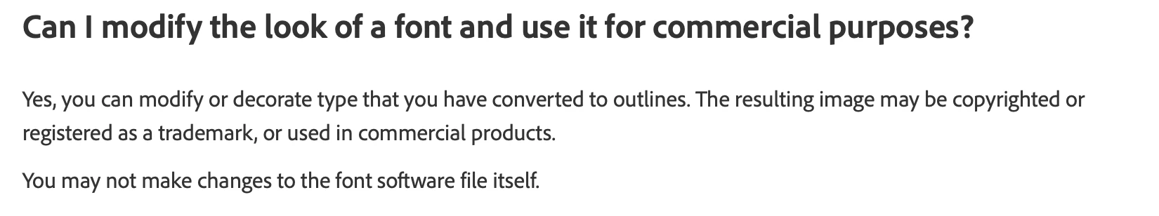

According to @Scott Falkner's screen shot, if you outline it, it's fine to modify the font. (Again, I'm an InDesign expert and not a lawyer). I did reach out to Adobe for you for an official response.

Thank you for getting in touch. I've consulted with our fonts team regarding your query, and they recommended that the best you can do is convert text to outlines and modify a character, but you can't modify or replicate the font software itself.
Please let me know if this helps or if there's anything else I can assist you with.

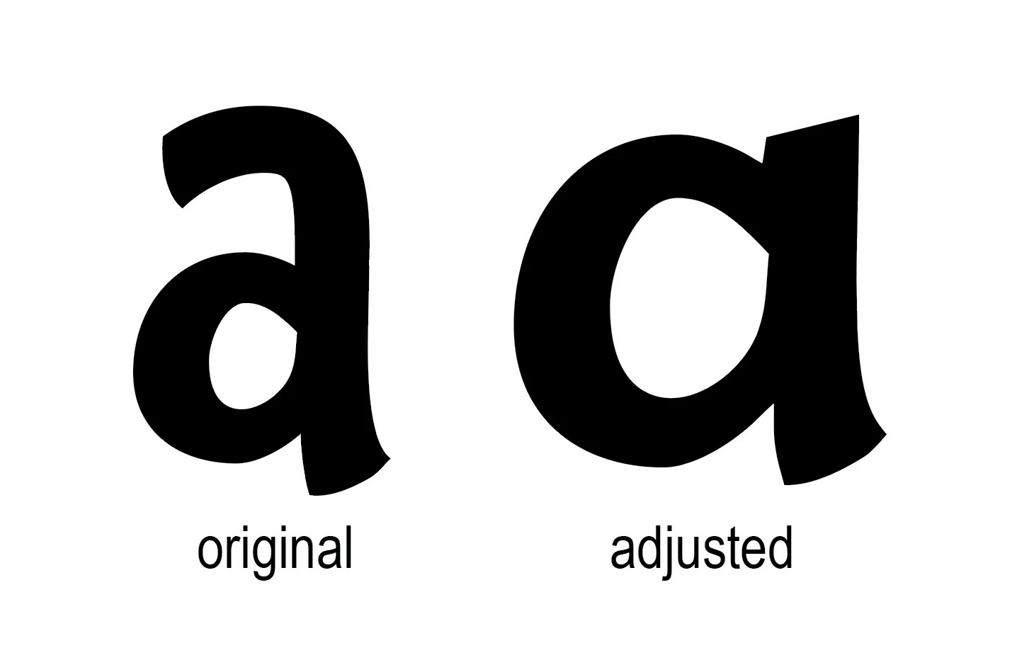

I guess, what I'm concerned about is that I'm not changing it to a completely different font. I adjusted the Chaloops "a" and made it single story, and I'm just going to manually place it in my book. I've attached a picture to show you what I mean. People tweak fonts for logos and stuff, so I'm assuming it would be fine, since I have an Adobe subscription and downloaded the font, but I just wanted a second opinion. Thank you.
