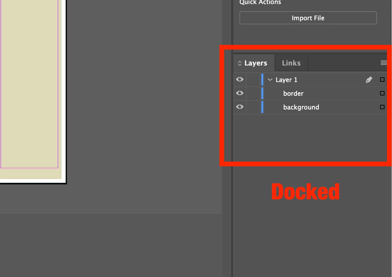

Dec 19, 2020 7:08 PM UTC
I just got out of a support chat with Adobe. It appears the problem only occurs if the layer panel is docked. If you float the panel, it works fine.
Dec 19, 2020 7:11 PM UTC
Personally, I think this is a bug. The tech I spoke with said it was designed that way because when the panel is docked, the system assumes the sub-layer is locked. While the workaround is acceptable (for now), I'm planning to file a revision request here: https://indesign.uservoice.com/

Dec 11, 2020 9:09 PM UTC
Was having this same problem this is the work around I found as it appears to be a bug in InDesign 16  with macOS 11:
Undock the Layers Panel and let it float. Clicking on the name should now allow the name to be edited. It appears that this feature doesn't work for renaming Page Items that are under the layers if the Layers Panel is docked.
Dec 13, 2020 5:39 PM UTC
Whoaaaa I'm seeing this too! I'm using it without my Wacom tablet right now (will check later or tomorrow), just using the trackpad, but I'm getting this exact behavior. Can't rename when Layers window is docked, but works perfectly fine when it's floating on it's own.
Dec 14, 2020 2:05 PM UTC
Same behavior with Wacom tablet. Rename function does not work when Layer window is docked in a group, yet it works fine the window is floating or docked by itself, even as a fly-out window.

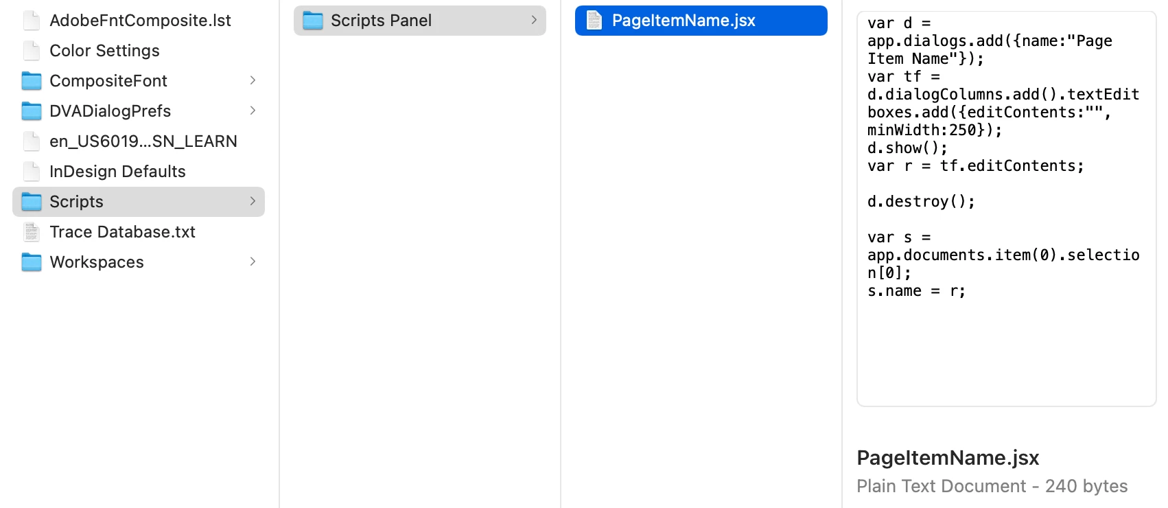

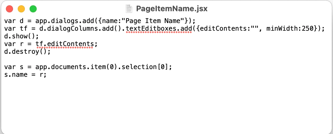

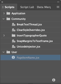

Hi @rob day
I'm having this same issue and it seems like this is a good fix but I'm having a problem running the script. I've been able to save it as a .jsx with in the correct folder but when in InDesign (with the item selected or not) the new script is greyed out and says "This file is not executable by any supported script language." Am I missing sommething somewhere? Thanks
rob day
Dec 11, 2020 10:26 PM UTC
Happy to hear you figured it out.
On the scripting unfortunately Adobe’s ExtendScript Toolkit is not 64-bit and won’t run on Big Sur. Looks like you used Text Editor, but the file has to be set as Plain Text under Format (not Rich Text), and the extension in the Finder has to be .jsx (not .jsx.txt)
In case you want to try it with your panel docked here it is compiled
https://shared-assets.adobe.com/link/aab957e4-ca50-49ce-69b0-180783a740ce
Dec 14, 2020 2:48 PM UTC
Thank you @rob day!!!
I was removing the formatting and saving it as a .jsx file but it was still recognizing it a plain text file (compared to the file you supplied, which is referred to as a Document). I downloaded the .jsx file you provided and that worked!!! I guess going forward I can just edit and resave this .jsx file so the file format stays the same.
