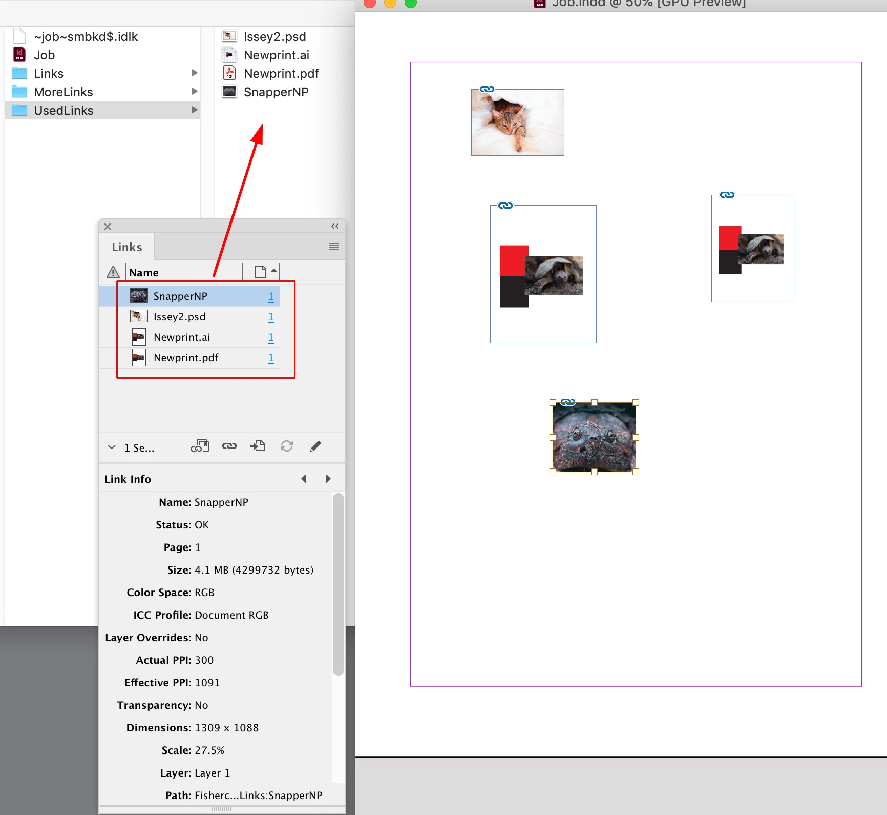

Hey gang,
Is there a script or method that can look in a Links folder and see which files are NOT being used in the InDesign layout? Having identified them, those extra graphics could be moved or deleted. That is what I am trying to accomplish. Any good ideas?

I haven’t test mine very much—not sure if this is a problem, but if you run the script multiple times on the same document, the links are going to get renamed and appended with _1. It would be possible to add a dialog that asks you to name the new folder.

Thank you both for posting these scripts. Both work. Manan's delete files instantly. Rob's moves them to a new folder and adjusts the Links and does not delete files. Both work well.
Question 1: Could this be made Undo-able? (as in that code method the Theunis de Jong posted about a couple years ago?)
Question 2: Could these scripts be made to announce an onscreen alert so as to indicate that they have completed something? (They both do what they do without any fanfare or user alert interaction. I had to look in the subfolders to see that something had been changed.)

There is the doScript method that lets you undo a script, but I don’t think it will let you undo Finder/Explorer operations—Manan might know more about that. An alert is easy:

Hi Manan and Mike, Another option might be to use the link’s copyTo() method, which is the equivalent of the Link Panel’s Utilities>Copy Link(s) to... menu item. In this case the document links could be in any folder, and files that are not linked don’t get trashed. You could also do this manually via the UI, but in that case the links get copied—the script moves the use files without trashing the unused files:
