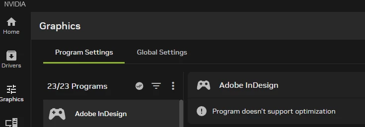

I have an Nvidia RTX 4060 as well. I am running Indesign 2026.
I performed a full video driver update as of May 9 2026 and have discovered the same issue here. I updated the Nvidia driver (Studio Driver. NOT Game driver) and this is the report:
From Nvidia dashboard:
Runkang

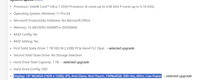

So the only solution is change a laptop? Change to a 1920 x 1200 screen does it fit the 2K specification?  I think 2560x1440 is stands for 2K…
Thank you.
question: 1920 x 1200 treat as 2K?
