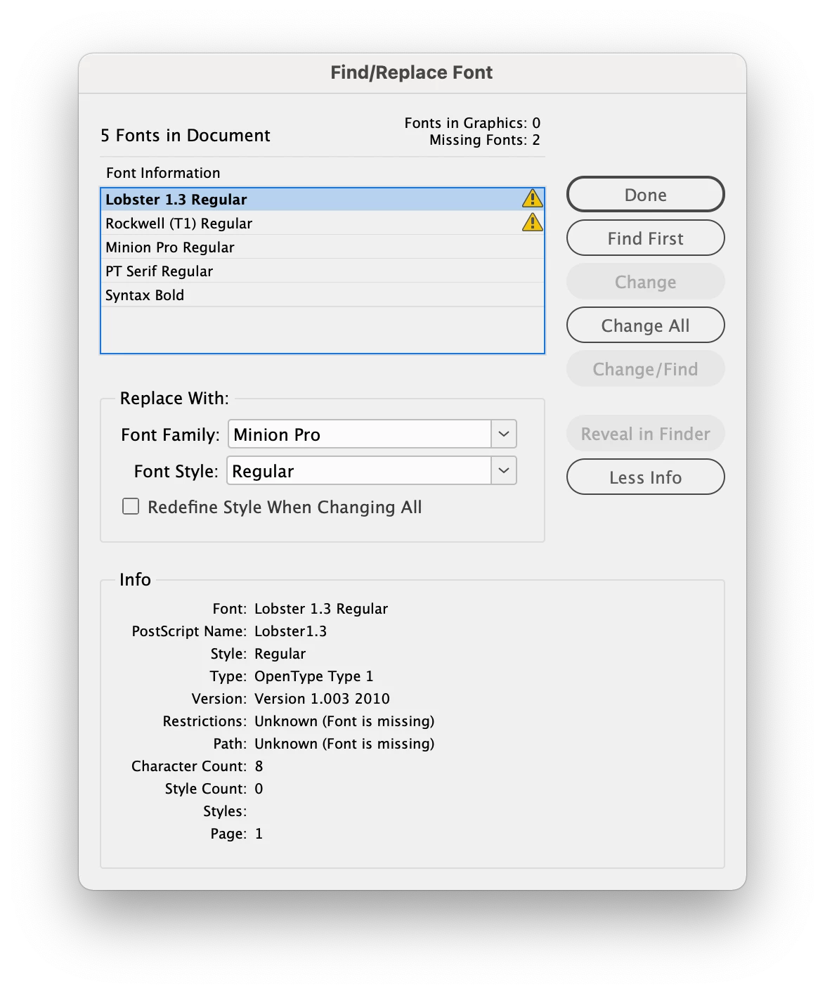

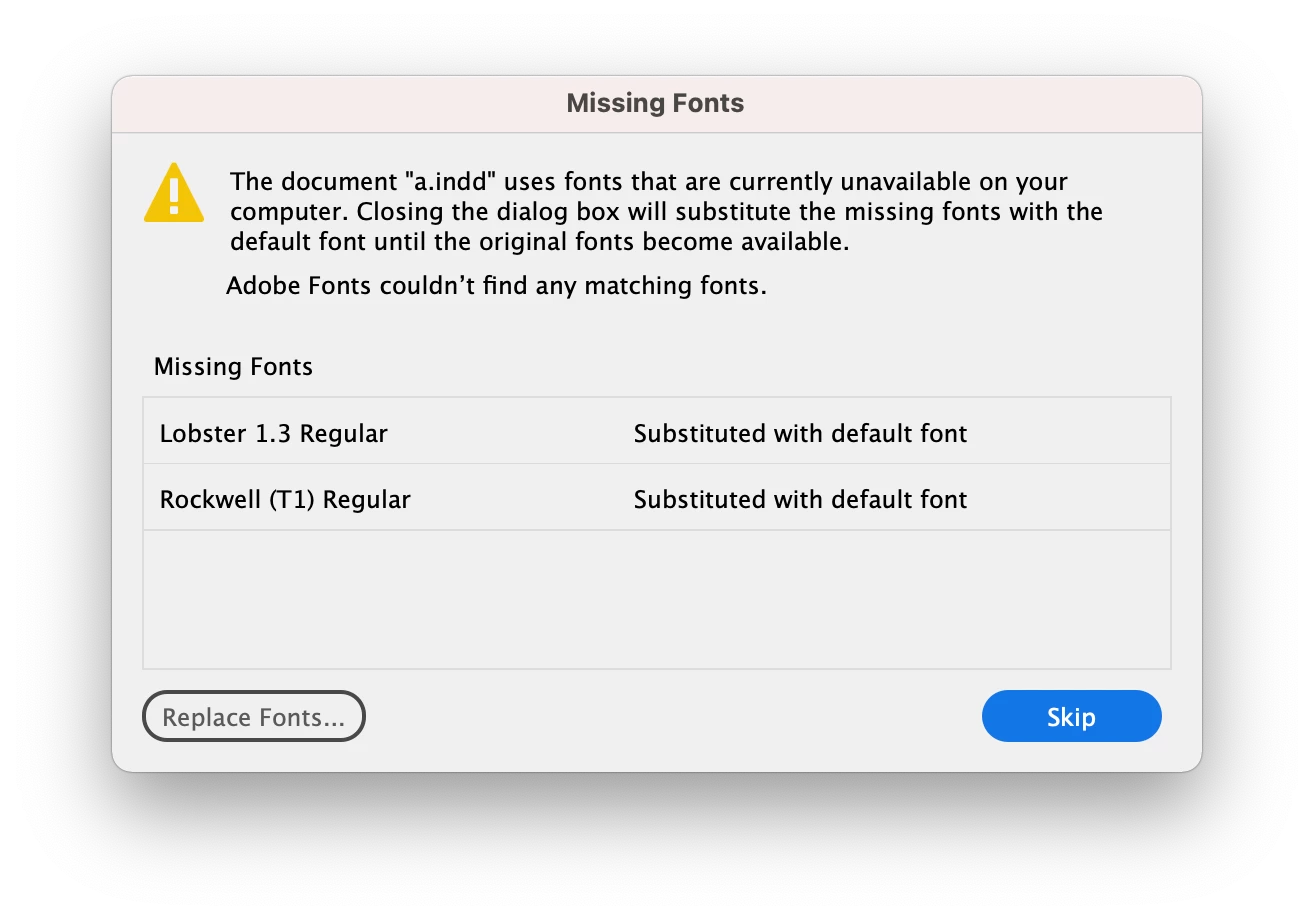

Something else to keep in mind is that you may have PostScript fonts in a document that give you this warning when opening:
I got the warning because Rockwell is a PostScript Type1 font, and it's not installed on my system, but the other font is missing not because it's PostScript—only because it's missing. If I hit the Replace Fonts button, I get this:
…which tells me when I click on Rockwell that it's a Type 1 font, but when I click on Lobster, I get this:
…which tells me that Lobster is an OpenType font (Type 1 flavored), so it would be fine if I can locate it. I just wanted to say to be careful that you don't assume everything that's missing is a PostScript font.
