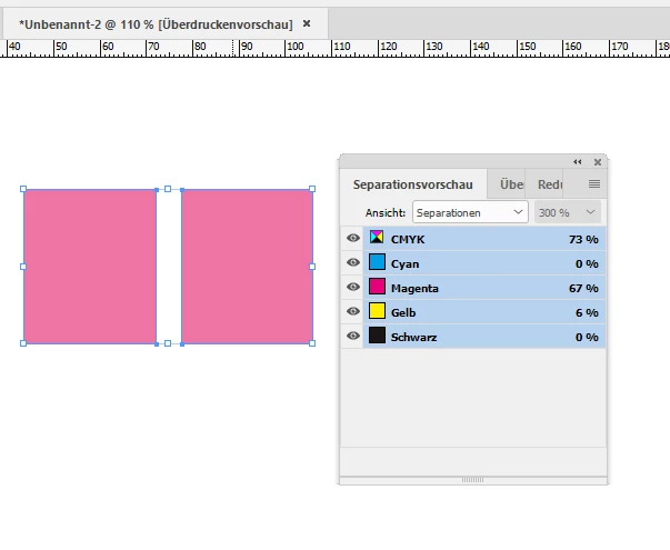

Hi Rob,
I can confirm what you see. And yes, I did the conversion back to CMYK on a duplicate of the color I converted from LAB to CMYK. Hm. I suspect that somehow InDesign remembers the initial LAB values of a converted color.
To test this I added a new color with same CMYK values from scratch using scripting.
Had two rectangles selected. One ( app.selection[0] ) with the converted fill color from LAB 100 | 127 | 0 to CMYK and another one ( app.selection[1] ) that has no fill color at all.
Now I cloned the properties of fill color of selection[0] to a new color and applied this to app.selection[1]:
var fillColor = app.selection[0].fillColor;
var newColor = app.documents[0].colors.add
		colorValue : fillColor.colorValue ,
		model : fillColor.model ,
		space : fillColor.space
app.selection[1].fillColor = newColor;
The result was this, optically the same, by numbers of colorValue the same:
After that I converted both colors to LAB using the GUI.
Both colors now are with the same values:
64.7699966430664,50.7003974914551,-3.05839991569519
Astonishing! I started out with LAB 100,127,0 and before I could see a roundtrip between LAB > CMYK > LAB with the same values for the fill color of app.selection[0]. At least I thought so…
Another test, this time with a duplicated color of LAB 100,127,0: Converted to CMYK in the GUI without applying the color to an object. After that I converted the color back to LAB with the following wrong result: 33,127,0. Why? I have no idea! Something is very, very odd here.
Hm. The differences could be:
In the process of testing I switched on Overprint Preview and finally Separation View.
And this time with the wrong result 33,127,0 I did not apply that color to an object on the page. All guesswork of course!
Now after typing all this I did one Undo and tried to repeat that wrong result with 33,127,0; alas now the conversion from CMYK to LAB yields again 100,127,0. I'm really confused what's going on here. It's a mess!
All tests done with color management set to:
ISO Coated v2 300% (ECI) with Relative Colorimetric conversion, module: Adobe (ACE).
InDesign CC 2019 version 14.0.3 on Windows 10.

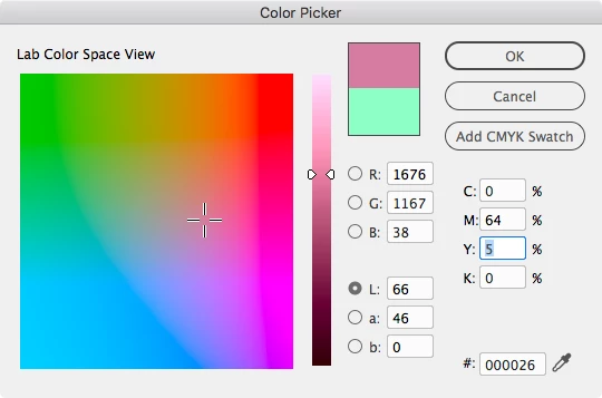

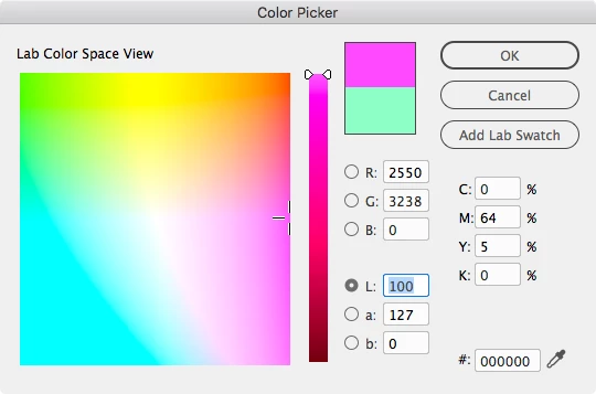

rob day
October 30, 2019
Yes, InDesign’s UI has always "remembered" the starting value—I think it is a bug, others might think it’s a feature. Same thing happens with RGB>CMYK>RGB or CMYK>RGB>CMYK conversions. In the case of CMYK>RGB>CMYK, the problem is more obvious. A built CMYK color like 10|0|0|50 could never convert to RGB and back via color management and keep the original built values.
If you use Photoshop’s Convert to Profile you can see what the color managed numbers should be. Even colors inside of the gamut might not make the round trip with no change, a lot depends on the color intent used and the relative position of the color in the space.

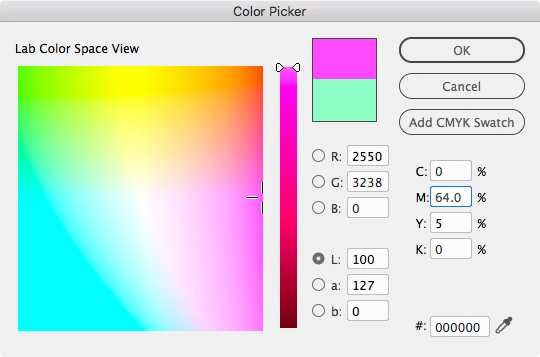

In ID, if you make a very slight change to the converted value, the conversion back to Lab will be correct (new values with out-of-gamut colors). You can see that in the Color picker:
Enter the Lab values
Make a minimal edit to one of the CMYK values. Here I'm simply adding .0 to the 64% Magenta value:
Moving the cursor to the Y field repositions the plot in the space view, and the Lab values are now what they should be for the 0|64|5|0 CMYK value:

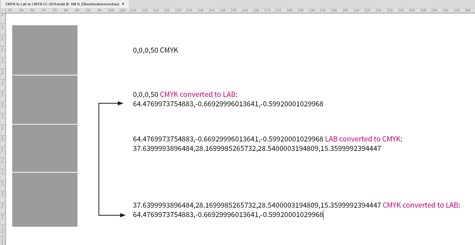

Hi Saurabh,
when with InDesign and you are staying with the same document and do not change the color settings of the document you could start with any LAB value, convert that to CMYK and later that CMYK value can be converted back to the same LAB value.
My example below is with process colors:
What's also possible:
Start with a CMYK value of 0,0,0,50.
Step 1: Convert* that to LAB: 64.4769973754883,-0.66929996013641,-0.59920001029968
Step 2: Convert* the LAB to CMYK: 37.6399993896484,28.1699985265732,28.5400003194809,15.3599992394447
Step 3: Convert* the CMYK to LAB: 64.4769973754883,-0.66929996013641,-0.59920001029968
*My numbers are following the color management settings of the document:
Your numbers with step 1 to step 3 could be different.
So you see: Two different CMYK values can yield the same LAB values:
IMPORTANT EDIT:
The shown results in this post for the roundtrip part, step 2 and step 3, could be due to some bugs with InDesign!
See the posts below. Especially the next one by Rob Day. This matter is rather confusing and should be further investigated.

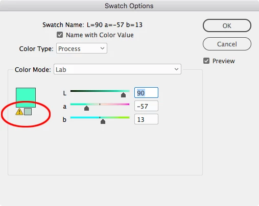

I am trying to acheive this in Illustrator ...
Lets say I have a LAB spot Color of Values
  mySPOTlab=[89.99916927472105, -56.74431793281322, 12.61283695195025]  in my Swatch pannel.
I used this color LAB values on my document.
While extracting color from the document. I get CMYK value for this( since document i created is in CMYK mode).
say myCMYK=[44.99916927472105, 43.74431793281322, 100,4.2879];
and now for my validation if I convert this CMYK back to LAB , I am not getting the same values .
var result =app.convertSampleColor(ImageColorSpace.CMYK, mySPOTlab, ImageColorSpace.LAB, ColorConvertPurpose.defaultpurpose);
Idealy  mySPOTlab==result.
but it is not so...
rob day
October 29, 2019
mySPOTlab=[89.99916927472105, -56.74431793281322, 12.61283695195025]...
Your starting spot Lab value is far out-of-gamut to any real world CMYK space, so the conversion back to Lab from CMYK could never match.
LaubenderCommunity ExpertCorrect answer
