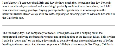

I copied a word doc into InDesign. Looks perfect, last thing I need to do is to insert a grey horizontal line inbetween certain paragraphs. Those did not come over when I placed the word file in the new document. Since this is the first time I have to do this I know I can just use the - key next to the 0 on the keyboard but the orignal line in Word was gray and has an inner style to it, see the screenshot. Need to know how to create that correctly. I know I have to do in paragraph rules and I would think I need to name that rule ? Anyone?

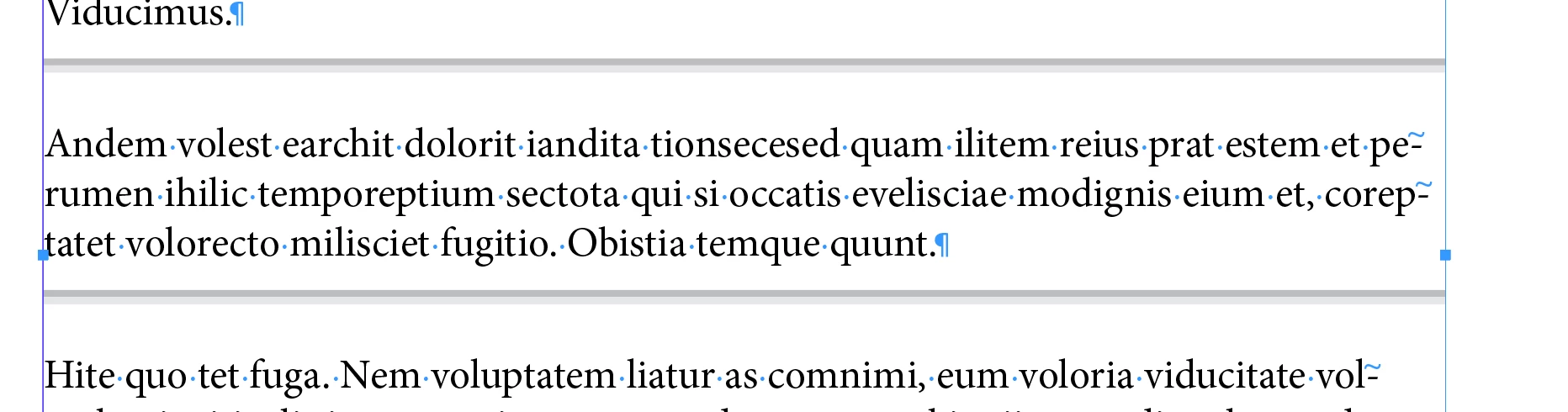

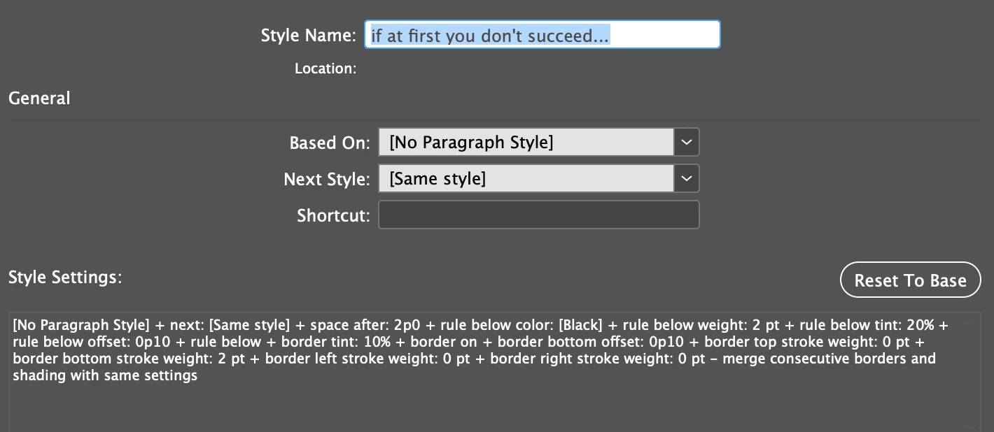

    Well, the idea I had walking out the door didn't pan out, but Jane's idea of combining a rule below with a bottom border works like a charm, on multi-length paragraphs, consecutive or not, no extra hard returns required! Here are the settings:
    I concur that the best way to add lines above or below a paragraph is through Paragraph Rules, but note the InDesign does not offer the same shadow that Word rules do. I suspect that a simple gray line will do the trick, but if you are set on the exact same look, you'll need to create it in a graphics application and then add it as an anchored frame.

    You can do a shadow (or approximate it) by using two rules, one above and one below, partly overlapping, different shades of grey. You need to twiddle with the offsets until it looks ok. Or an inner style again by two rules, one black and 2 or 3 pts, the other grey and 1 pts, with the grey rule placed on top of the black one.

    I've got the basic look going when I assign it to multiple consecutive paragraphs:

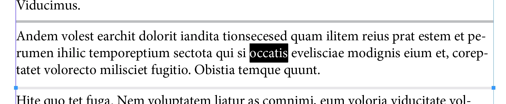

    But not for a single paragraph:

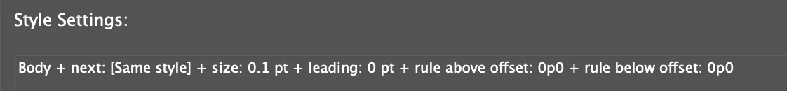

    Thinking out loud...what about assigning it to a super tiny ¶ with its own tag?
    Not a fan of multiple hard returns but that would work, or do you have a better idea?
