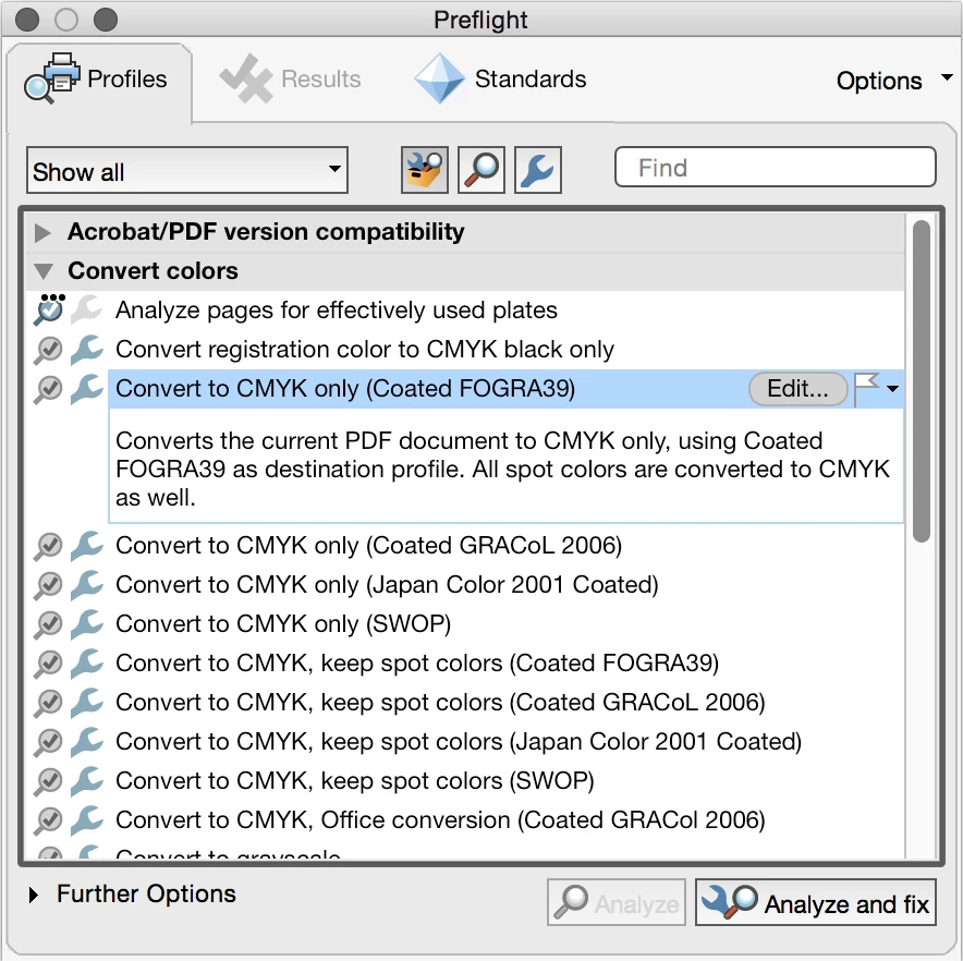

    If you're dealing with a lot of incoming PDFs of ads etc, then I'd recommend jane-e's suggestion of using Acrobat Preflight. Once you get your head around its interface, you can create a profile and corresponding droplet that will solve the spot colour issue and many others that you'll inevitably see no matter how clear your file submission guidelines are! Just drop the PDFs onto the droplet and they're fixed.

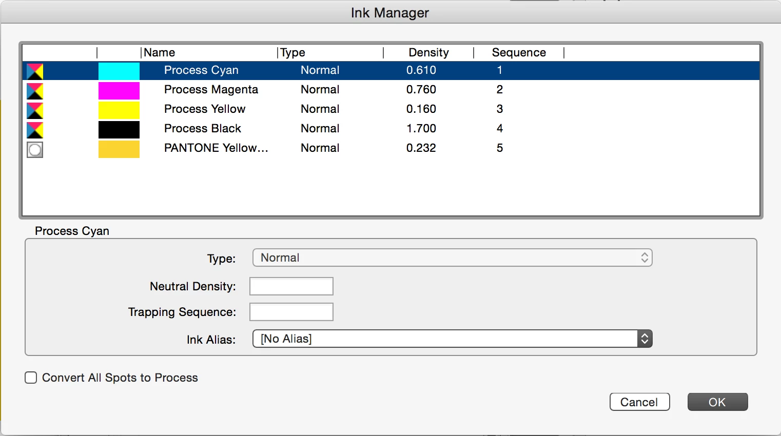

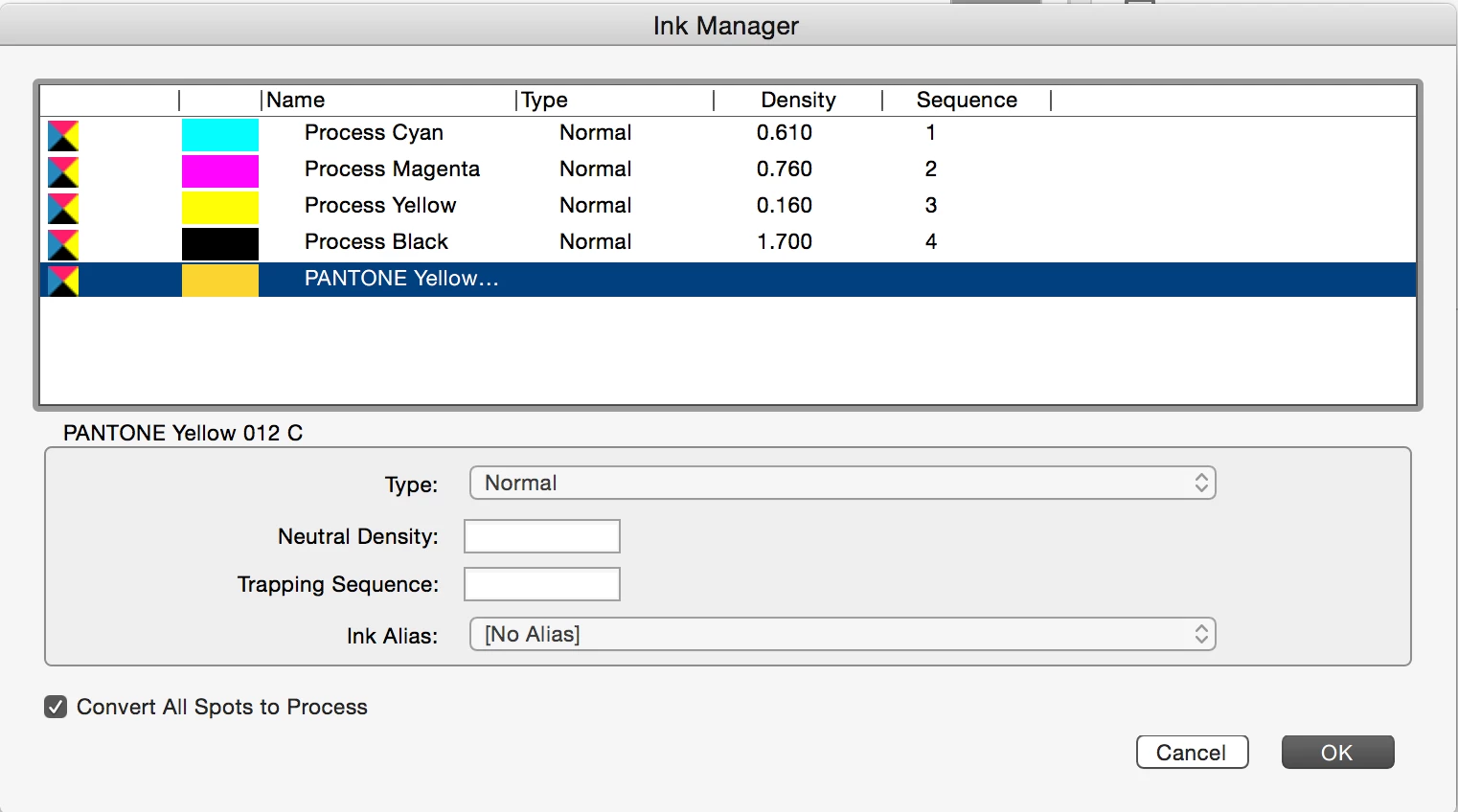

    If the issue is that all these spot colors are coming from multiple PDFs that people are supplying to you, can you use the Ink Manager in Acrobat to convert the Spot colors to CMYK before you bring the PDFs into InDesign?
    Two ways: click "Convert all" or click the icon to convert individually
    Alternatively use Preflight in Acrobat to convert to CMYK and get rid of the spot colors.

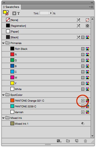

    rob day
    March 16, 2017

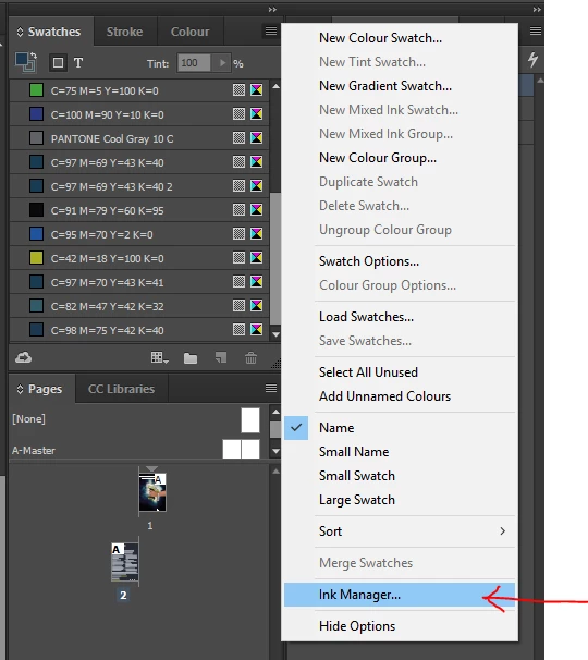

    Where do I find these offenders to change them to process?
    The Swatches panel shows the color's model. The spot color icon has a circle:
    You can use Ink Manager to convert spots to process, but if there are tints ink manager does not make the best conversion and you should change the swatch via Swatch Options.

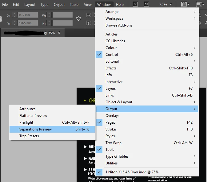

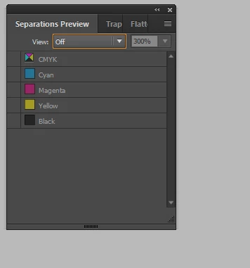

    FWIW: The answer to your ACTUAL question (in my opinion) is to use the Seperations Preview:
    This will list any colours in use in the document without having to do a find/replace etc...
    However you could also use the Ink Manager to make adjustments to any used spot colours to convert them to process:
    This article is quite useful: https://indesignsecrets.com/find-where-that-colors-used.php

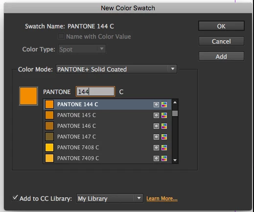

    Eric Dumas
    March 16, 2017

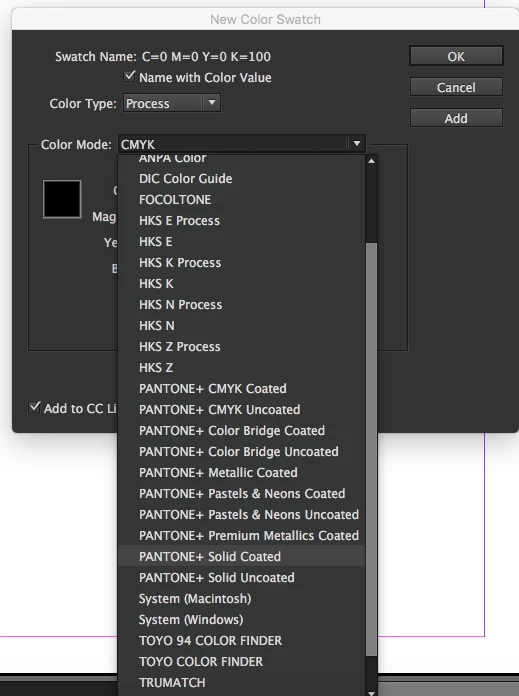

    To add a spot colour to use in your InDesign document, click on the Option menu icon at the top right of the colour swatch panel.
    1. click on the Option menu icon at the top right of the colour swatch panel.
    2. Select 'New Colour Swatch'
    3. In the new swatch panel, use the Colour Mode drop-down list to select the colour book you want, Like 'Pantone Solid Coated',
    4. Type the colour number you require and click on the Add button to add the colour to your Swatch Panel
    5. Repeat the operation from step 4 as needed
    6. close the window
    7. Select your object/text to apply the colours
