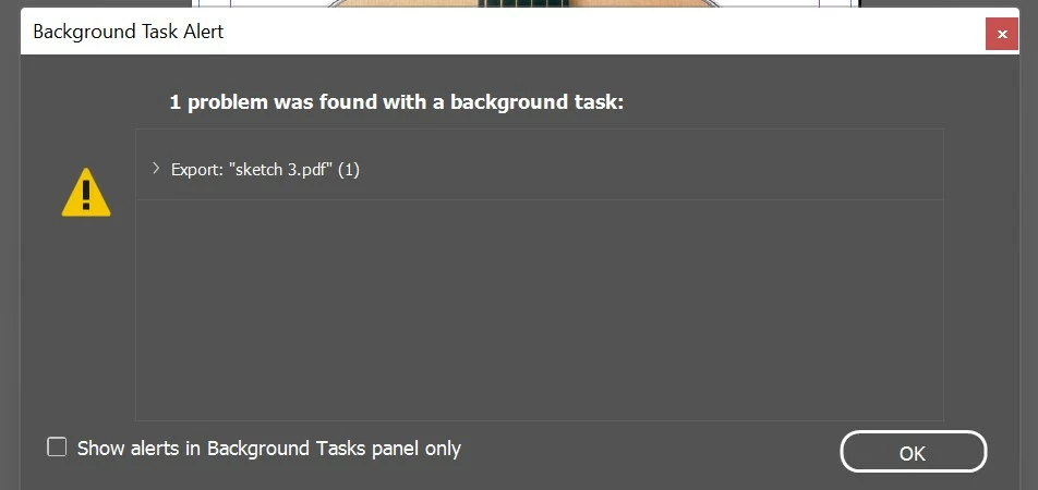

I am having a hard time embedding my font. It is a truetype font, and I tried packaging it and exporting it (with the subset fonts set to 0%) and it is still not working.
This is what comes up after I try exporting (and the file opens as a pdf with the wrong fonts)
Any ideas would be much appreciated. Thank you!

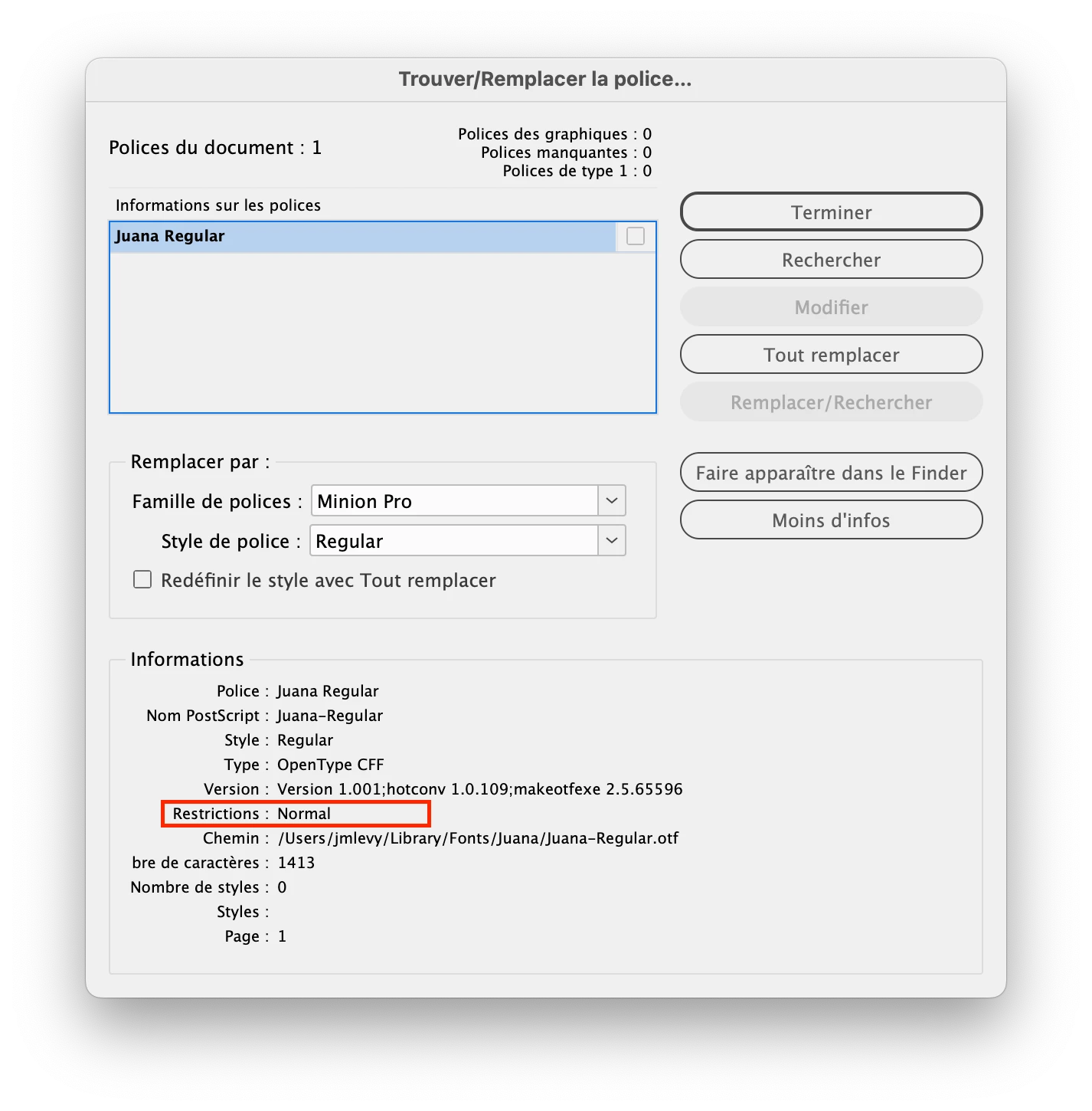

As @Rene Andritsch wrote, it could be because the font that you use does not allow embedding. To check this, go to the Text menu > find font, then click on the font name and read the infos > restrictions (be sure that the bottom panel is displayed by clicking on “more info”).
