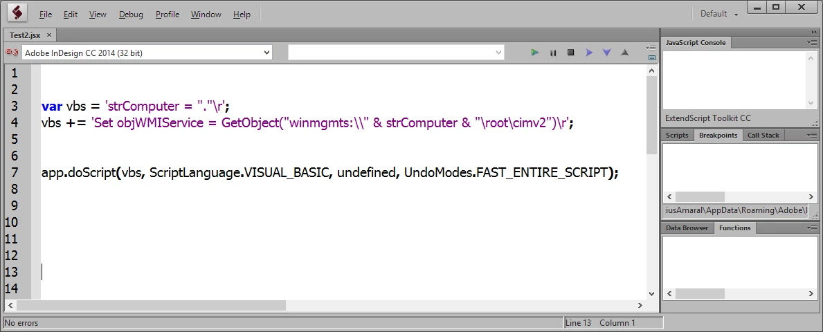

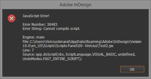

When I use it as a VBS file, everything works good, but I am not successful when I write it in JavaScript using the
app.doScript('My VBSCript line', ScriptLanguage.visualBasic);
I did it in many ways, I could not complete the script in debug mode.

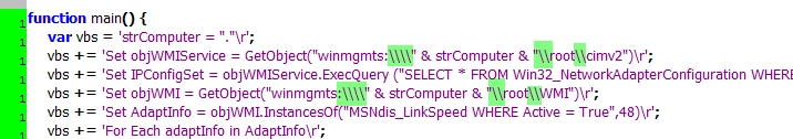

When I try to execute the VBS as a string in the JS, it not works.
When I do it separated, it works fine.
I would like to convert it in a binary file, and the file as a VBS, I can´t.
The AppleScript made using the same idea works fine on Mac.
Oh sorry, I forgot to mention: you have to double the backslashes in the vbs string.
This code works:
main();
function main() {
    var vbs = 'strComputer = "."\r';
    vbs += 'Set objWMIService = GetObject("winmgmts:\\\\" & strComputer & "\\root\\cimv2")\r';
    vbs += 'Set IPConfigSet = objWMIService.ExecQuery ("SELECT * FROM Win32_NetworkAdapterConfiguration WHERE IPEnabled = True")\r';
    vbs += 'Set objWMI = GetObject("winmgmts:\\\\" & strComputer & "\\root\\WMI")\r';
    vbs += 'Set AdaptInfo = objWMI.InstancesOf("MSNdis_LinkSpeed WHERE Active = True",48)\r';
    vbs += 'For Each adaptInfo in AdaptInfo\r';
    vbs += 'AdaptNameLink = AdaptNameLink & adaptInfo.InstanceName & vbNewLine\r';
    vbs += 'AdaptSpeed = AdaptSpeed & adaptInfo.NdisLinkSpeed & vbNewLine\r';
    vbs += 'Next\r';
    vbs += 'For Each IPConfig in IPConfigSet\r';
    vbs += 'If Not IsNull(IPConfig.Description) Then\r';
    vbs += 'AdaptName = AdaptName + IPConfig.Description & vbNewLine\r';
    vbs += 'End If\r';
    vbs += 'If Not IsNull(IPConfig.MACAddress) Then\r';
    vbs += 'MACadd = MACadd + IPConfig.MACAddress & vbNewLine\r';
    vbs += 'End If\r';
    vbs += 'Next\r';
    vbs += 'app.scriptArgs.SetValue "myAdaptNameLink", AdaptNameLink\r';
    vbs += 'app.scriptArgs.SetValue "myAdaptSpeed", AdaptSpeed\r';
    vbs += 'app.scriptArgs.SetValue "myAdapt", AdaptName\r';
    vbs += 'app.scriptArgs.SetValue "myMAC", MACadd\r';
    app.doScript(vbs, ScriptLanguage.VISUAL_BASIC, undefined, UndoModes.FAST_ENTIRE_SCRIPT);
var myAdaptName = app.scriptArgs.getValue("myAdaptNameLink");
var myAdaptSpeed = app.scriptArgs.getValue("myAdaptSpeed");
var myAdapt = app.scriptArgs.getValue("myAdapt");
var myMAC = app.scriptArgs.getValue("myMAC");
alert("myAdaptName: " + myAdaptName + " | myAdaptSpeed: " + myAdaptSpeed + " | myAdapt: " + myAdapt + "| myMAC: " + myMAC);
