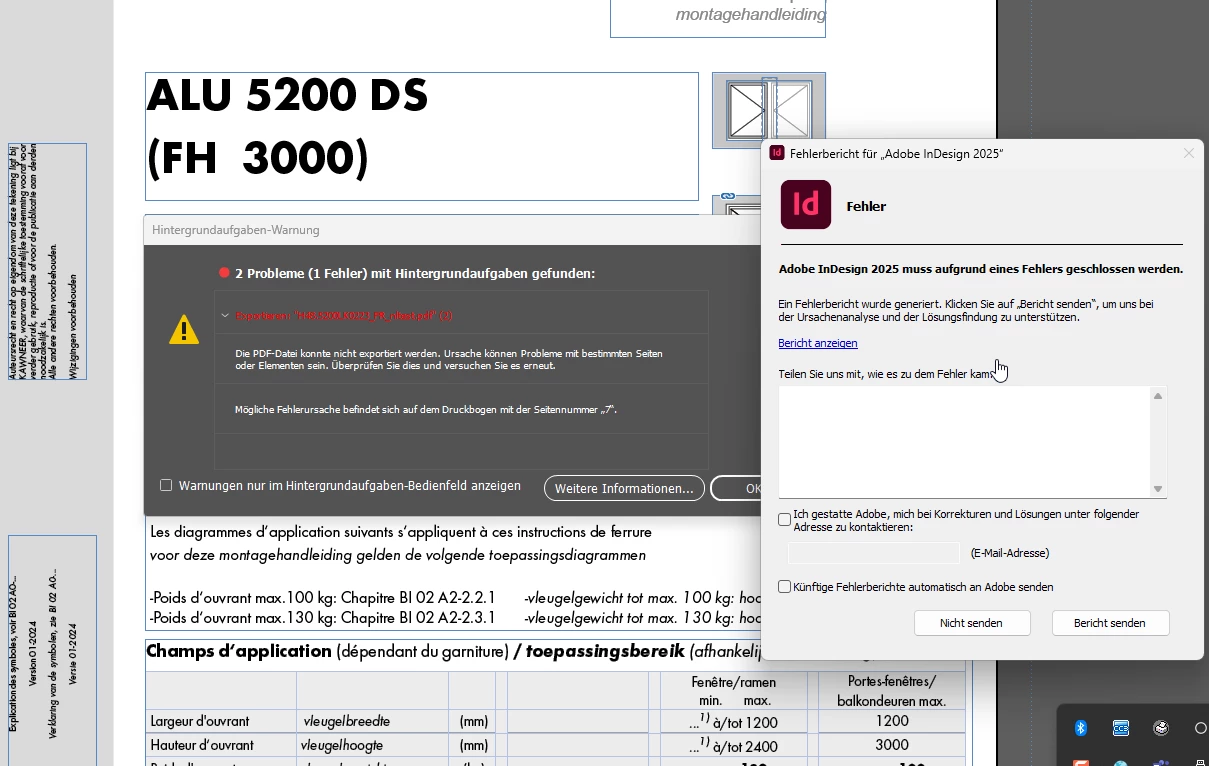

I have a problem with exporting ID-files to PDF and I hope the community can help! Everything I have tried - with or without the help of our IT - has failed. I am working out of Germany, but that cannot be the problem.
My basics are: Windows 11 (recently upgraded, about 6 weeks ago), ID Version 20.0.1, Acrobat 24.04.2.
Problem: starting last week I had trouble exporting from ID to PDF. Working on ID-files I had created about 6 months ago, I got the an error message re. missing fonts. Shortly before that Adobe Creative Cloud had updated ID to V 20.
After closing the application and restarting, the fault remained. New start of the PC - the same. Manually searching for the fonts in the ID-drop down menu shows they were not there. I had then the fonts-package re-installed by our IT. It seemd to solve most fonts problems, but not all. One Futura OTF font was still missing, but I could work with that and replaced it.

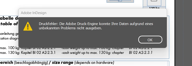

A couple days later I got the error message (in German): "PDF export failed. Poss. error cause can be found on print sheet 2 (or 4, or 7)." Contacted IT again and tried to uninstall ID (version 20), re-install same version (same problems). Again uninstalled ID 20, installed older ID version (19.5). No change. Between installing versions shut down PC and re-start. Uninstalled Acrobat Pro, re-installed from Creative Cloud - no change. When eporting from ID to PDF, the error message appears, ID is shut down and the original PDF (which was only to be updated) is lost! Then saved ID-file under a new name, export to PDF again with the new name - same problem. Always the remark on the "print sheet".
I deleted the print sheets from this file and imported the same sheets from another file - still the same.
I also opened another, older document in a completely new layout, deleted the contents and imported the contents from the document giving me trouble - the result is a PDF, but missing half pages or headers or ...definitely not ok, also fonts not ok.
De-installed ID 19.5 and installed ID V 19.3...exporting to PDF takes forever, and leads to the same error message! If I do get a PDF created, it is alyways missing content, mostly in the same places.
Exporting to JPEG - possible, but missing contents.
Exporting interactive PDF - same error message.
I am completely lost as to what I can do. I cannot create ANY PDF!  We even exported to the printer and used a free PDF creator - still the PDF could not be created. And all this started after Creative Cloud ran the ID update!
Anyone out there with an idea? Your help is highly appreciated!!
Thomas
leo.r
December 3, 2024
Did you try to save your document as IDML, then open IDML and save under a new name?
Also, have you tried general troubleshooting steps:
https://www.rockymountaintraining.com/adobe-indesign-rebuilding-preferences-cache/
December 4, 2024
We could solve the problem finally. I exported single pages out of the document in pdf and found that page 1 and 4 had missing content. Export as JPEG showed the same - 1 and 4. When selecting "Replace fonts" in the drop down menue there was one line that could not be changed - Futura Bold. After trying a few other things we completely deinstalled ALL Adobe programs, and I mean all, the complete Creative Cloud. Then deinstalled all Futura fonts from the computer and re-installed a new fonts package with Futura OTF. After that - bingo! Problem solved! The PDF engine in ID seems to get hung up on the missing line with Futura Bold. Funny though that this font was used also on other pages, not only 1 and 4, and has nothing to do with the error message "PDF could not created. Possible problem on print screen ..." Print screens did not contain this font.
