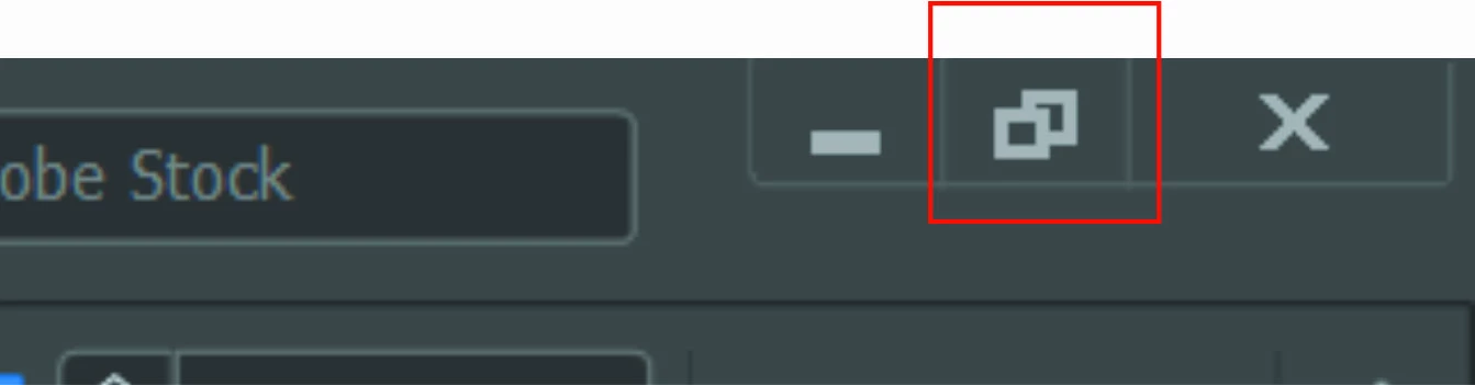

An odd but effective way to get rid of the blue banner is to resize the window.
Just click this twice and it goes away.

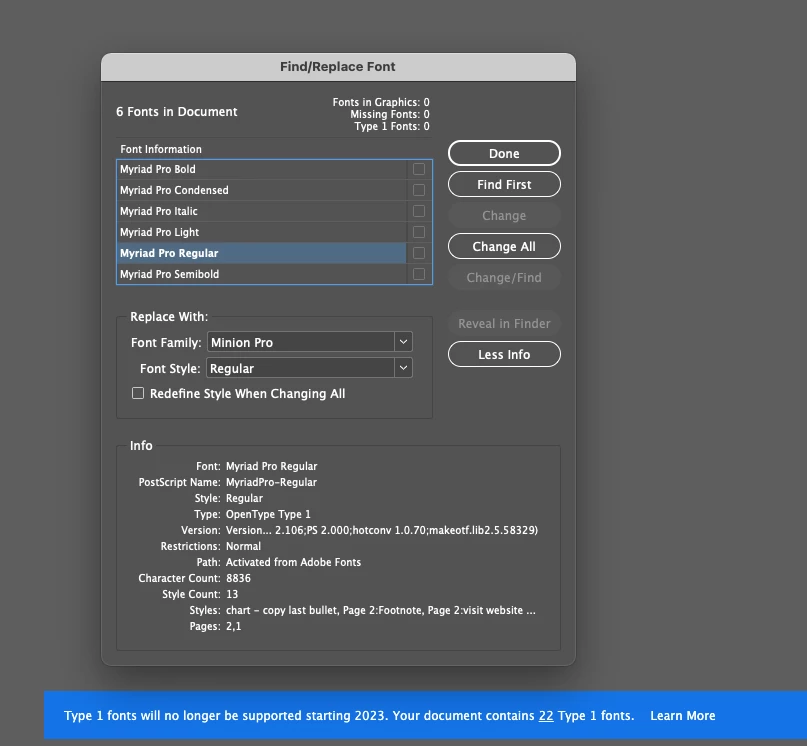

This banner simply will not go away. The even larger mystery on my end is that I have a document using Myriad Pro activated from Adobe Fonts that seems to be claiming that it is a "OpenType Type 1" font, even though I have read here in the community elsewhere that any fonts from Adobe Fonts should not be subject to this problem. The same window also says "Type 1 fonts: 0" which would make me think I should be in the clear. Does anyone have any ideas on this? I want to ensure older documents can still be read if there is a problem.
