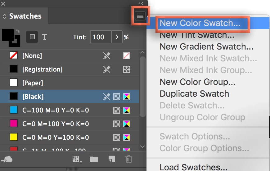

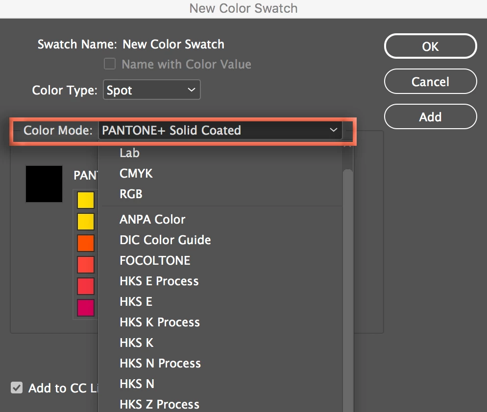

Barb Binder
Barb BinderCorrect answer
Feb 3, 2018 8:53 PM UTC
Hi Martin:

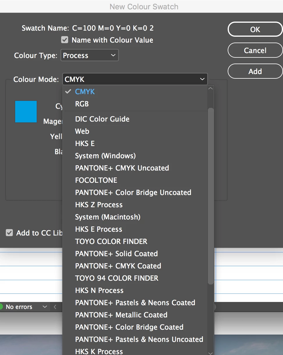

Did you open Window > Swatches > Swatches Panel menu > New Color Swatch, then choose a Pantone book from the Color Mode menu?
~Barb

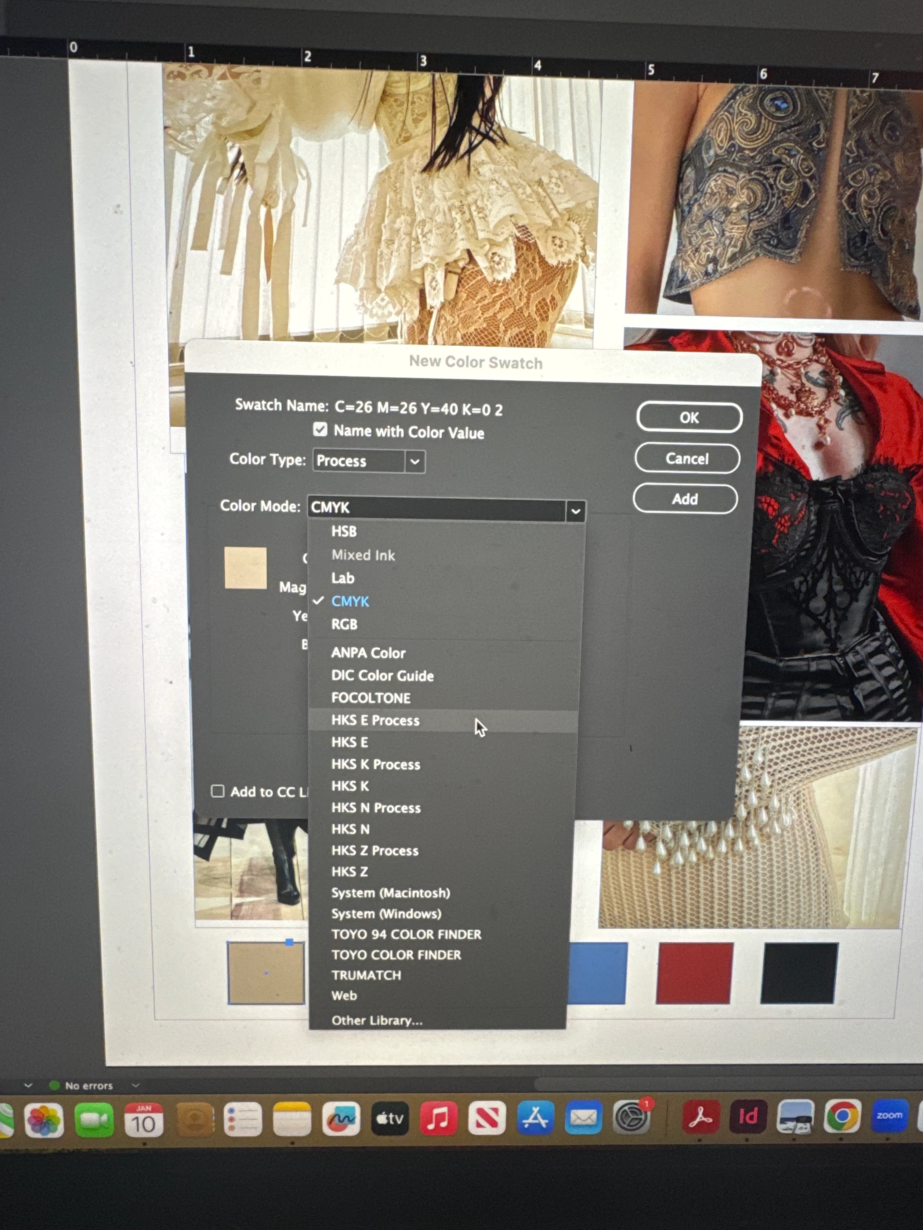

I cannot access the pantone colors. This is what shows up please help
Jan 13, 2025 12:51 PM UTC
This is 7 years old. Pantone colors are no longer installed as part of InDesign. Pantone has their own "Pantone Connect" program if you want true Pantone swatches. It's a paid subscription. Once you sign up for that, you can then install Pantone swatches through their extension/plug-in. I don't see a need for that, personally.
What I've been doing is just creating CMYK builds that match the Pantone build in my Pantone fan book, and then I click the "spot color" checkbox and name it that Pantone color. I then save it to my Library so that I can access it whenever I need. It's been working for me, and I just need a swatch to indicate the color. Doesn't really matter if it's not a "true" Pantone swatch.
But, yeah, Pantone and Adobe haven't had that same arrangement for a number of years, now, so Pantone does not natively provide their swatches by default. It's now a separate thing you have to pay for through Pantone, and then you can install the Pantone Connect extension/plug-in.

The Pantone acb files no longer get installed in any of the CC2023 apps, but you can manually install them by copying or moving the .acb files from your CC2021 folder to your CC2023 Swatch Library folder:
Applications⁩ ▸ ⁨Adobe InDesign 2023⁩ ▸ ⁨Presets⁩ ▸ ⁨Swatch Libraries⁩
After the manual install they should show in the CC2023 New Swatch Color Mode dropdown list.

Like I said, all of the swatches are already there -- the window just looks different, like @Steve Werner was saying. What you're describing in Illustrator is not the document swatches palette, it is the Color Book palette, which is separate. You don't load the entire Pantone library into your Illustrator palette either -- you view the full list in the Color Book palette and then you add the one(s) you want to your document swatches from there. Likewise, in InDesign, you go to the Swatches panel, select "New Color Swatch..." and then you select "PANTONE+ Solid Coated" or whichever... which then shows you the entire list of available Pantone colors, and you select the one(s) you want, just like Illustrator's Color Book palette, but with a different look/feel.

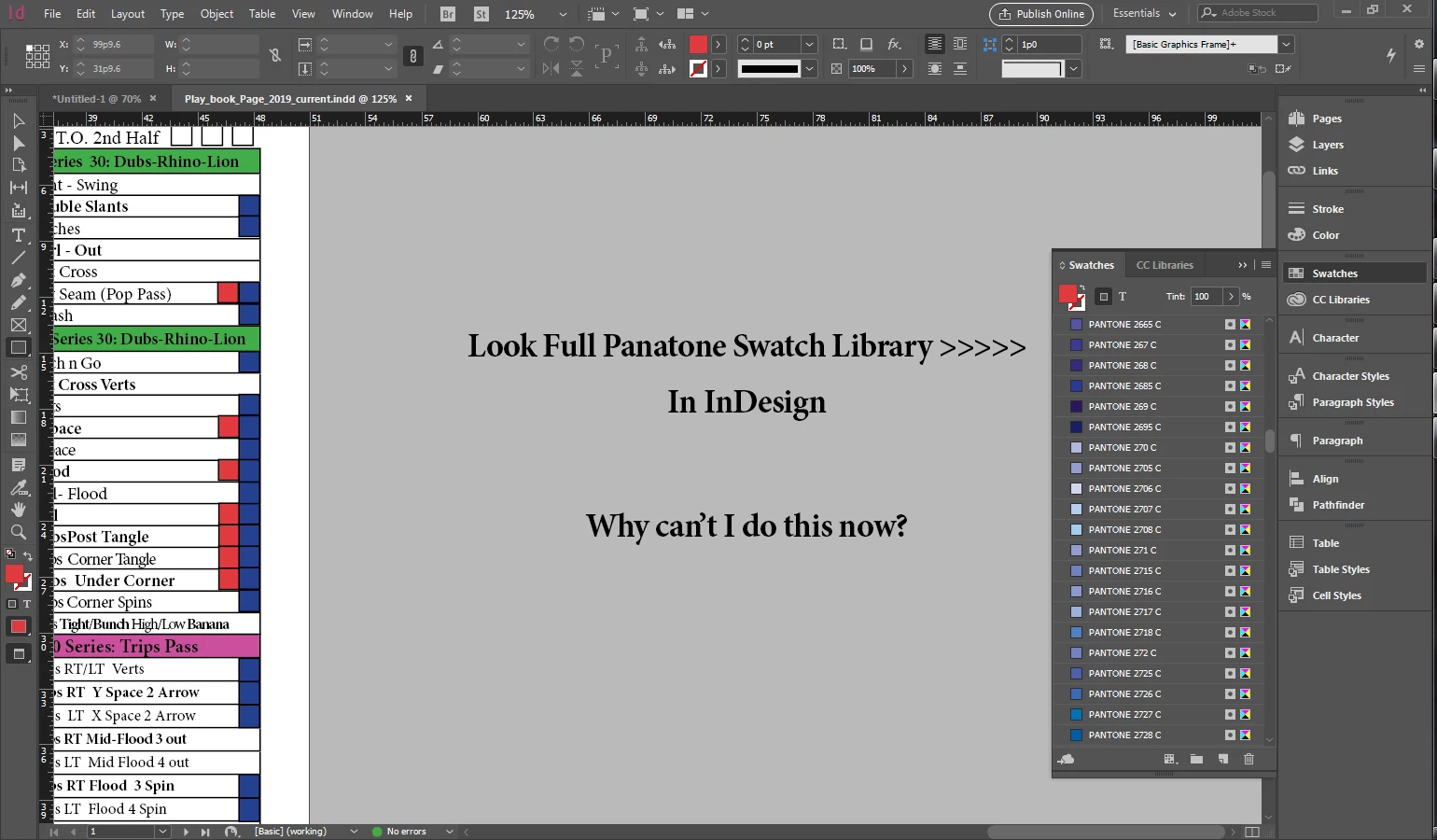

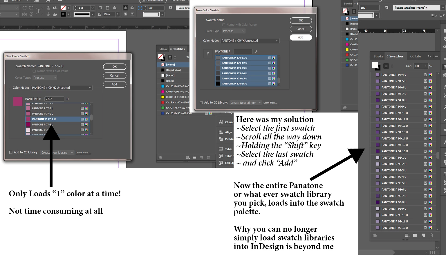

Aug 8, 2019 8:37 AM UTC
An actual answer that works
Seeing, for what ever reason, we can no longer load the entire Swatch Library, even though the "Load Swatches" option is available, I figure out a way.
Swatches >> New Color Swatch >> Pick a Library (ex.Panatone Uncoated) >> Select the first swatch >> Scroll all the way down >>
Holding Shift , Select the last swatch, and click Add.

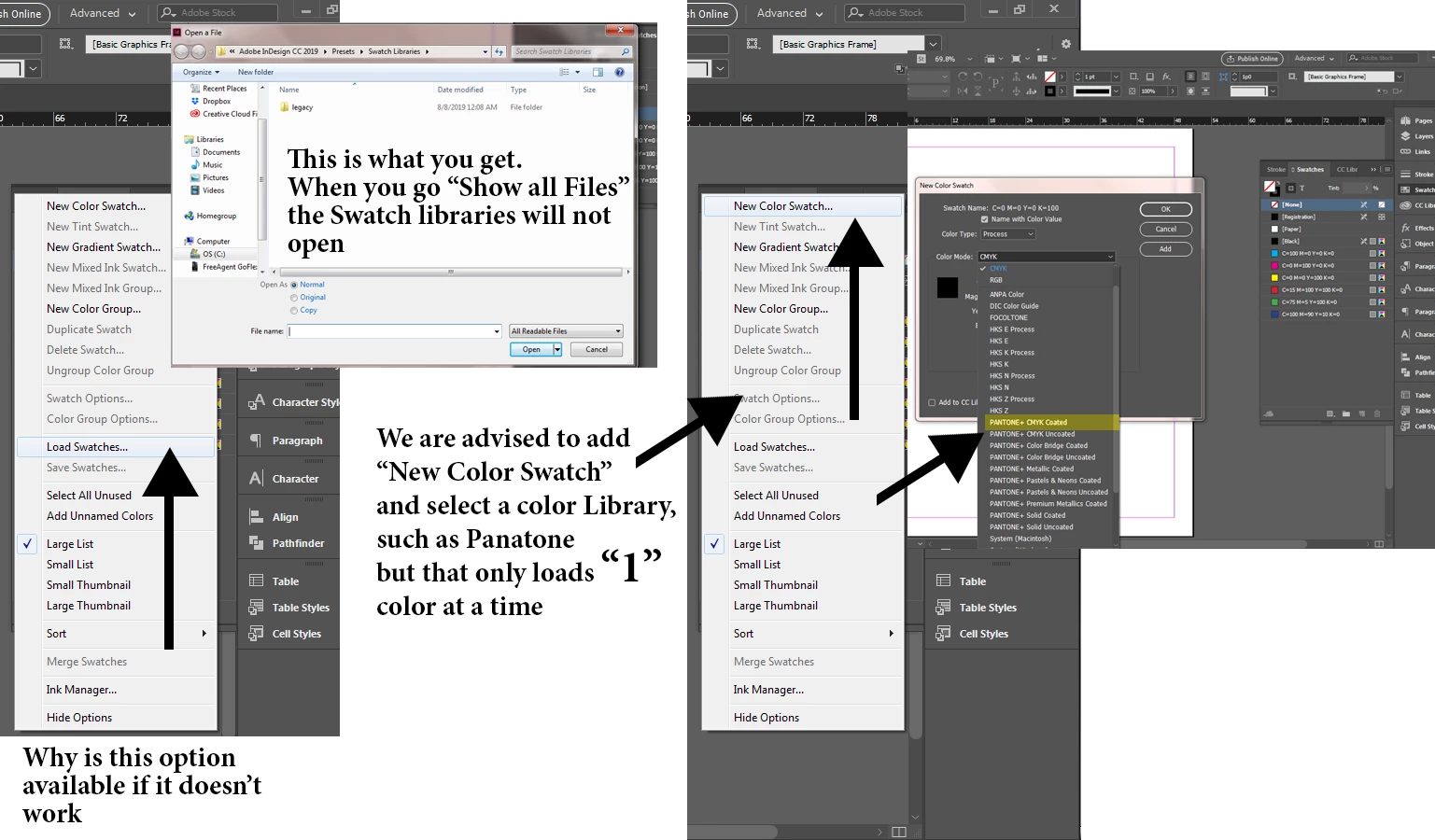

Aug 8, 2019 7:24 AM UTC
Calling BS on some of the advice
In the very recent past, you were able to go into "Load Swatches" option, which is still listed in Indesign and load the entire library.
Now you can't? You can only load one color at a time? How convenient!

Aug 8, 2019 11:46 AM UTC
keithagu75  wrote
…In the very recent past, you were able to go into "Load Swatches" option, which is still listed in Indesign and load the entire library. …
You still can do this if you have a *.ase file at hand.

Barb Binder
Barb BinderCommunity ExpertCorrect answer
Hi Martin:
