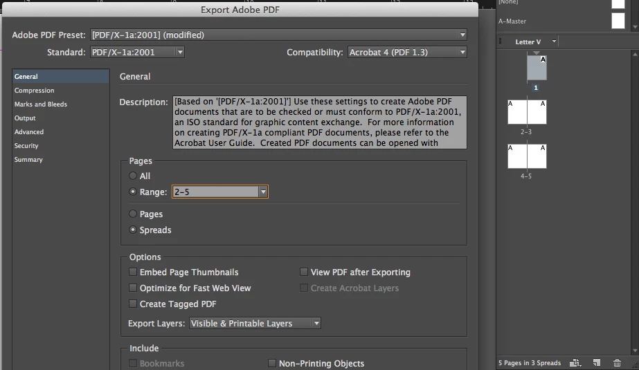

Some time back I figured this out and gosh I forgot how i did it.
because of lack of time here is one thing you can do to jump over this problem.
Leave page 1 empty.
design in page 2-3 & 4-5.
when you print just print from 2-5, skipping 1.
Also you can export your document as a PDF with spreads, but only pages 2-5.
You'll get a PDF with two 11x17

This is helpful, thanks, but still not applicable.  Remember that I have three vertical levels in my current setup:
Top pane: page 1
Mid pane: page 2 + page 3
Lower pane: page 4
You've referred to pages 4-5 in your solution, but I don't have a page 5.  You must have been set up differently.
Larry G. Schneider
December 31, 2013
Add a new page to the page 4 level and ignore page one. If you've already created the 4 page document you could export it as a PDF, use the Extract Pages option in Acrobat and place the new PDFs as a single page to get the 4-1, 2-3 you need to print the file.
