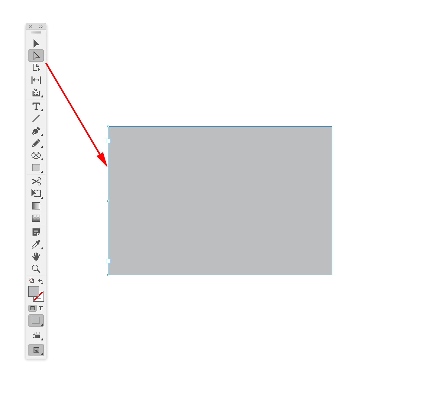

Hi @Michael J B , If you Direct Select (white selection tool) the side of a frame, you can Copy, then Paste in Place to effectively clone the frame’s edges (see @Scott Falkner ’s reply). Give the clones a stroke, and Group the clones and frame:
Copy>Paste in Place>Select All>Group
Now using the Selection tool the frame can be resized and the side strokes will travel with the frame:

rob day
October 2, 2023
I’m not seeing an alignment problem:

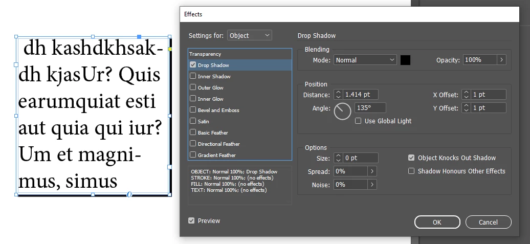

Robert at ID-Tasker
October 1, 2023
Something like this - easy: OK, looks like it's not exactly what you are looking for... but maybe will help others:
No single cell Tables, no anchoring, embedding, grouping, etc. - all naturell.
