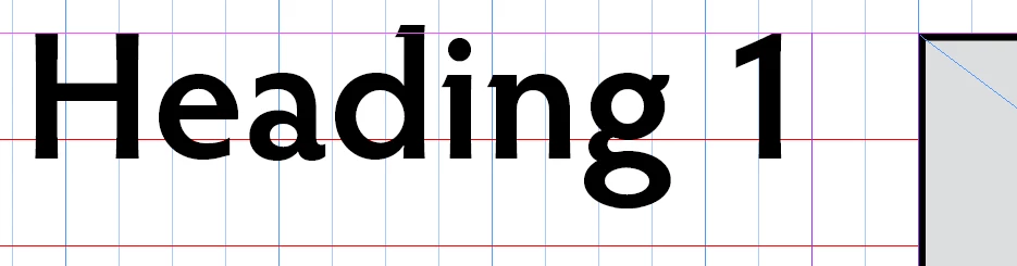

James Gifford—NitroPress
August 21, 2022
The top of the image and the Heading are aligned to nonexistent differences. The image may distort this slightly. Head right-aligned to save space for this image:
The gutter could be changed to another width.
What you are objecting to, at monumental length, is that space above and below a line of text is not identical. This applies exclusively to the inlaid graphics and could be eliminated, while retaining the snap-to-grid layout, by doubling the vertical document grid (here simulated):
You can use any number of such offsets to accommodate for top spacing, but as that differential is universal in nearly every well-laid-out publication in any library, the problem may not be what you are choosing to make it.
