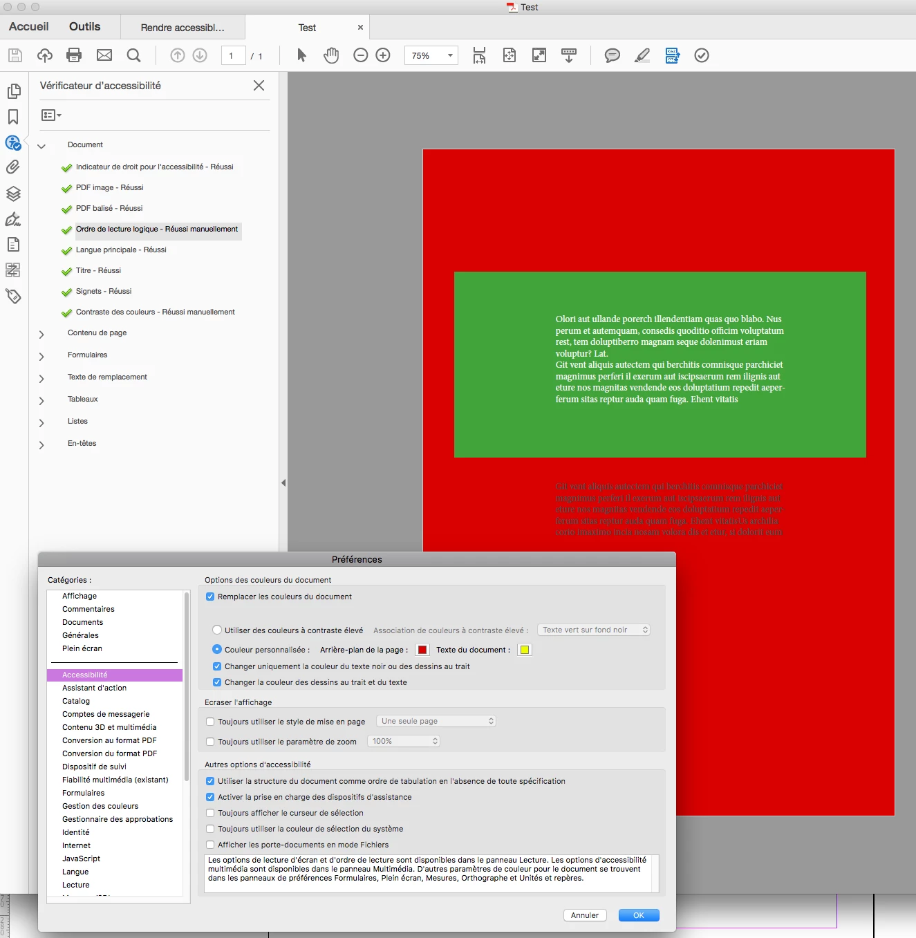

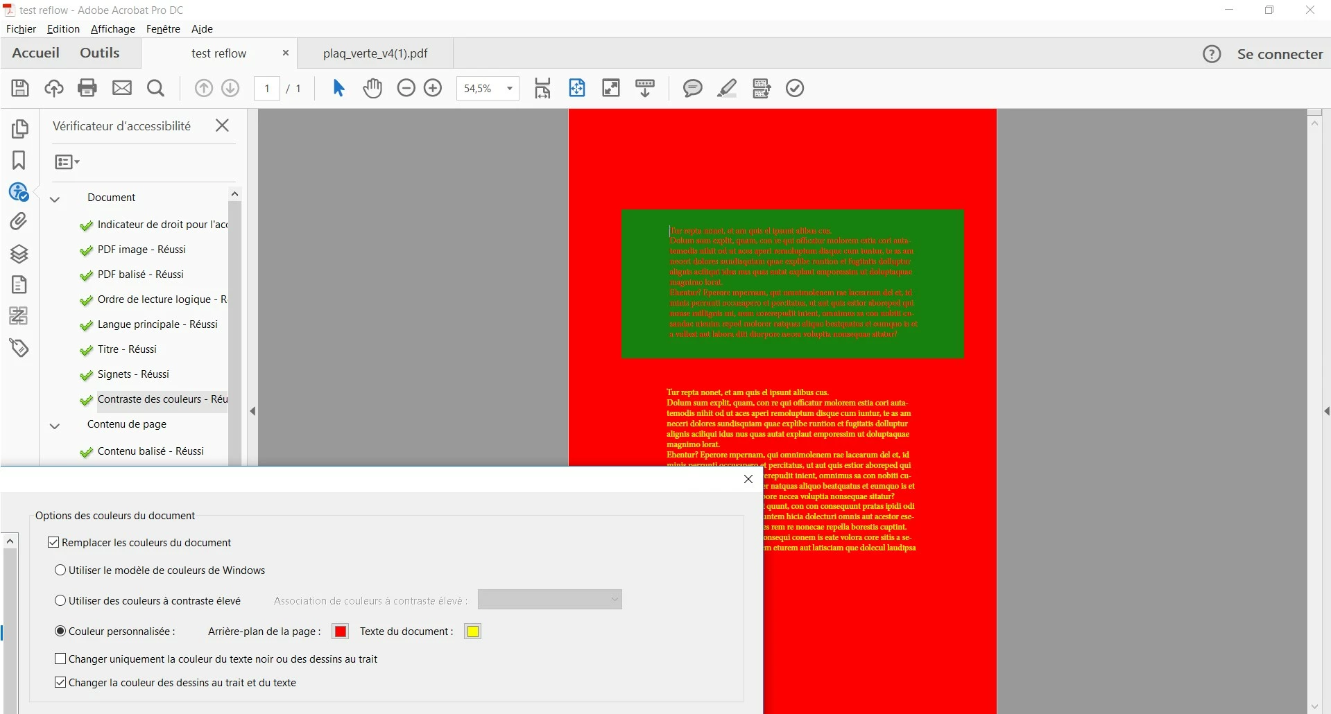

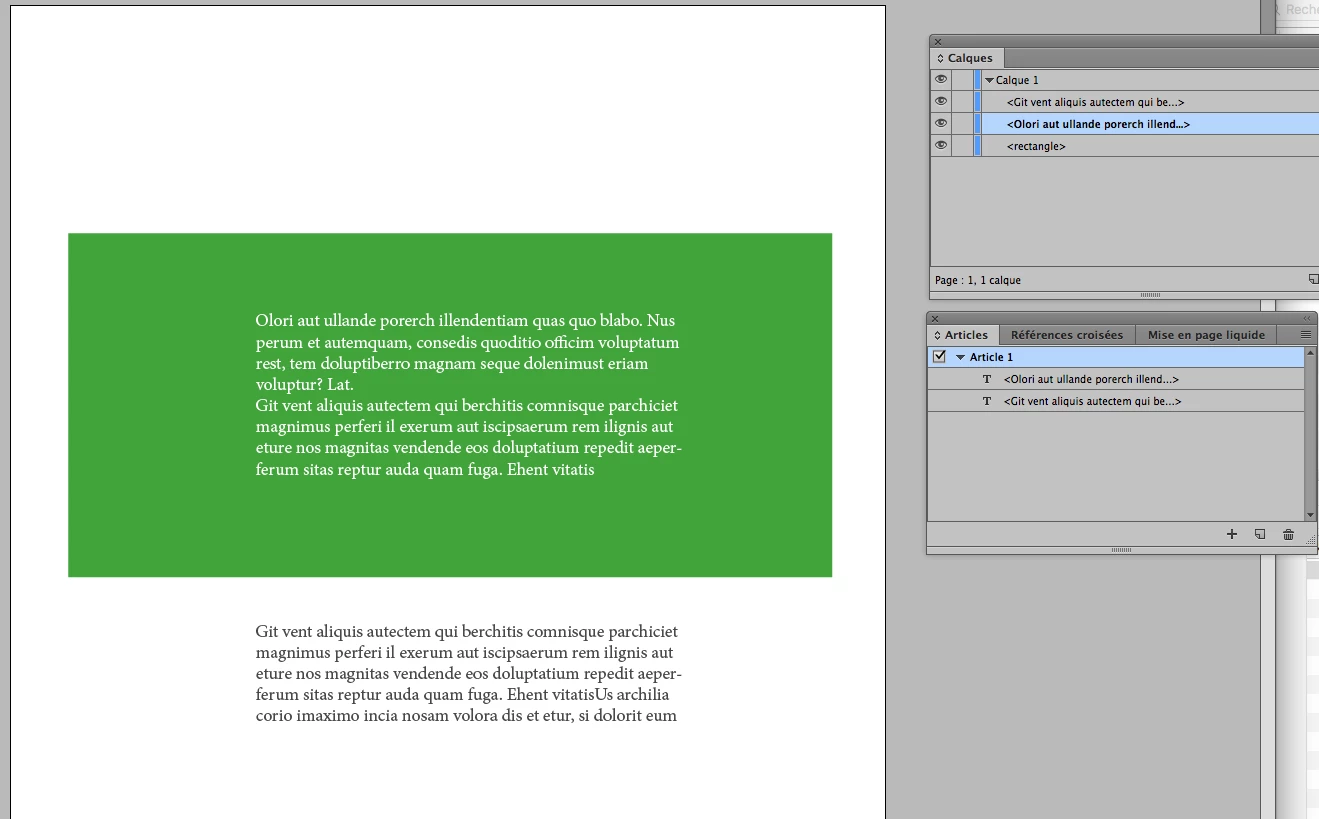

i'm using Indesign CC and acrobat  pro dc to create tagged pdf and i meet a  lot of difficulties with the reflow of my documents.
i just give you an exemple where the color doesn't change. But i could give you many examples of bad reflow despite a good construction of my document for tagged pdf (i think).
1) here is an example of an  indesign doc ready to be tagged
2 )Here is the acrobat version with accessibility options checked. The colors do not match correctly (text should be yellow).
3) and the reflowed version. The color of the text is not the selected one (text should be yellow):
And i could make a lot of exemple with bad reflows.
Do you have a solution for this exemple or do you have a guideline in order to have a good reflow via indesign?
Thank you for your help

    I’m a bit confused when you say the text isn’t yellow. It appears to be yellow in your screen shots. The exported PDF should look the same as the InDesign file and if it doesn’t then we need to look at the InDesign file or the export settings.
    Regarding the reflow... The Reflow function in Acrobat is a testing tool to check the general behavior of reflowing text. Low vision users are not likely to use Acrobat for this purpose and will likely use some other tool. So I wouldn’t focus too hard on the appearance. I typically use reflow to test the order that objects are in when they reflow.
    November 22, 2017
    Hello CHad,
    the text on the green background is red? shouldn't it be yellow.
    Maybe i have some gaps in accessibility and misunderstood something.
    Ok for the reflow, i thought it was for low vision user. Do you have a ressource which explains how they use their tools? and which tool they use?
    Do you think that that tagged pdf is useful for low visual user? or do they only need a "normal pdf"?

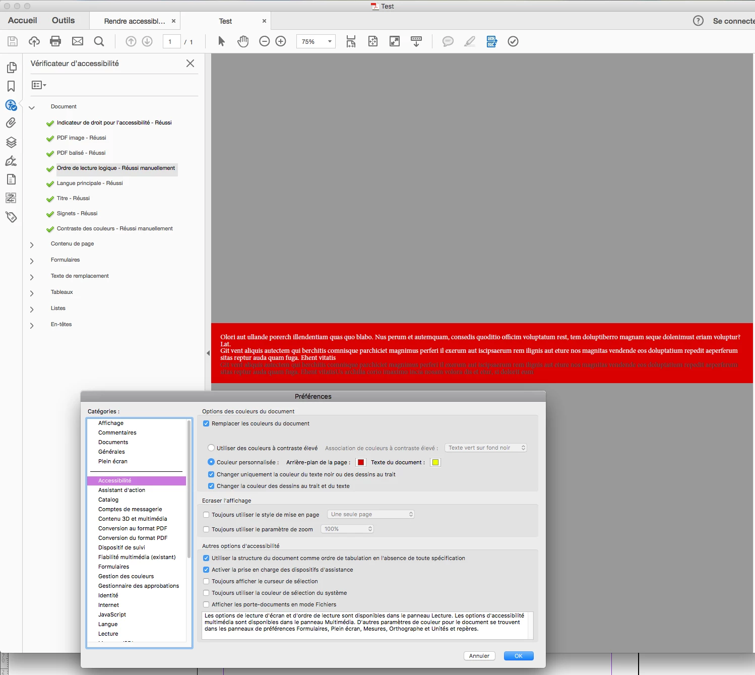

    hello,
    i restarted and tried on mac and pc. it doesn't change

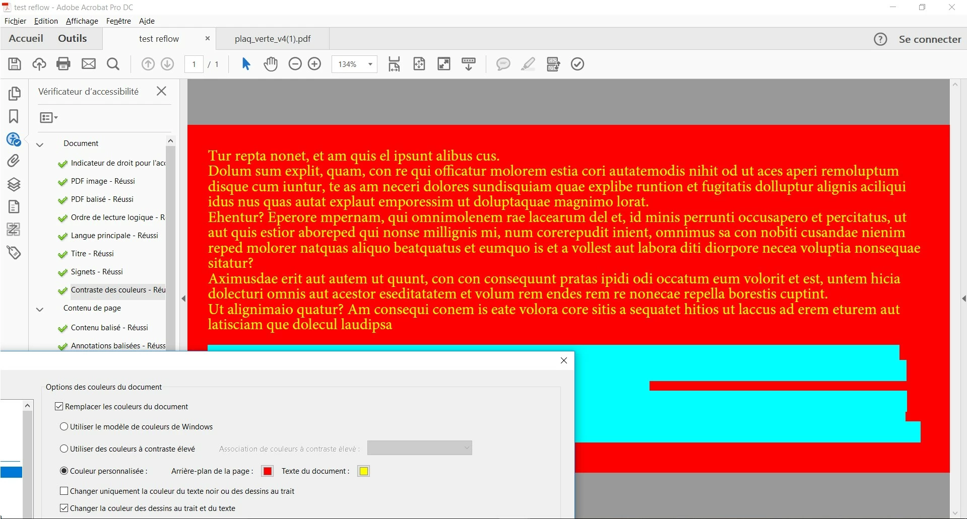

    Hi Michael,
    thank you for your answer.
    I unchecked "Only change the color of black text or line art." but it still reflows badly
    Here is the version without reflow (background still not red and text not yellow)
    And here is the reflowed version and the bottom text disapear...( highlight)
    I didn't find an adapted solution for the moment
