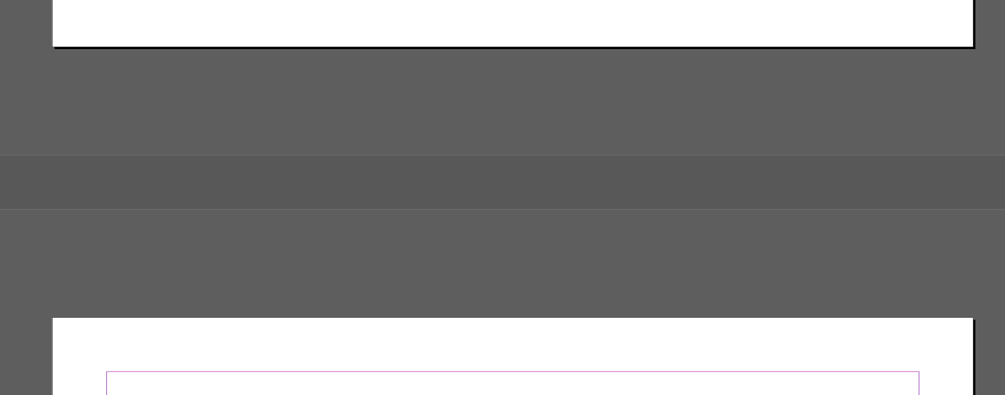

Feb 16, 2025 9:18 PM UTC
There has to be a setting for vertical space between pages (gray area seen as you scroll). The smaller space is my default setting, and the second (much larger) is a file set up by someone else. I would also like to know how to reduce the space.

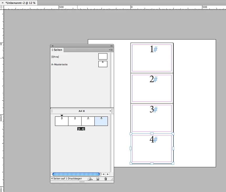

Feb 26, 2018 5:53 PM UTC
under specific circumstances one page can touch the other one the way you want it.
1. You need a non-facing pages document.
2. One single spread with a maximum of 10 pages. My screenshot is showing one spread with 4 pages:

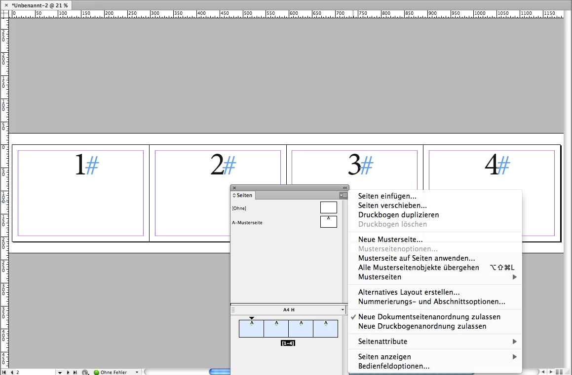

To make that happen I turned off "Allow Page Shuffle" for the first spread of the document and added pages to the spread or moved pages from other spreads to the first one in the document:

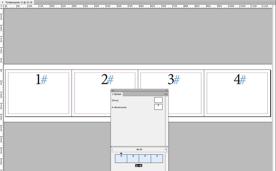

3. Then I re-arranged pages with the Page Tool and moved page 2 below page 1, page 3 below page 2 and so on:
