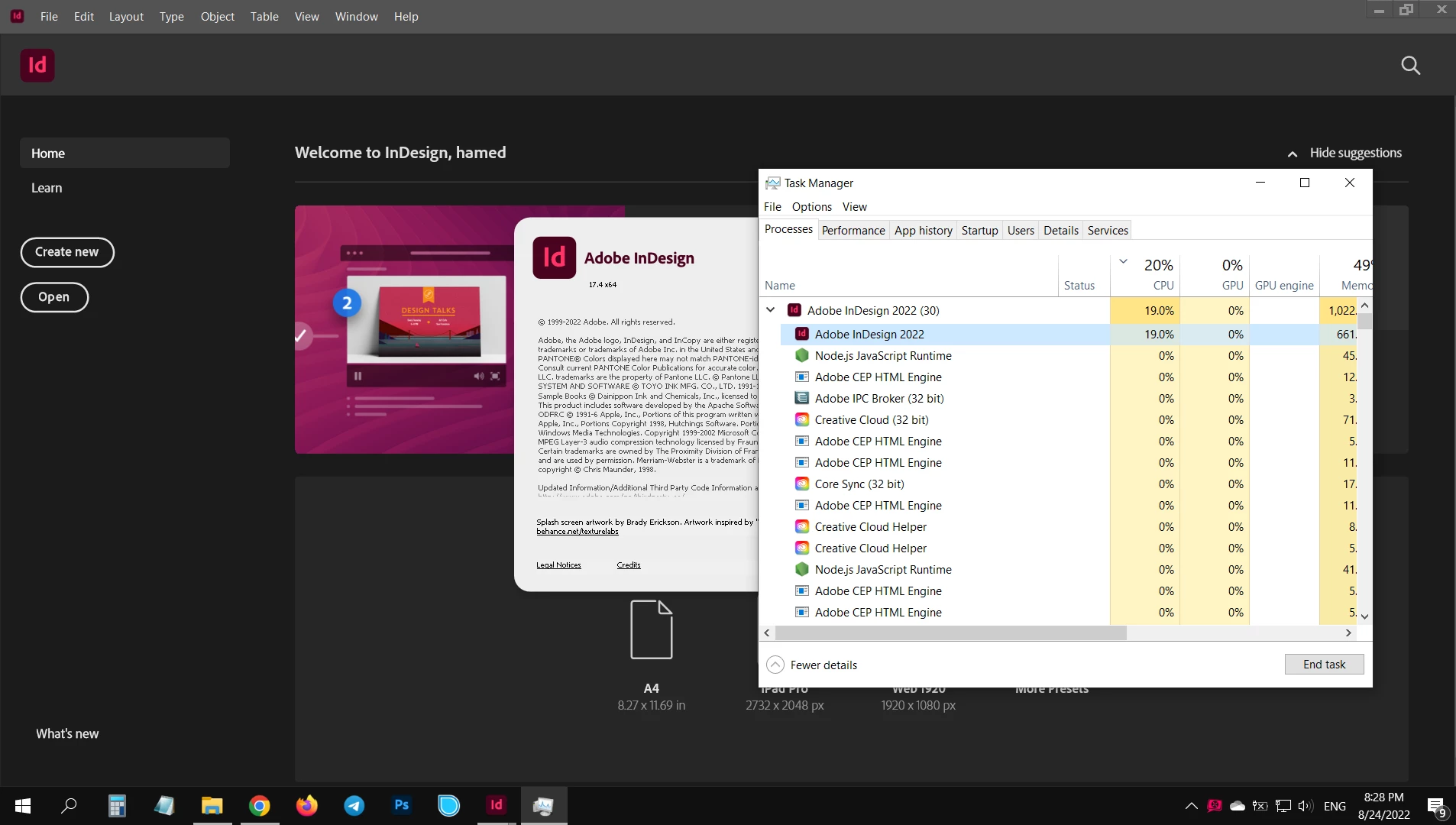

August 24, 2022
Hi, Thanks for reply.
It's not about CEPHtmlEngine , It's something inside indesign . this bug make me crazy and introduce from indesign 2022 and not fixed . it exist in 17.0 , 17.1 , 17.2 , 17.3 and 17.4 . nobody cares about this bug , I tested on 3 computers all the same. nobody cares ! I got hopeless
