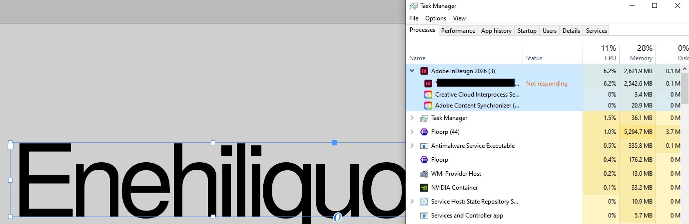

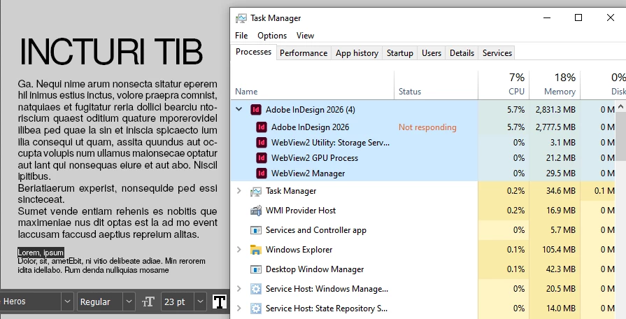

1. Merely invoking (trough the Window > Type & Tables > Paragraph), opening or selecting the Paragraph panel freezes the program (in the Task Manager it immediately appears as not responding by doing so). The resulting state lasts for various seconds or even a minute, making the program practically unusable, to the point of even closing the file taking roughly a minute, and closing the program requiring me to end the task with the Task Manager. Also, the program (and this program alone) got slow overall.

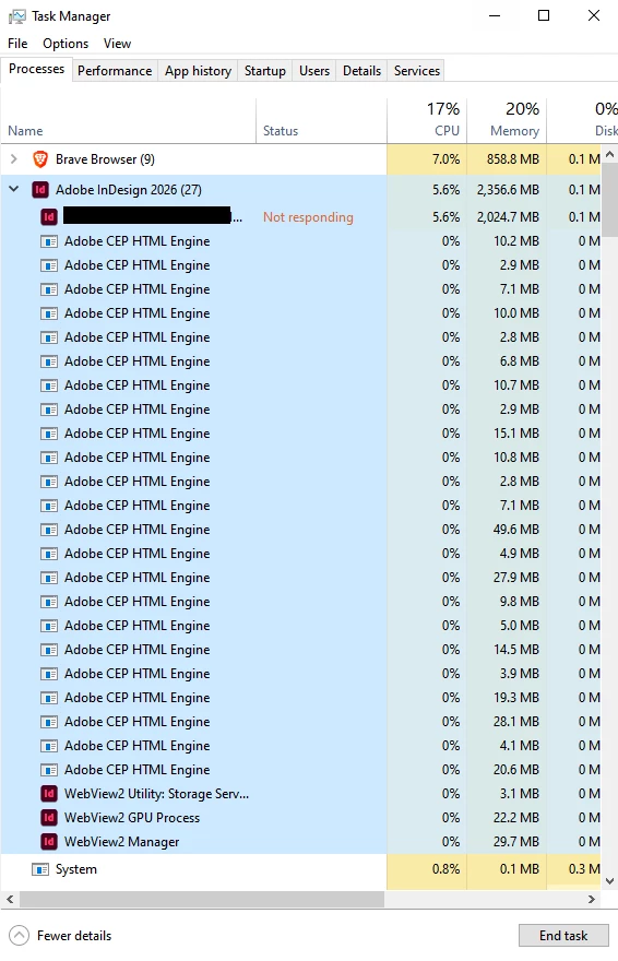

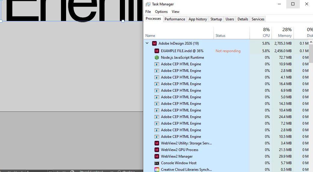

2. There appears to be an issue with the CEP HTML Engine that does not occur with every file, and sometimes it doesn't manifest even with the files that are possibly corrupted (se point 3): certain files cause a significant spike of multiple instances (sometimes even up to 23) of it being opened, whereas others did not cause this thing to appear in the task manager at all (though this happened only once). But in both cases, the program stops responding, even by simply opening them and doing nothing.

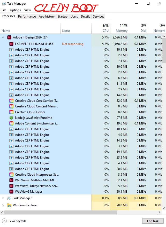

    Files B and C had the same issue as the opening post: the program ended up not responding, with multiple instances of Adobe CEP HTML Engine opened (around 7), and Creative Cloud Core Service and Creative Cloud Helper active. Merely opening the Paragraph tab or even trying to select objects froze InDesign.
    CLEAN BOOT
    Windows+R > msconfig > Services tab: Hide all Microsoft services > Disable all (non-Microsoft services); & Startup tab > Open Task Manager > Disable all startup items.
    The files still leave the program Not responding, with a total of 17 intances of the CEP HTML Engine (see attached screencap).
