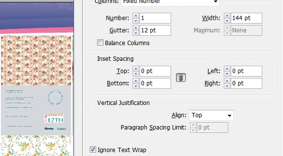

I don't want to assume that everyone has made the jump to CC but, if you have and this is still an issue, I've just gotten the upper-layer text object to flow over an object with a wrap applied to it.
  • Object
  • Text Frame Options
  • In the menu box, lower left ...Select, "Ignore Text Wrap"

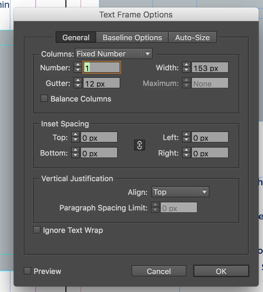

While I doubt anyone who has visited this thread will come back to see my revelation here, I have good news for anyone who comes here looking for an answer in the future.  Ironically, the very first person who answered this question at the top was correct.  But because he used the wrong terminology in his explanation, his answer was dismissed early on.  Too bad!
If you look more closely at his screen capture, you will get all the info you need to make sure a text wrap affects one text box, but not another AND even while on the same layer.
All you need to do is select any text box you don't want wrapping, go to its Text Frame Options dialogue box, and down at the bottom of the General tab select "Ignore Text Wrap."
I hope that helps.  :-)

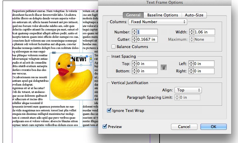

You can't select a layer and have it not affected by text wrap.
But you can select the object above the wrap, and in Text Wrap Options, check Ignore Text Wrap.
