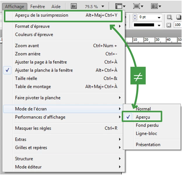

January 30, 2017
Hi
Overprint preview is different from Preview mode (W).
Which one are you talking about?
If you mean Preview mode, it looks like a memory issue (but I don't know much about hardware troubles).
