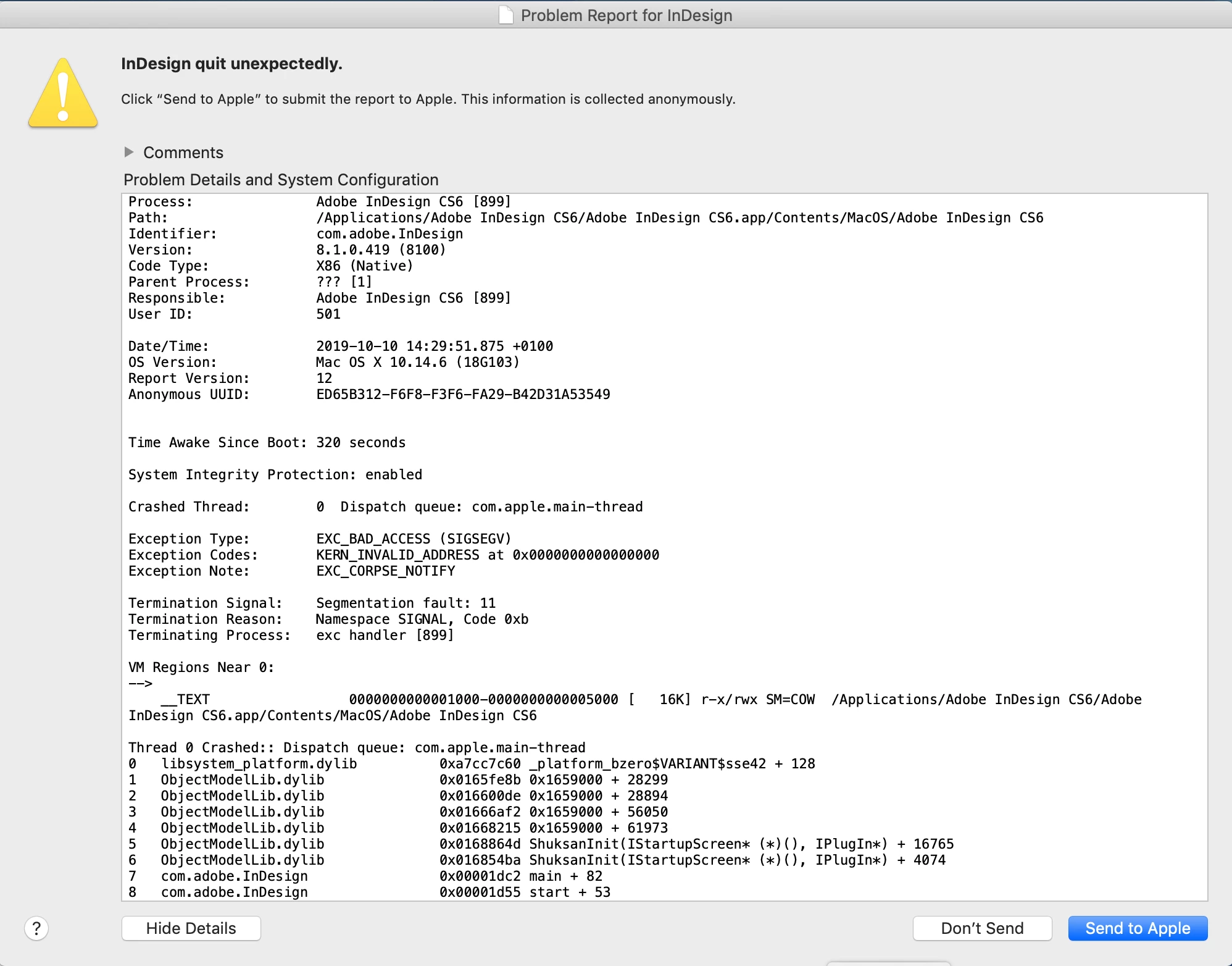

So I’ve downgraded from Catalina to Mojave (10.14.6). I then ran restore from the latest Time Machine backup. Everything restored as it should and both CS6 Photoshop and Illustrator open and run perfectly. However, InDesign is not. It is displaying the following messages in the start-up screen before it crashes - (attached a screenshot of the first part of the Apple problem report) -
  1. Registering 238 plug-ins
  2. Completing Object Mode
Many thanks. Any support would be greatly appreciated.

    You'll need to install JnDesign CS6 using its installer. Restoring from a Time Machine backup often doesn't work because it doesn't properly handle the way Adobe stores its app files (spread in many locations).
    So uninstall everything you can. I would use the CC Clearner (which is supposed to remove CS 6 apps). But you may need to contact Adobe Customer Support to get access to the CS6 installer. You should be eligible to get access to it if you purchased CS6.

    Thank you Steve. I purchased CS6 and although I accept its an old version, it had been running perfectly in Mojave up until the need to downgrade from Catalina. I’ve since downloaded the .dmg folder from my Adobe purchase history and wil try that once I’ve run CC Cleaner.
