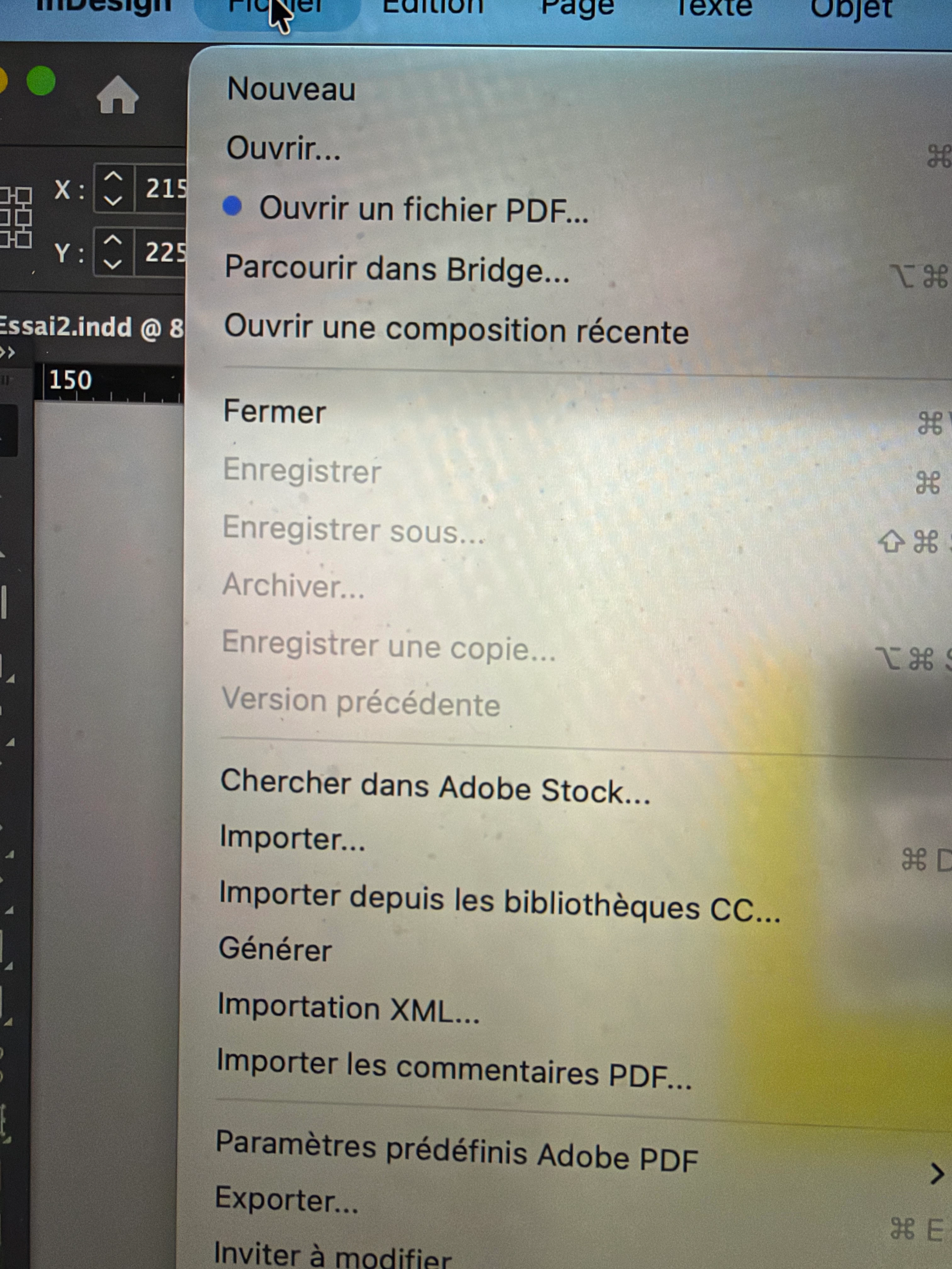

I am a professional graphic designer and I use Adobe InDesign all day, every day, for client work.
Immediately after installing the macOS 27 Golden Gate Public Beta, InDesign became almost unusable.
The problem is intermittent. InDesign can work normally for a while, then suddenly freeze. It seems to happen most often when I am editing text or changing fonts, although I cannot reproduce it consistently.
When this happens:
  • Save becomes disabled (greyed out).
  • Save As becomes disabled.
  • Close becomes disabled.
  • I cannot save my work.
  • I cannot close the document.
  • The only solution is to Force Quit InDesign, which causes me to lose hours of work.
This happens with multiple InDesign documents, not just one file.
I have already:
  • Updated InDesign to the latest version.
  • Tested a previous version of InDesign.
  • Restarted my Mac many times.
The issue started immediately after installing the macOS 27 Golden Gate Public Beta.
Has anyone else experienced this issue?
Can Adobe confirm whether this is a known compatibility issue with the macOS 27 Golden Gate Public Beta?
If needed, I can provide screenshots, crash logs, screen recordings, or any additional information that may help reproduce and investigate the issue.
This issue is currently preventing me from working professionally, so any guidance or workaround would be greatly appreciated.

    Jul 27, 2026 3:00 AM UTC
    This has also impacted me.
    A workaround to not lose your work:
    • Save & Close issue happens
    • With the existing INDD file still open, Create a new document in the same size, just one page
    • Go back to the document which won’t save or close
    • Use the Pages panel to select all pages of your existing document
    • Right click and Move Pages
    • Move the pages to the new document you’ve created. Save the new document.
    As a workaround I’ve effectively got two of the same document running side by side, switching to the other when one has this issue.
    Jul 27, 2026 1:42 PM UTC
    Yeah, I’ve done something similar – I created a blank “workspace” page and copy the document into the blank page, close the original document then reopen and paste the work back into the original. It seems to get the job done.
