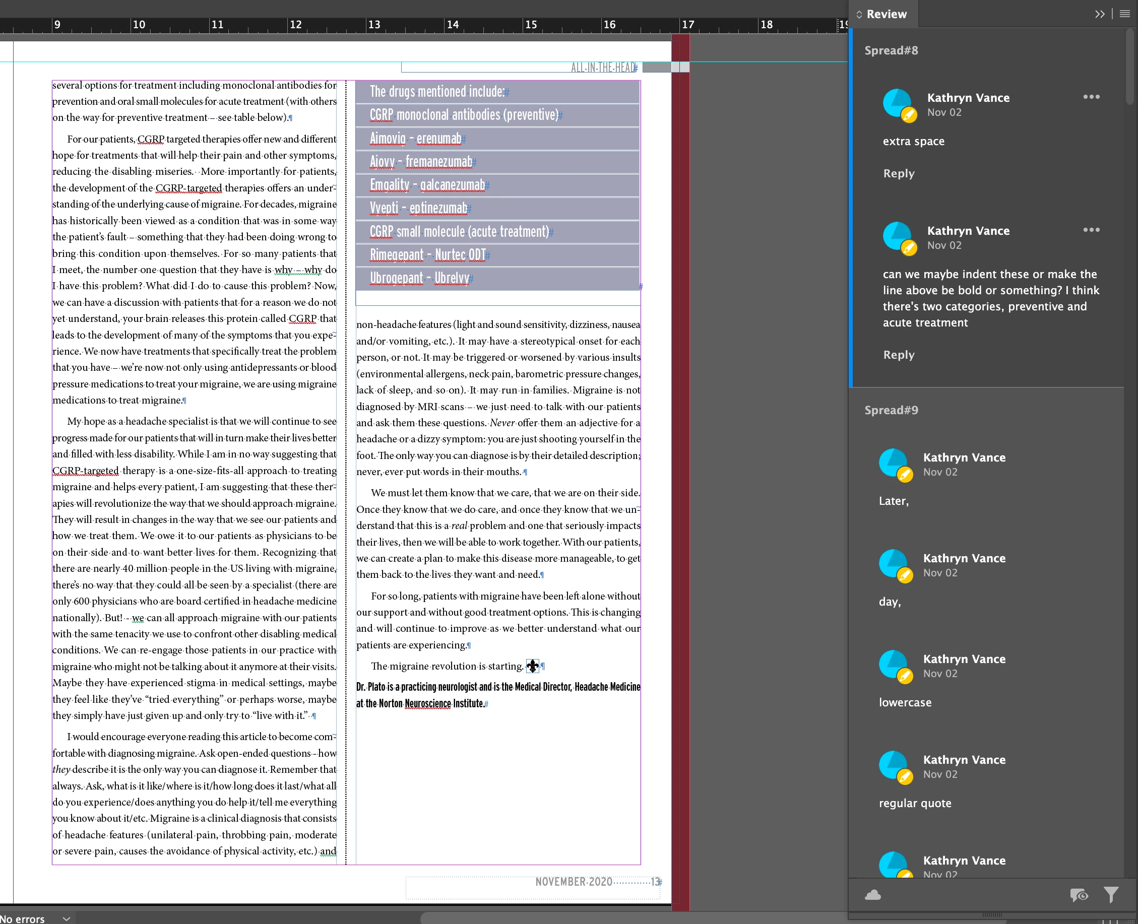

My team has reviewed the document and the comments are showing in review but none of their highlights or pins are showing. I've signed in and out, restarted my computer, etc and it has made no difference. It isn't showing on their end either when they open the review link. It's like they disappeared. Below is a screenshot.

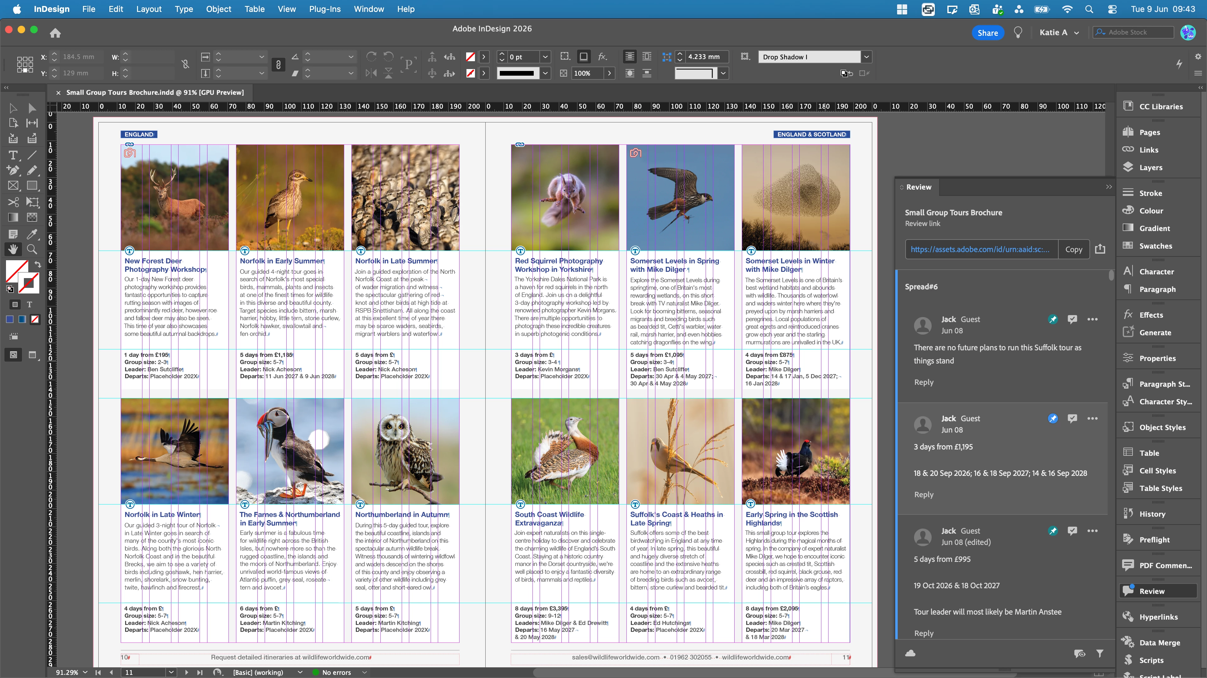

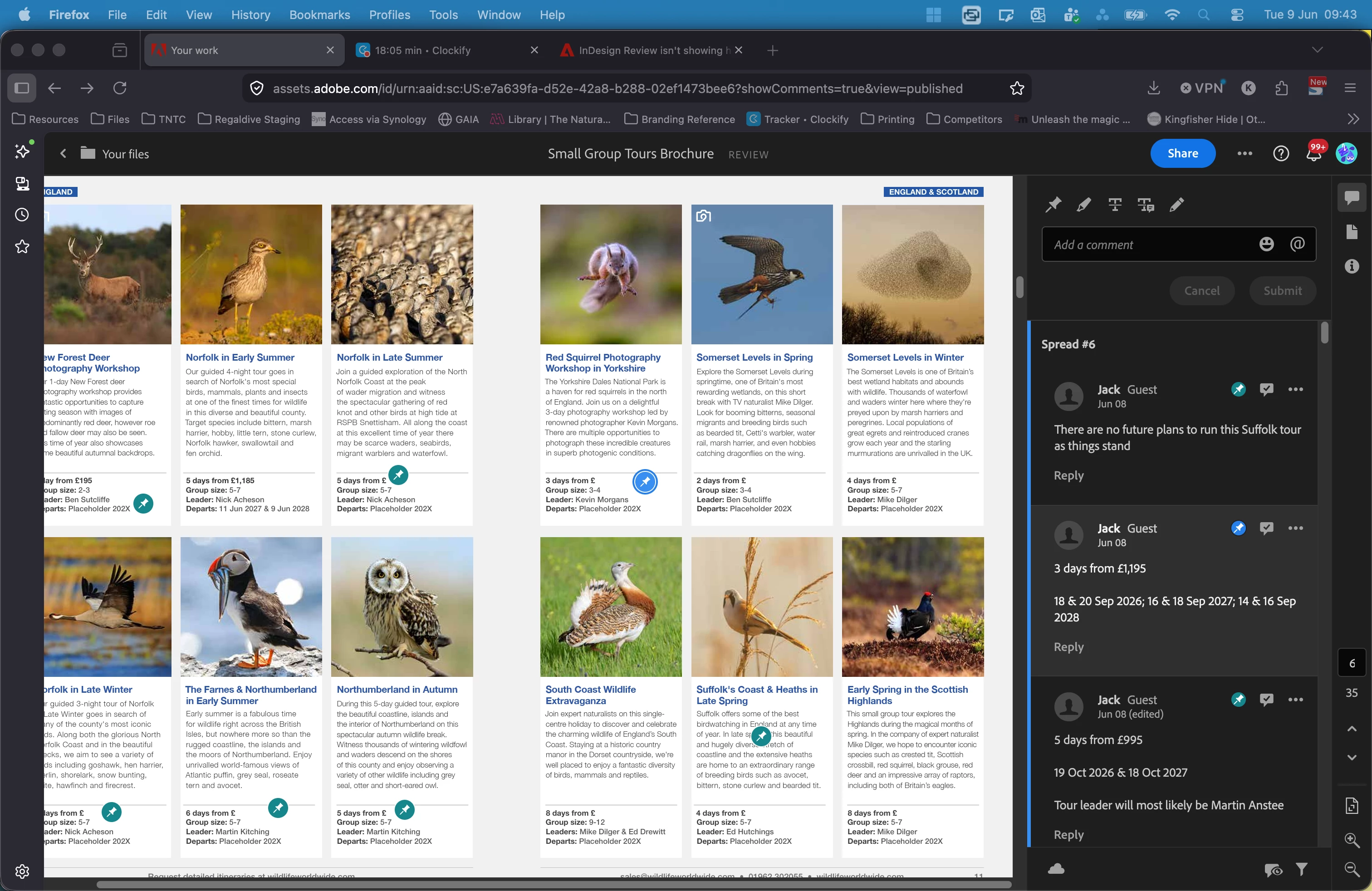

Having same issue as well.
June 9, 2026
I’m having this same issue, as have had it on other documents as well – everything was working normally, then suddenly I could no longer see the pins within InDesign despite the comments still being there, and the pins being visible on the web link.

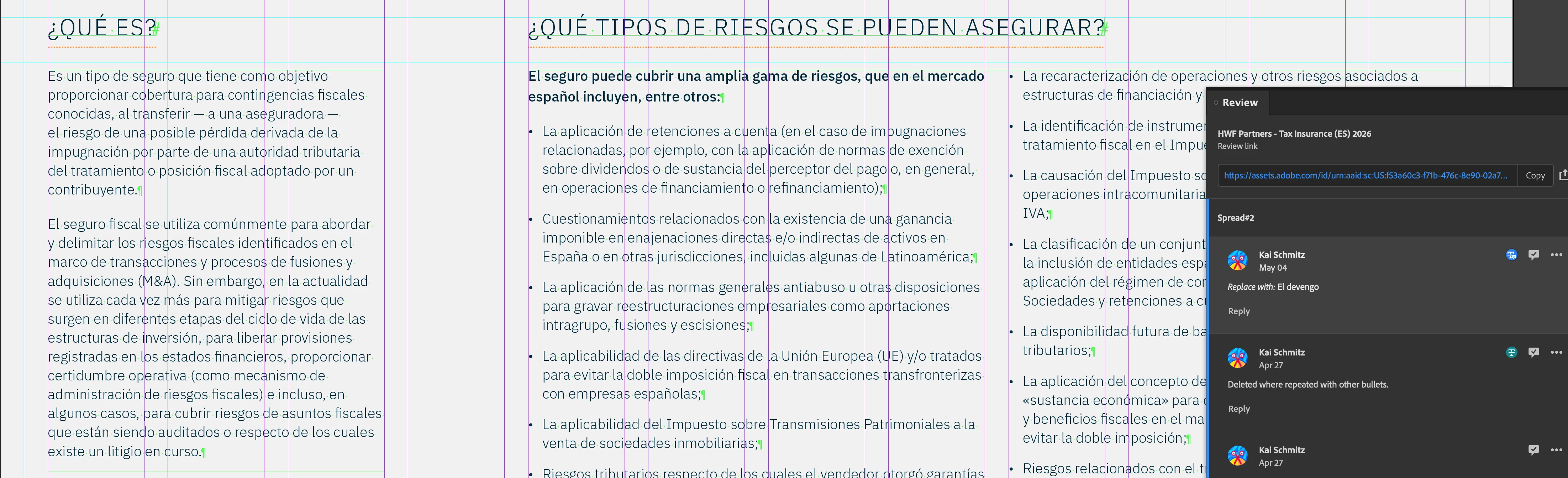

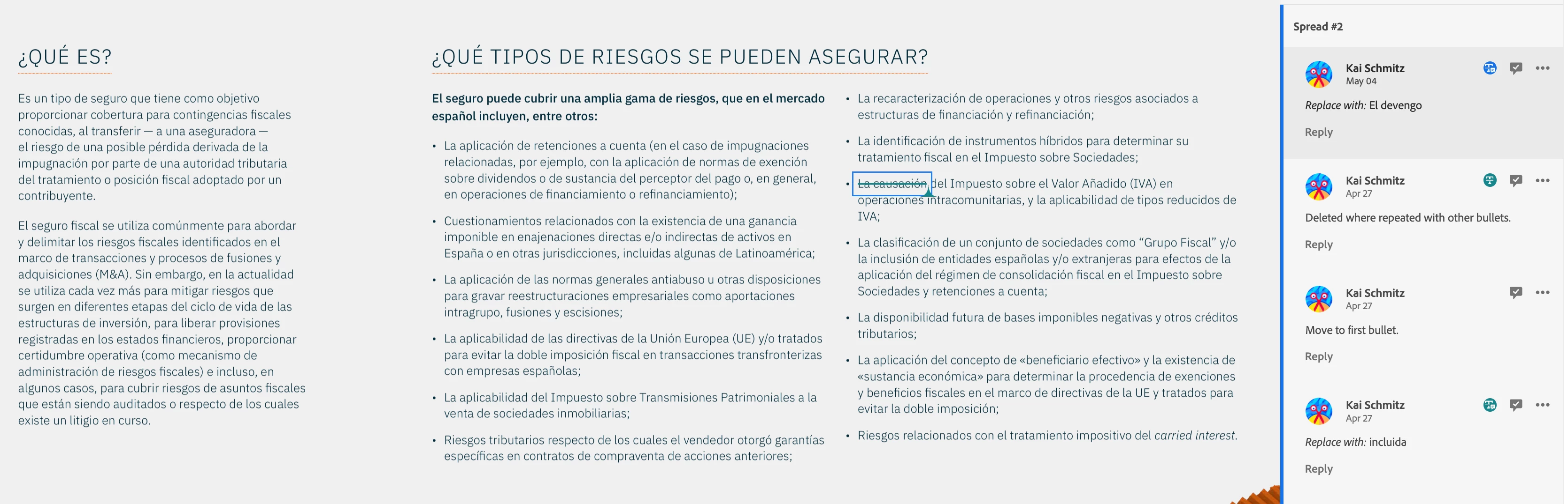

May 13, 2026
I consistently have this problem inside InDesign. Comments have been added correctly by the client - I can see the placement and type (strikthrough etc) on the browser link, the comments pull through to the panel inside InDesign, but the pins etc do not show on the document.
Latest version of Indesign, Chrome is up-to-date, no VPN, ad blockers or anything. Nothing to do with filters showing/not shoing resolved or unresolved, preview mode, unmapped etc like common issues say.
Thius functionality has been broken nlike this for me and is hugely frustrating
