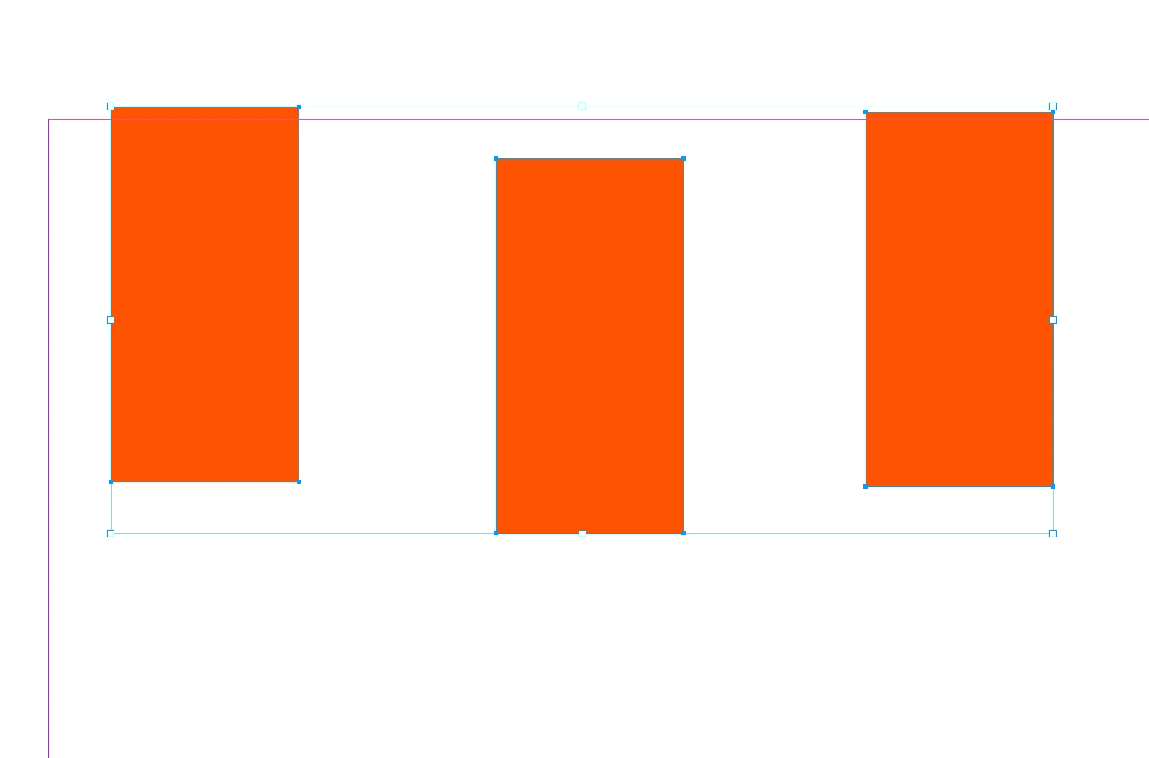

There is a script below which changes the value of the width and height of many objects at the same time.
Two issues with it
One: I want a user to be able to leave a field blank and the script then uses the left out field as the value for the object size. Importantly, this could run into issues if there are many selected items which each have differerent sizes.... so maybe this i a concept that is impractical?

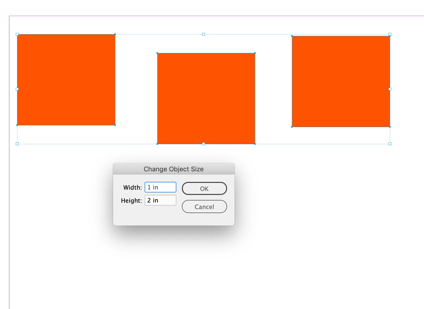

Two: This is a comment issue I run into, dialogue boxes in ID usally display the unit that document is set up in, best seen in the screenshots below
However in this script below, there is a horrible pt
The pt is not important - this is becuase no matter what the user has their document unit preferance set in the input value becomes the size of whatever thing they want to resize - thus the pt is not important
How can I either remove the pt or have the pt change to show the unit which the document is set. importantly the in the latter as ID converts inputs to points, also dont want a sitution where 40mm becomes xxxxxpt as it converts it..... perhaps I have this issue wrong

Hi @SmythWharf , I think this is the same question you asked here:
https://community.adobe.com/t5/indesign-discussions/script-ui-issue-script-allows-change-of-w-amp-h-of-many-selected-things-at-once/m-p/14294902#M554397
The part that is still missing from your code is setting the scripting preferences measurement unit to points at the top of the script and resetting at the end outside of the loop. You have to do that because a measurementEditbox always converts the returned values to points, so this works:
