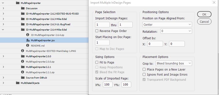

The next step would be to place the pages in reverse order with the help of the MultiPageImporter script.
You can determine the start page, you could check "Reverse Page Order", you could place InDesign pages or PDF pages:
Originally written by Scott Zanelli, now curated by Mike Edel:
https://github.com/mike-edel/ID-MultiPageImporter/releases

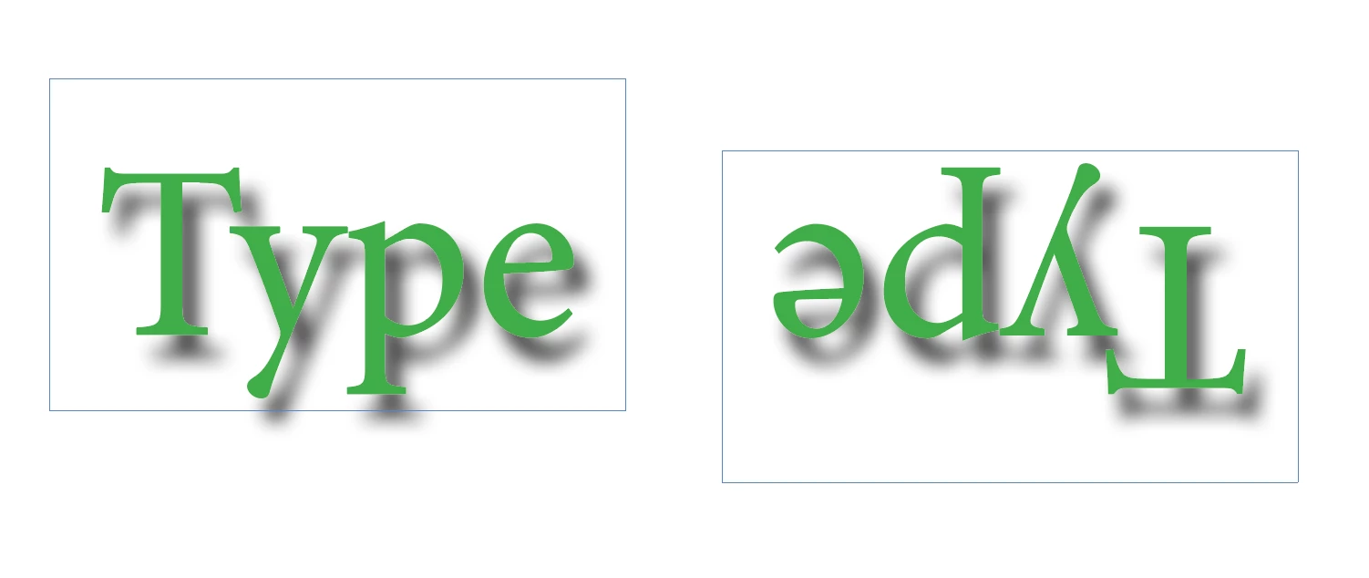

Luke Jennings3
July 19, 2022
It's worth noting that effects, like drop shadows, won't respect the object rotation, it will work when the page is rotated, without moving the page contents, as Uwe suggests, or when a separate InDesign file is placed and rotated.

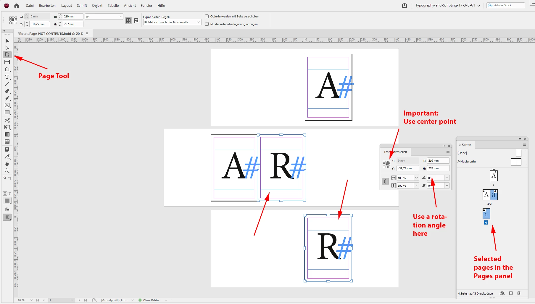

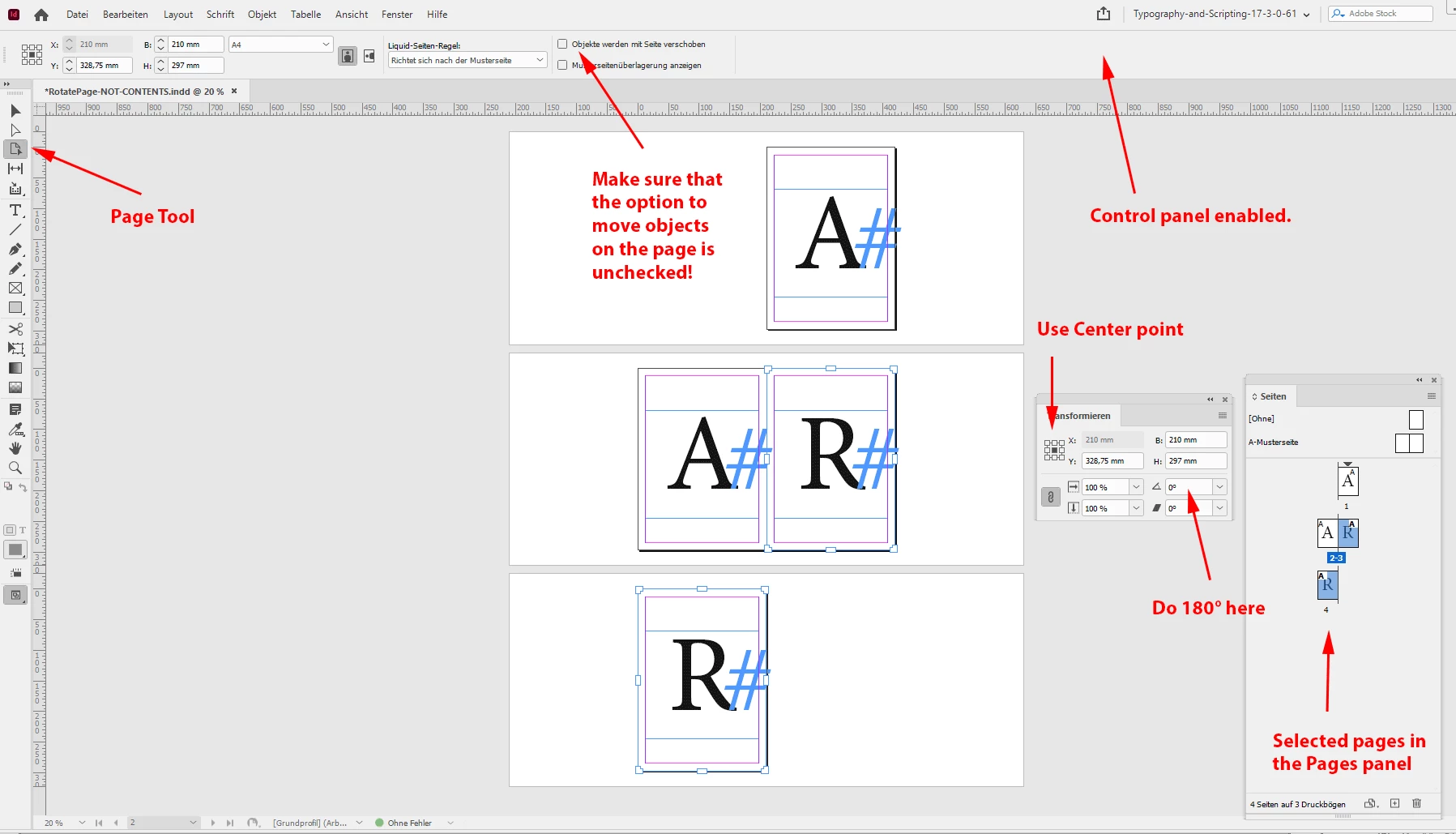

Hi @therealbrooklynpirate ,
you rotated the page view only with that option.
Simply use the Page tool plus the Transform panel and rotate the pages without their contents.
Select more than one page with Page tool:
[1] Start out with the Selection tool.
[2] Select all pages you want to rotate in the Pages panel
[3] Switch to the Page tool. Now all pages you had selected in the Pages panel are selected.
From my German InDesign on Windows 10 where you see the Control panel, the Pages panel and the Transform panel. The active tool is the Pages tool.
Go to the Transform panel and rotate the selected pages by 180°. Rotate around its center point.
Make sure you have the option unchecked that the contents should "move" along.
You find that option in the Control panel. See screenshot above.
Result after the transformation for the selected pages:
Export to PDF and your contents on the rotated pages is indeed rotated on the PDF pages.
