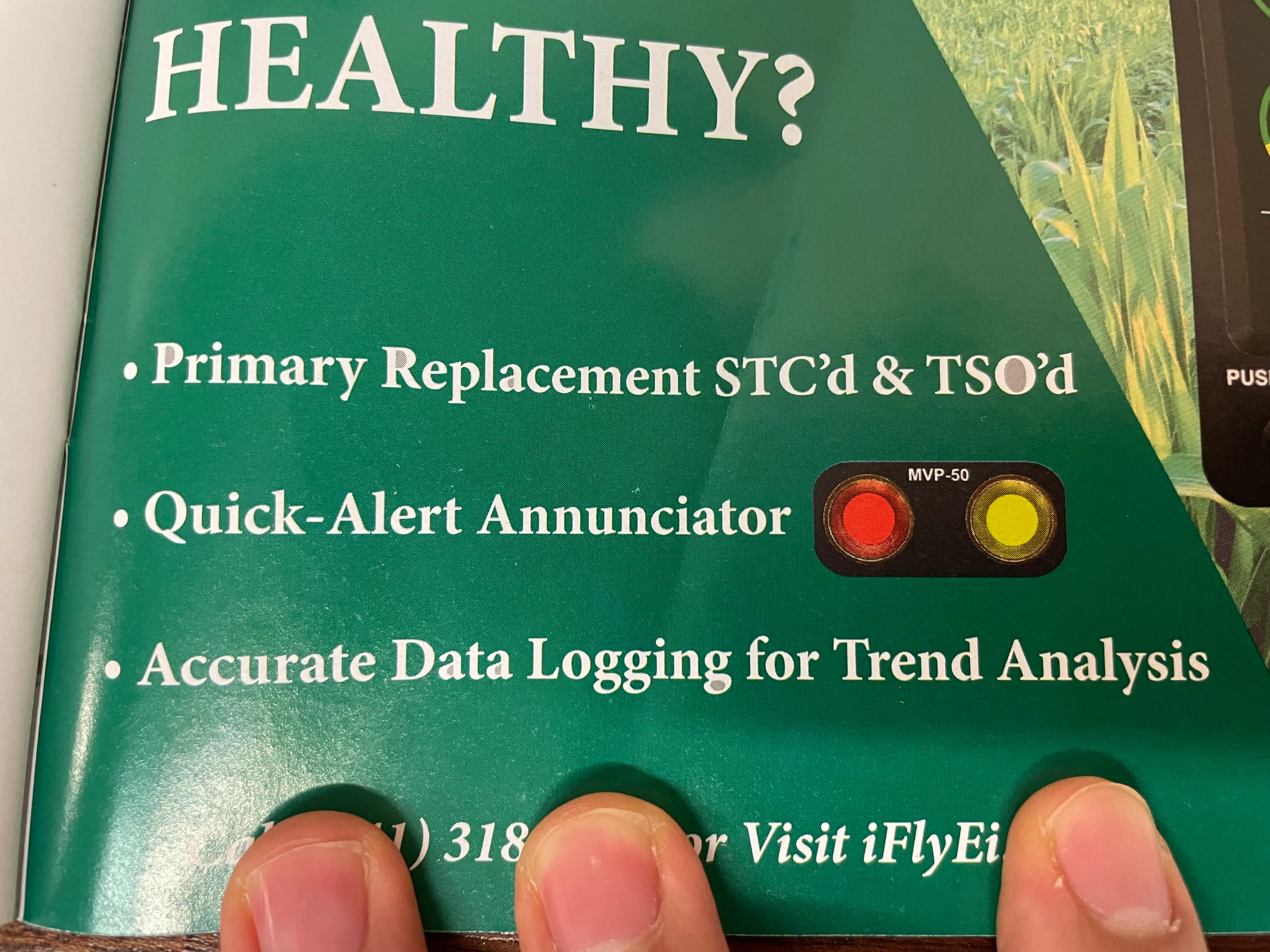

I have come across this issue twice now. A client will send me an ad (pdf) created with inDesign. The copy has an outline turned on, the line size is set to 0, therefore invisable. When this happens you cannot see it on the pdf, but when it is sent to be printed the insides of the letters are filled in, but usually only on fonts that are less than 14 point. Not sure how I found this, a fluke for sure. Once the outline is removed the problem goes away. Just thought I would share.

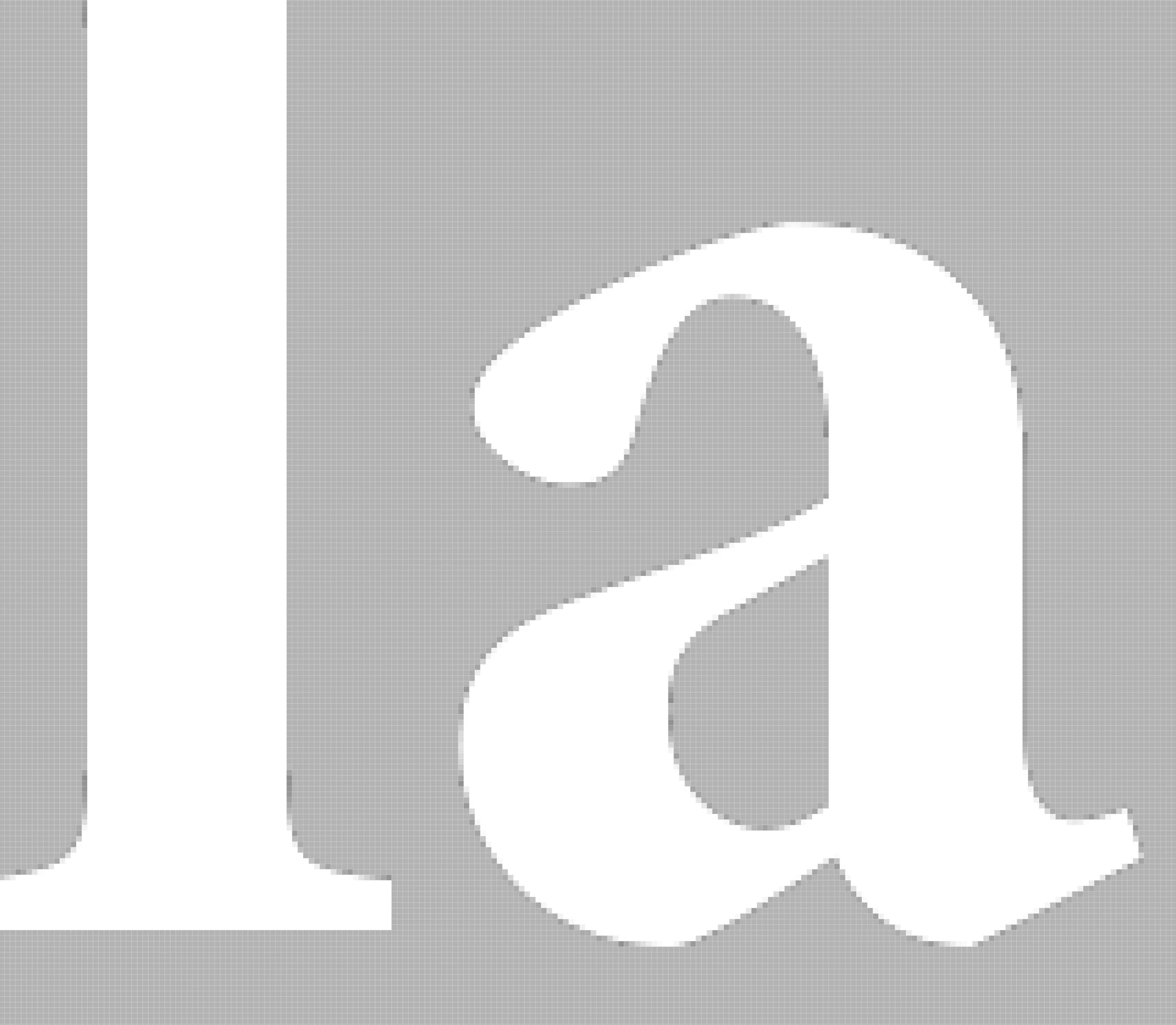

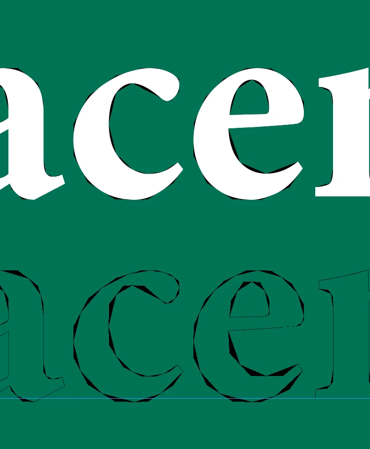

Background: Even with a "0" width, a stroke will always render at least 1 pixel. e.g., I rendered it in PS at 1200 ppi and the attached is the result. You can also see this on the screen in your ID file: If you make the fill "None" but leave the stroke, then zoom in, you will see a 1-pixel line no matter what size. (If you want some real fun, turn on GPU on a Mac! see second attachment!
It still might be worth submitting this as a bug, as InDesign should just probably say No if a 0 width stroke is applied. 🙂

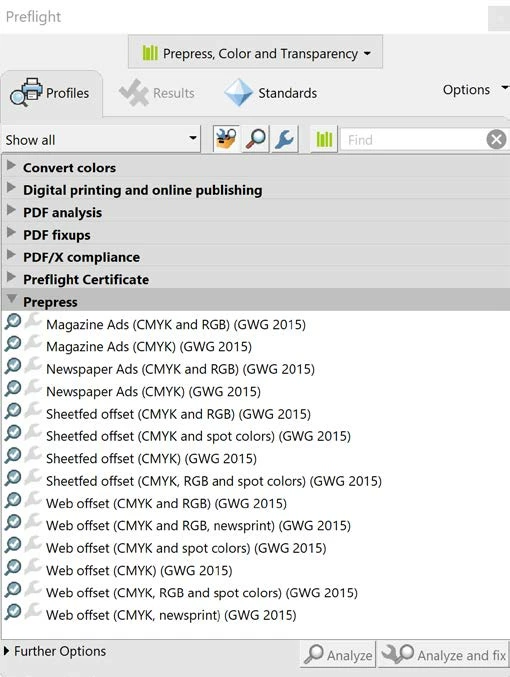

It does seem the printer has some setting that is creating the problem. Having a stroke should not give the effect you are seeing. If you are recieving PDFs to place it is good practice to preflight PDF files before placing them in InDesign. Gwg.org have preflight profile for magazine adds (from 2015) that are in AcrobatPro. You can create a hotfolder or droplet to preflight adds. using these.

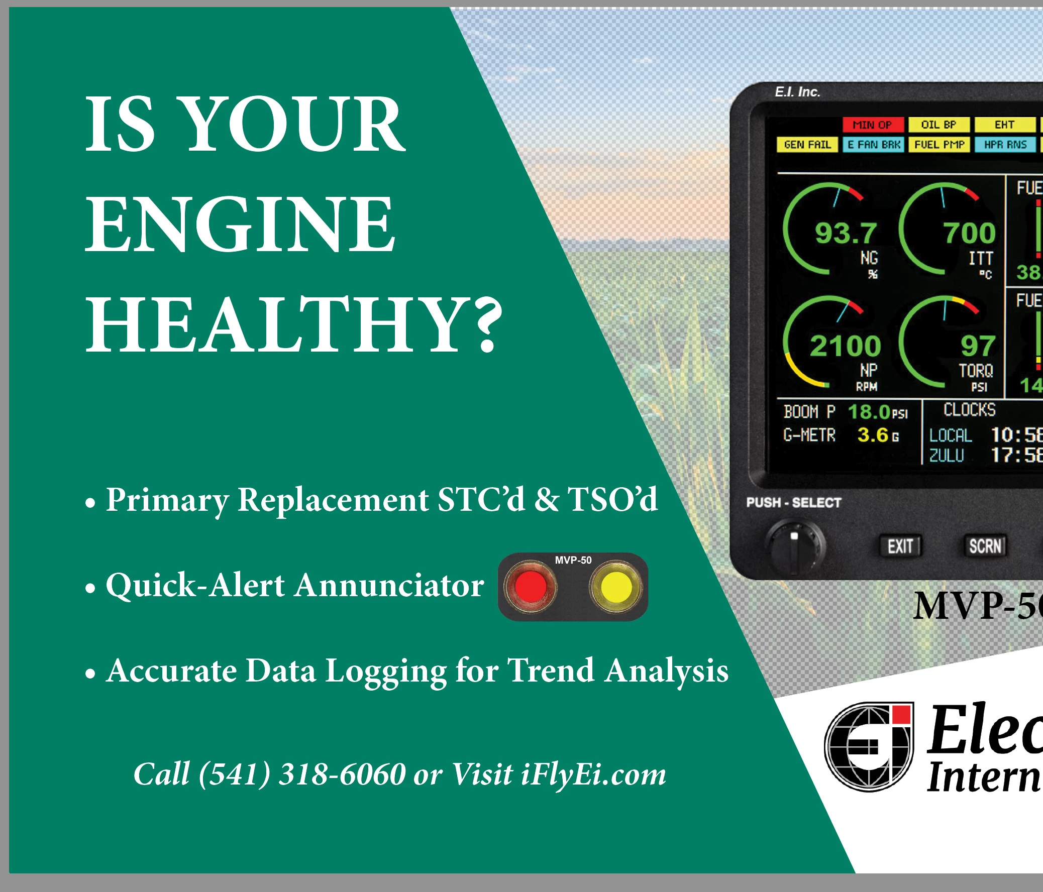

Sure here is the pdf supplied by the client.

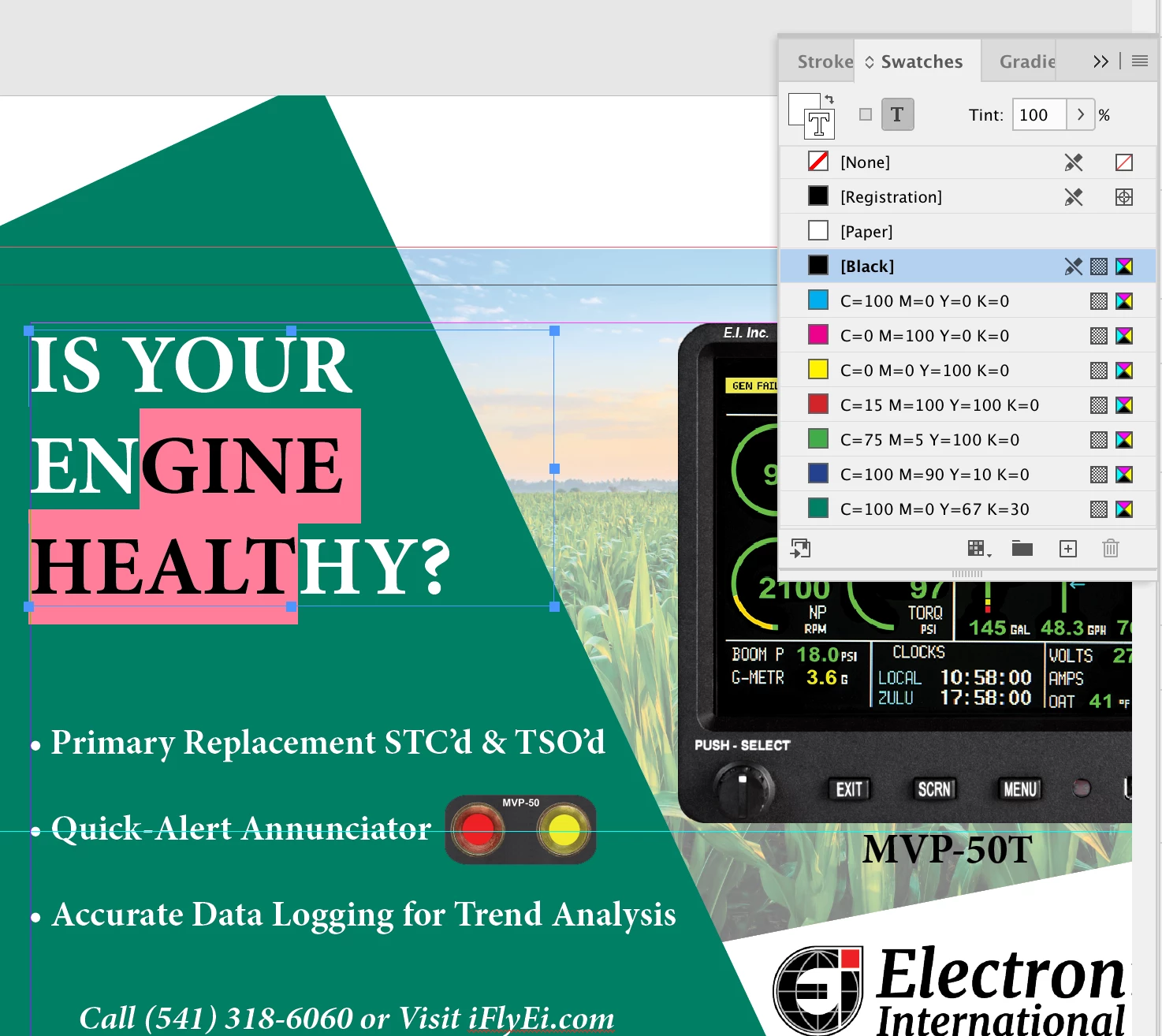

 Sure the first one is what the client sent to me, notice the insides of the letters are filled in.
The second is a snapshot of the Swatches panel noting the outline.

Your screenshot has the headline copy selected and shows that it has a stroke applied. However, the headline does not appear to have any problem with filled in letters. It is the body copy that has that problem. Can you show the color specs and any other possible information about the copy that actually has the problem?
